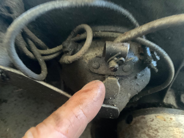

Good morning Forum Chums!
The next newbie question of what I’m sure will be many!… This is my first foray into the The model T world, and I’m already loving it! My mechanical experience is relegated to the restoration of old 30s and 40s Ford tractors….So… There’s going to be a learning curve while I try to learn the subtleties of the model T’s electrical system, because obviously it’s not linear to my experience…. Being completely candid, some of the information in some of the Ford manuals is scant at best with no real usable pictures, certainly not like all of the detailed IT shop manuals for tractors etc.
I would value anyone’s insight on a good place to go to find detailed information with good pictures and or video regarding engine timing, and timer maintenance….I am afraid to even touch it at this point…lol….As I alluded to, this is going to be the first of many questions…. What lubricant should I use in the timer? I think I have found the place where it is to be added, pictures to follow….many thanks in advance!

Lube with engine oil. Take timer off and wipe out the gunk from time to time, now would be good looking at the picture.

Welcome to the Model T world! If you have worked on the Fordson tractors, old equipment and so on you can certainly work on and be competent working on and your Model T! It ain’t rocket science!
Sure you need some ideas on what to do and others will give guidance in the different aspects of a T.
As far as your Timer lubrication is concerned you have a roller style timer that needs a light grade oil and cleaning ever so often. It looks like the timer wires are in good shape and haven’t lost any insulation.
Loosen the bolt that holds the timer flat spring and remove and clean out the case, replace it and squirt in some light grade oil in the fill cap. Some use light grease.
Over the years people have used different types of lube so you will hear different types that can be used.
And no you won’t get anything out of time by doing this. Put it back the way it was and you’ll be OK. Don’t think of a T like it’s a computer because it’s not! Don’t think of your T’s electrical like your modern truck has. It’s really just basic stuff like the old Ford tractors you’ve worked on.
Good luck BUT do get the Ford service manual if you don’t have one. It’s the one owners have depended on over many years.

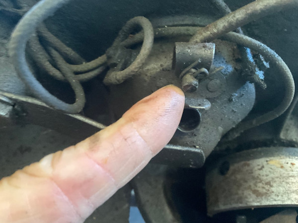

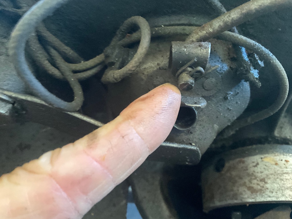

From the photo I can't tell what kind of timer you have. When you remove the cover take a close look at the brush and see what condition it is in (post a photo.) Steve Jelf has an excellent discussion of timing at <https://dauntlessgeezer.com/DG97.html> that you might find interesting. If you find it necessary to replace your timer it will allow you to check whether the new one needs any adjustment or whether the old one is properly set for that matter.

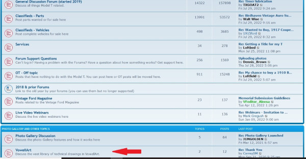

Check out the other Discussions Threads. A must is to drill down on the Vowell Art Links for exploded diagrams https://mtfca.com/phpBB3/viewforum.php?f=14 --

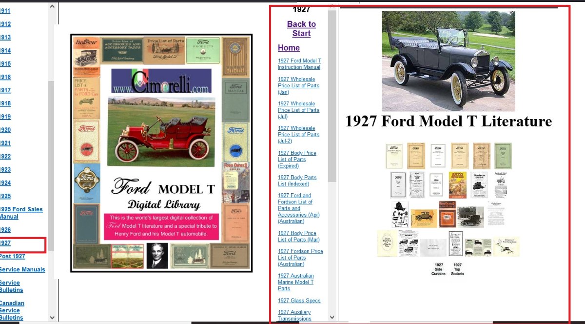

Lots of Downloadable / Printable Documentation on Cimorelli's Site
http://www.cimorelli.com/mtdl/default.htm or http://www.cimorelli.com/mtdl/1927/default.htm
Click on side menu or manual image

Make sure it not an E-Timer or I-Timer, they are completely maintenance free and require No lubrication, EvER! They can be identified by removing the timer from its mounting position and looking inside the timer housing for a green or blue circuit board with white lettering.

The timer that flyingpiper has pictured in his first comment is a original style roller timer that required light oil lubrication. The oil filler flip cap on top of it identifies it as one with his finger raising the cap.
