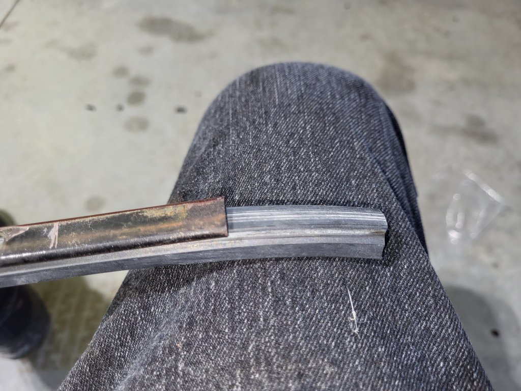

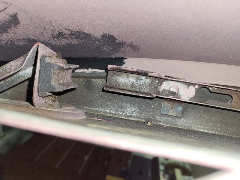

4) The second photo shows the rubber cushion being inserted into the metal channel that is attached to the top of the door by three screws. Should adhesive be used on the rubber cushion? The cushion seems to be held firmly in place by the three screws and its "shaped" bottom as shown in the third photo.

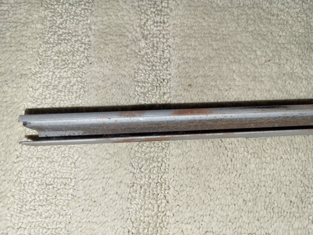

Regarding my first question, I now believe it will be fairly ease to determine the length between the anchor points.
Regarding my second question, I have drilled out the rivets on the top and bottom anchor clips and will use small bolts to reattach them.
The attached photos show my metal channels into which the glass will be is set. Should I paint the inside or would the bare metal provide better adhesion for the setting tape?

I used small pop rivets with washers on the reverse side. Unlike screws and nuts, rivets will not vibrate loose. I sanded, primed and painted my channels so they would not rust. Jim Patrick
