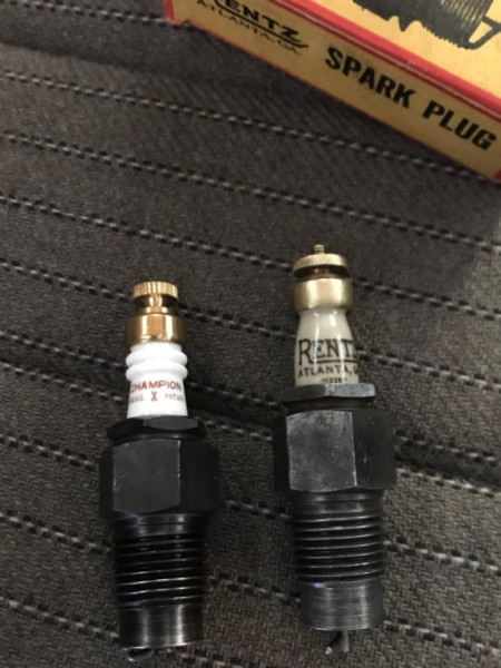

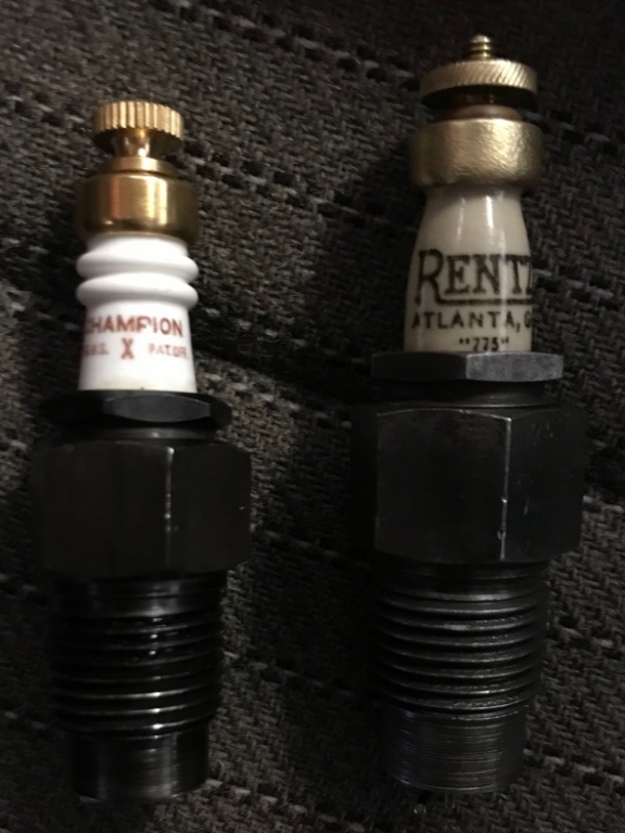

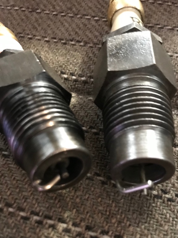

I tried out a NOS set of Rentz Spark Plugs after running new Champion X’s for a long time. They have a longer electrode than the Champions which I assume makes them a hotter plug, so I set the gap a bit bigger on them, between .030 and .035 for the Rentz. The champions I have set at a snug .025

I would go back to a smaller gap. The longer electrode would not give a hotter spark, but the plug tip would likely run hotter. Be sure the plug wires are not touching anything or positioned near anything. The Champion plug with the sharp edged electrodes would fire at a lower voltage than the Rentz plug with the rounded electrodes. The Rentz plug would probably hold an adjustment longer. Try the Rentz plugs at .025 to .027.

It is nice to hear that the Rentz plugs run well in your Model T. Back in the 1970’s someone found a old warehouse with large lot of new Rentz plugs fitting many different makes of cars from before the early 1930’s. The plugs were sold via Hemmings in the 1970’s and they had two reaches of half inch pipe plugs, the long reach that you show and a shorter reach plug more like the Champion plug you show. My dad and I bought several sets of each reach half inch pipe Rentz plugs but kept them for display. I always wanted to try out a set, maybe now is the time to do so.

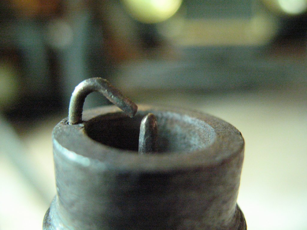

Some plugs with rounded electrodes tested poor to bad. I flattened the ends of the electrodes with a miniature grinder and most tested OK. I haven't tried them in a car yet.

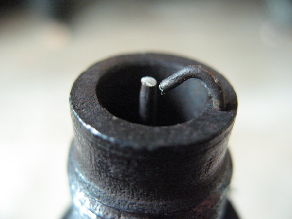

Restoring the original electrode profiles can make a difference. The ideal electrode would probably be a needle point, but that's impractical for several reasons. The plug you pictured has very worn electrodes. Setting the gap would help that plug, but restoring the electrode profile as shown, and setting the gap would probably get it close to as-new performance.
