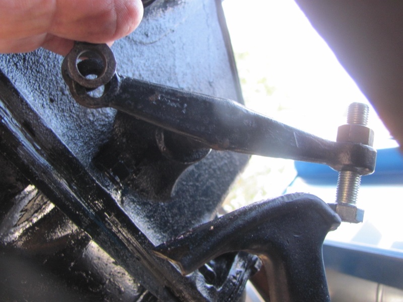

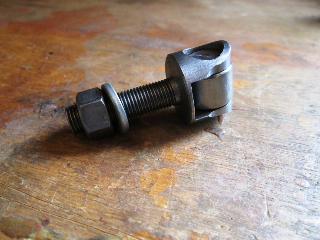

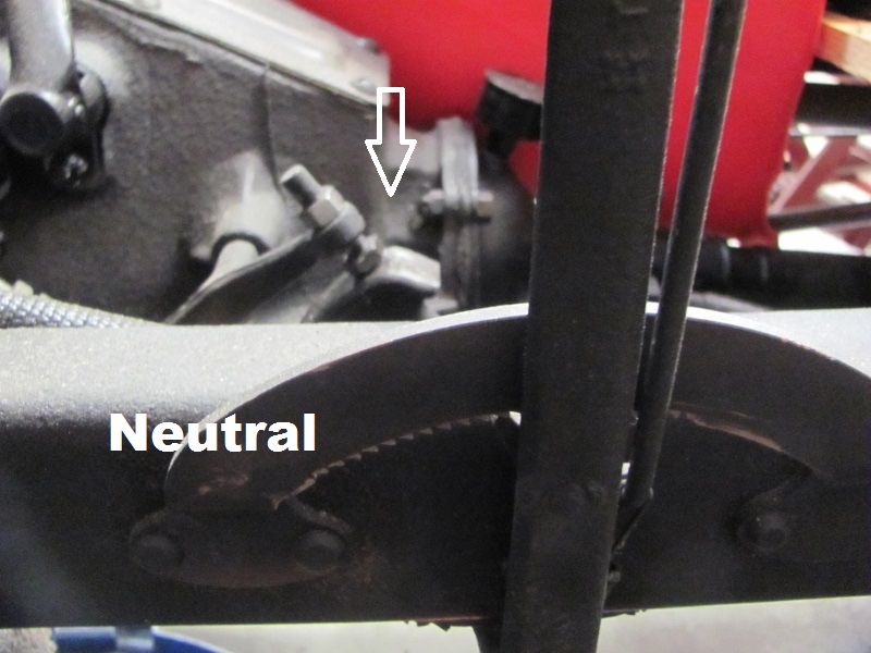

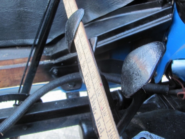

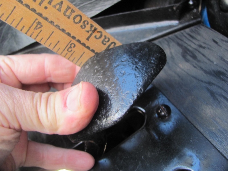

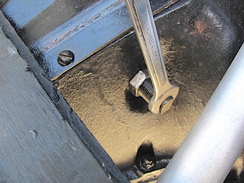

If you haven't done it, maybe a couple of pics will help, and some hints.
The Ford Service Fig. 508 shows the clevis gap that should be made, for a good free neutral, the rest of the linkage and the pedal cams, and the clutch need to be in good order too.
First, check is to be sure the Ford can roll on its own, hand pushing or pulling, without substantial and stiff drag, when the clutch handle is pulled to vertical (without rear brakes engaged). You know you have neutral with the clutch pack that way, and the Adj. Bolt on the clutch lever is set ok.
Now, disengage the clevis pin from the clevis and clutch lever.
Then, adjust Low Pedal, to have the low band rather tight, if loose, getting a 'free neutral' is difficult. Also a loose low band will stick down and that will keep the T in forward motion! Have the low pedal completely compress the low band tight, about 2" or so from the floorboard. This adjustment is made with the bolt and lock nut on the side of the hogshead.
Now, pull back and hold low pedal so all the slop is out of the pedal cam, use a retaining means to hold the pedal back.
Put the clutch handle forward into high gear, so the Adj. Bolt is off the cross shaft cam.
Turn the clevis to gain the approx. gap. Now relax the low pedal from its most rearward position, then align the clevis and the clutch lever, and replace clevis pin and cotter.
Now start the Ford, and check free neutral with the low pedal, should be a good range established. While started, note if the T wants to really creep forward, with the clutch handle straight up, or with your foot holding low pedal in 'free neutral'. If the creep is excessive, turn the Adj. Bolt on the clutch lever to minimize creep. Normal to have some minimal creep, that is the reason the clutch handle also controls the rear brakes, but on level ground, with engine running and in 'free neutral', there shouldn't be much at all with a warm motor.

Great photos Dan.The last pic just needs the 1/16" notation. It would do wonders if the service manuals could be updated with this type of photo instead of the reproduced copies of copies of the old photos.

Dan that last photo took me a long time to understand how to take the measurement. The book is so blurry. You pictures should be mad a sticky in the tech section. Nice job!
