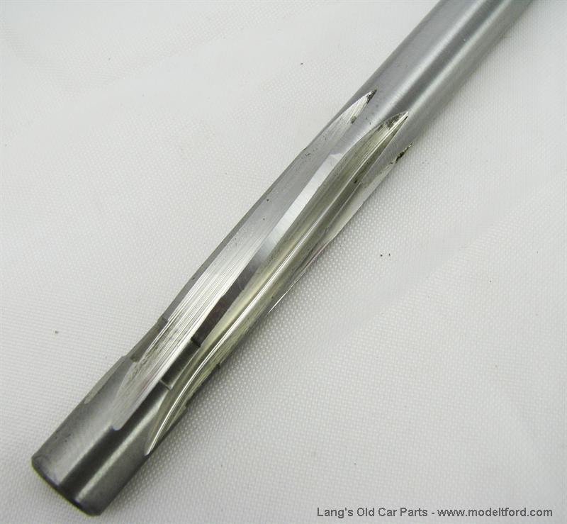

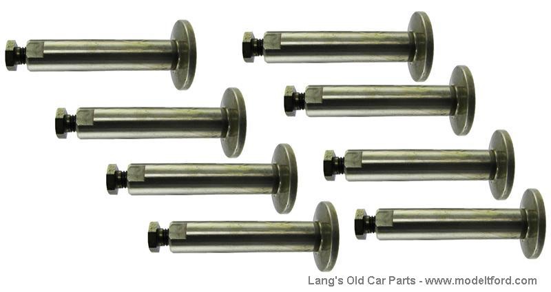

I’m not sure exactly what you mean. If you mean enlarging the tappet holes… yes. They have two sized reamers and tappets to fit: 1/64” over and 1/32” over. They have 1/64” over adjustable tappets. I am posting a picture of 1/64” over reamer and a set of 1/64” over adjustable tappets. Available from Lang’s and Snyder’s. Pictures from Lang’s. Jim Patrick
