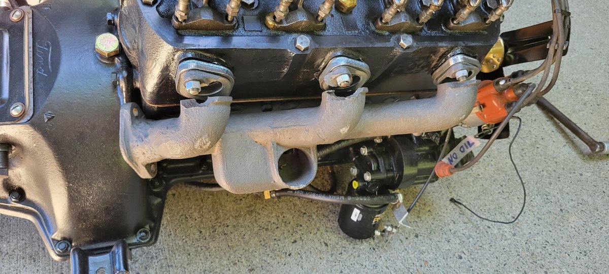

Post by KWTownsend » Mon Aug 08, 2022 6:48 pm
Crunch. Ouch.
Many, many bad word were said.
This Frontenac exhaust manifold had been repaired (at least) once before and the flanges were so thin, spacers were needed for the manifold to clear the hogshead. There is no marking on the head, but the combustion chamber measurement indicates it is a Model T.
The way I see it my options are:
1) Find and replace the manifold with an original. Either with intake pre-heater or not.
2) Have a new header fabricated. (Although I prefer the original look.)
3) Have the manifold pieces welded or braised back together onto the spacers (which are actually header flanges.)
I would appreciate constructive suggestions and leads to prospective replacement parts and service.
Thanks,
Keith

Didn’t it originally have the threaded connector like the Ford manifold? I would repair it with my powder spray torch. Best method I have used for this kind of thing.

Sure is a sad sight! On the brighter side... at least the manifold wasn’t a pristine original.
Making headers isn’t that big a deal... and welding cast iron components (especially dirty and oily pieces like exhaust manifolds) is never fun. Making a header will take a couple days, welding could be months, and finding an original could take years. Looks like your motor is ready to run... I’d order up some tubing...
There are options for making a new manifold... but aren’t for the faint of heart

Welding exhaust manifolds by any process is no picnic. Never can tell how they are going to respond to therapy. It would need to be bolted to the head during the process and proper preheat and cooling would be crucial.

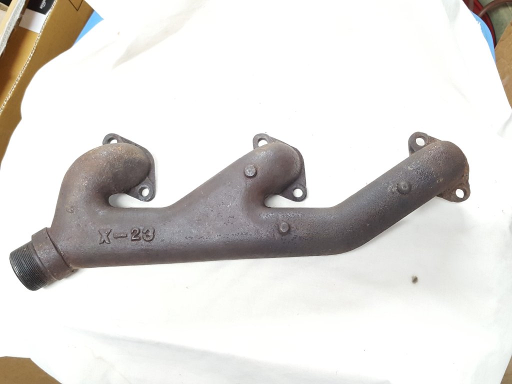

Yes, the manifold was originally threaded and used a stock T exhaust manifold and nut. Here is how one type looked:
Someone made a flange connection with the exhaust pipe at some time.

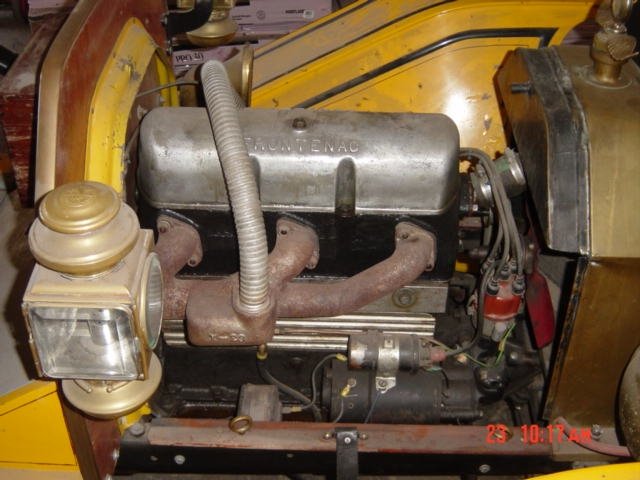

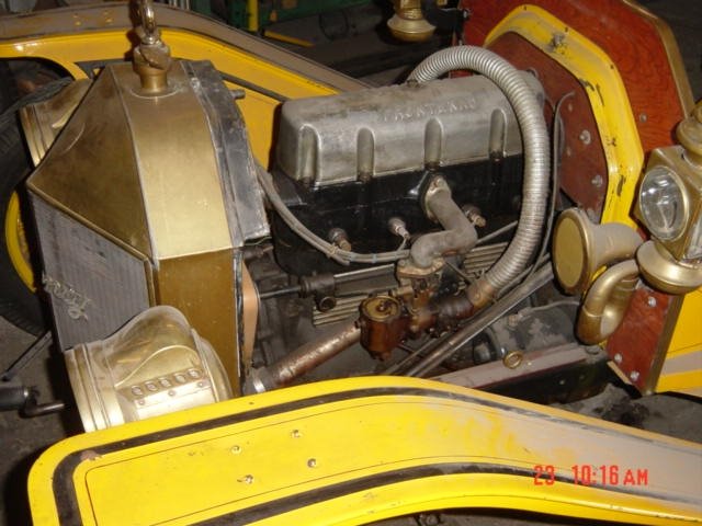

The opening is for a carburetor pre-heater pipe:
I have never seen another with this feature. I would be happy with either.

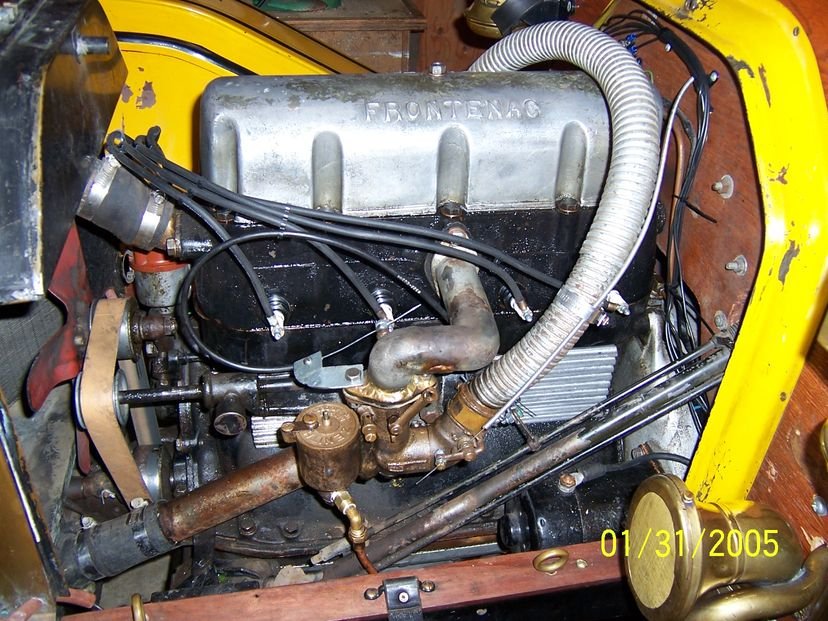

Here is the carburetor end, fitted to a Stromberg OE-1:
I have a Zenith O-4 that I will probably use on it:

All things are possible. I would cut a good threaded end off a warped T manifold and section it onto the Fronty manifold after cutting off the flanged connection that doesn’t belong there.
