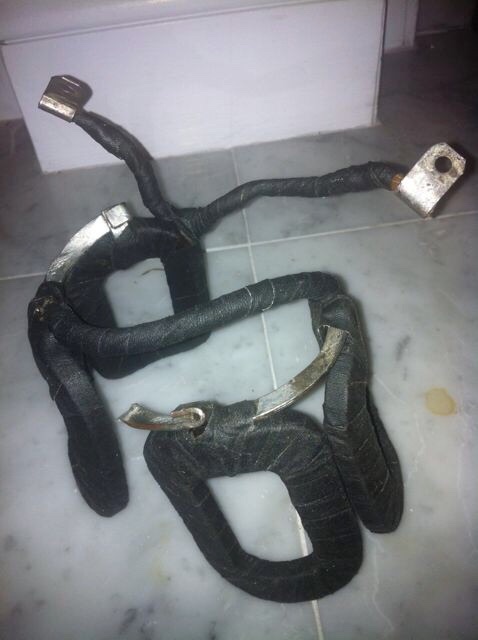

Sure. First off, the stock T generator, properly rebuilt and adjusted with a fun projects (or equivalent) 12v regulator will charge a 12v battery. It puts out plenty of voltage and current for the job.
The starter is another story. Put 12v on it and it slams the bendix into the ring gear with a lot of extra force. While plenty of folks have made the case that "I've run my T that way with no issues for years", luck has clearly been on their side. Simple physics and electronics math (V=IR, and P=VI) tells you this this is a recipe for electrical and mechanical disaster over time. It not only puts a lot more stress on the bendix, it puts twice the current through the brushes, armature, wires, field coils, etc. The big losers being the armature commutator and brushes. The field coils can take it, the other components not so much. Sure it'll work for a while, but all additional stress on the listed components will shorten their service life significantly.
So, the solution is to rewire the starter field coils. Stock they are wired in parallel. The 12v conversion wires them in series. Using the equation P=VI,(power equals volts times current) you get half the current when you do that. Thus, when wired in series you essentially get the same stress on all components as if running 6v. This sounds easy, but as I've discovered doing a few of these conversions now, it's a royal pain in the a$$. A LARGE soldering iron, big wire, good insulators, silver based solder and oodles of patience are all necessary to do it right. You also have to get the polarity/magnetism of the poles right on each field coil or nothing works.
I've included a few shots below. The old, used, rewrapped coils ultimately shorted against the housing, but they proved to be a good training and learning ground as this conversion has been attempted by many folks. Some successful, others not so much. After doing this conversion several times now, I've since decided I won't do it unless I start with a new set of field coils. Even when rewrapping the old ones, there's just too much at stake with respect to shorts, so New field coils is the only way to go.
Steve Tomaso just got my last 12v conversation and I don't think he'd mind my quoting him "Starter rolled in yesterday - nice job, my friend ! Very nice job on the brass snout bushing - fits a Bendix drive like a high end leather glove !"

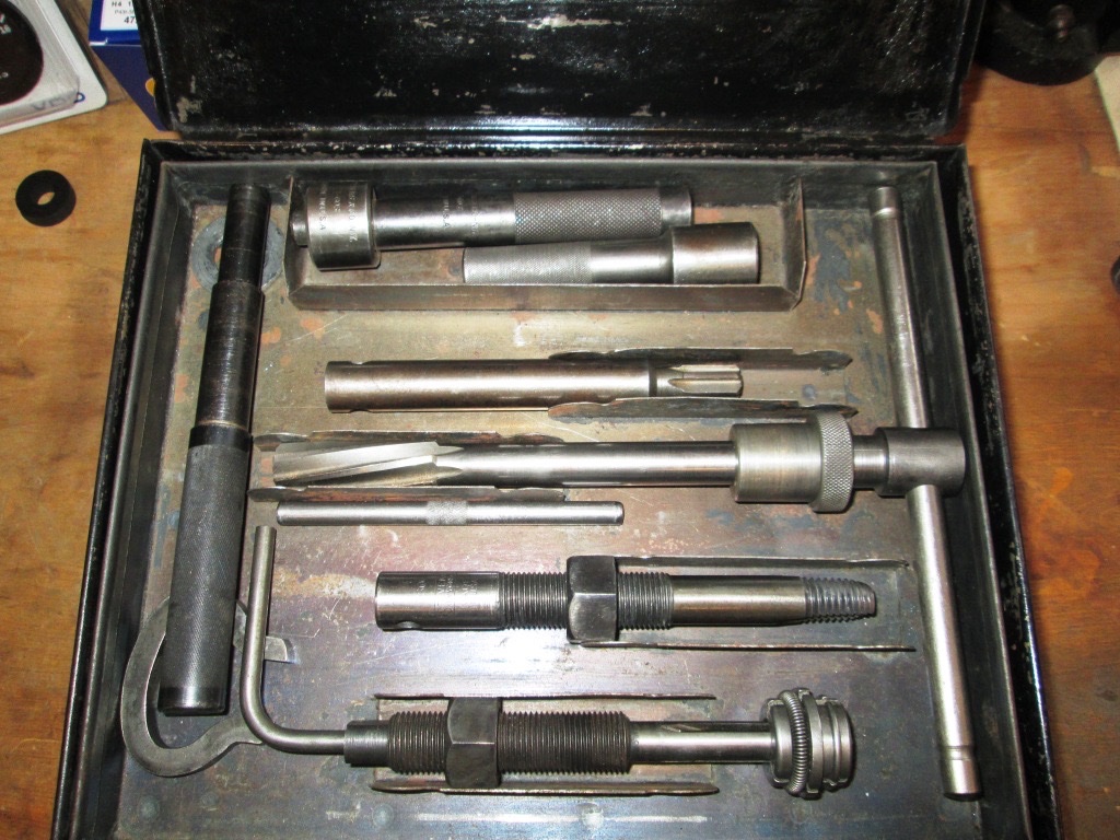

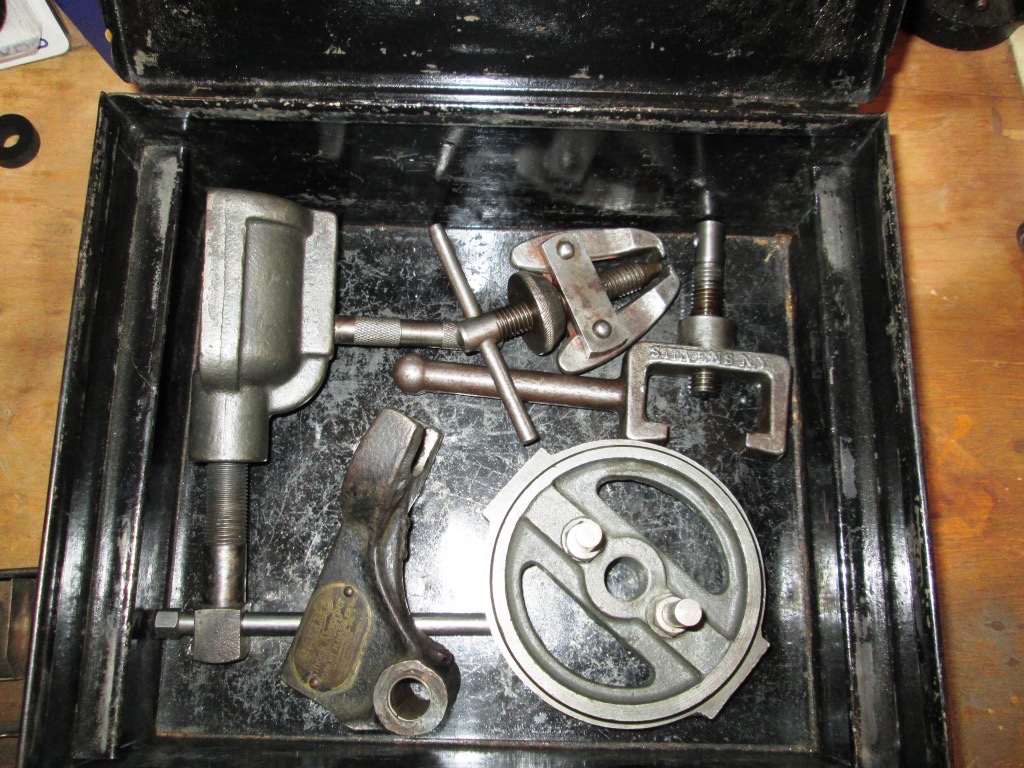

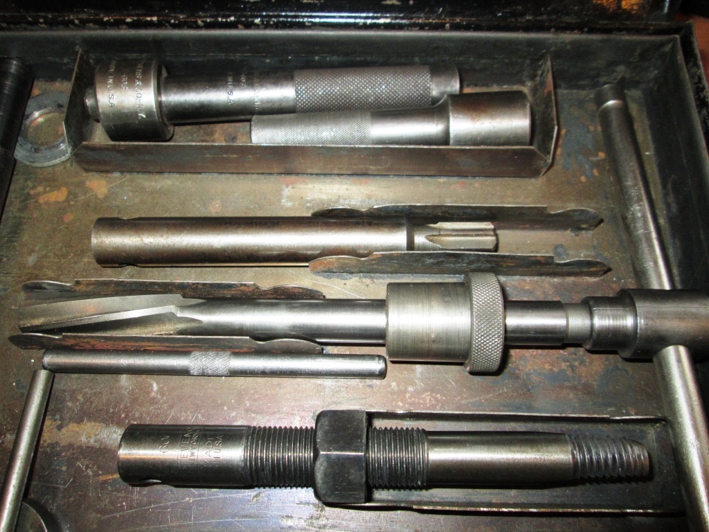

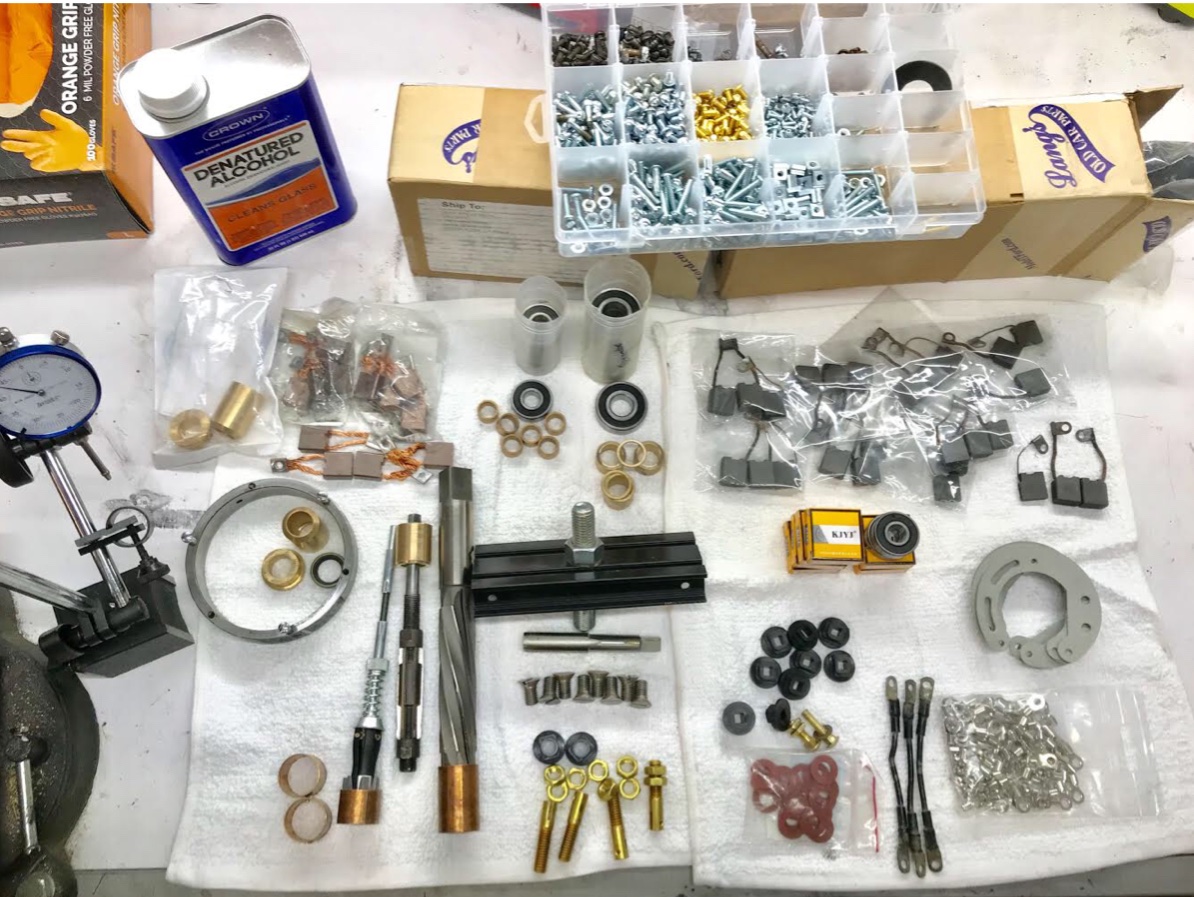

Thanks Hank! Starters are tricky! Lots of things can bite you, especially when doing all the bushings.
Here’s all my tooling I’ve come up with. I’m not fortunate like Steve Tomaso to have the complete Stevens starter & Generator rebuild kit. Trial and error and lots of reading/studying landed me here.
Tomaso sent me pics of his Stevens kit. I drool over this every day... I think I’ll break this thread off into the general forum. Lots to unpack here...

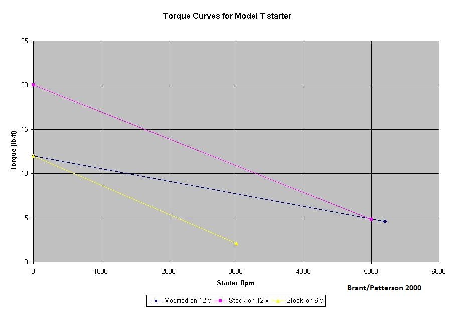

Many years ago Chuck Brant and I conducted some instrumented tests to ascertain the operational characteristics of 1.) original Model T starters operating on six volts, 2.) six volt starters running on twelve volts and a six volt starter with the field windings rewired from series/parallel to full series.
Here is a chart depicting the results of those tests for of all three starters.

Chuck made a simple instrumented Prony Brake to take the starter measurements on the chart i posted.

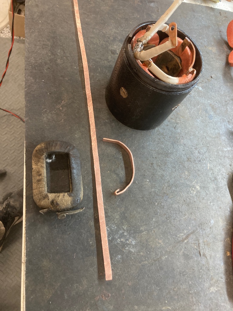

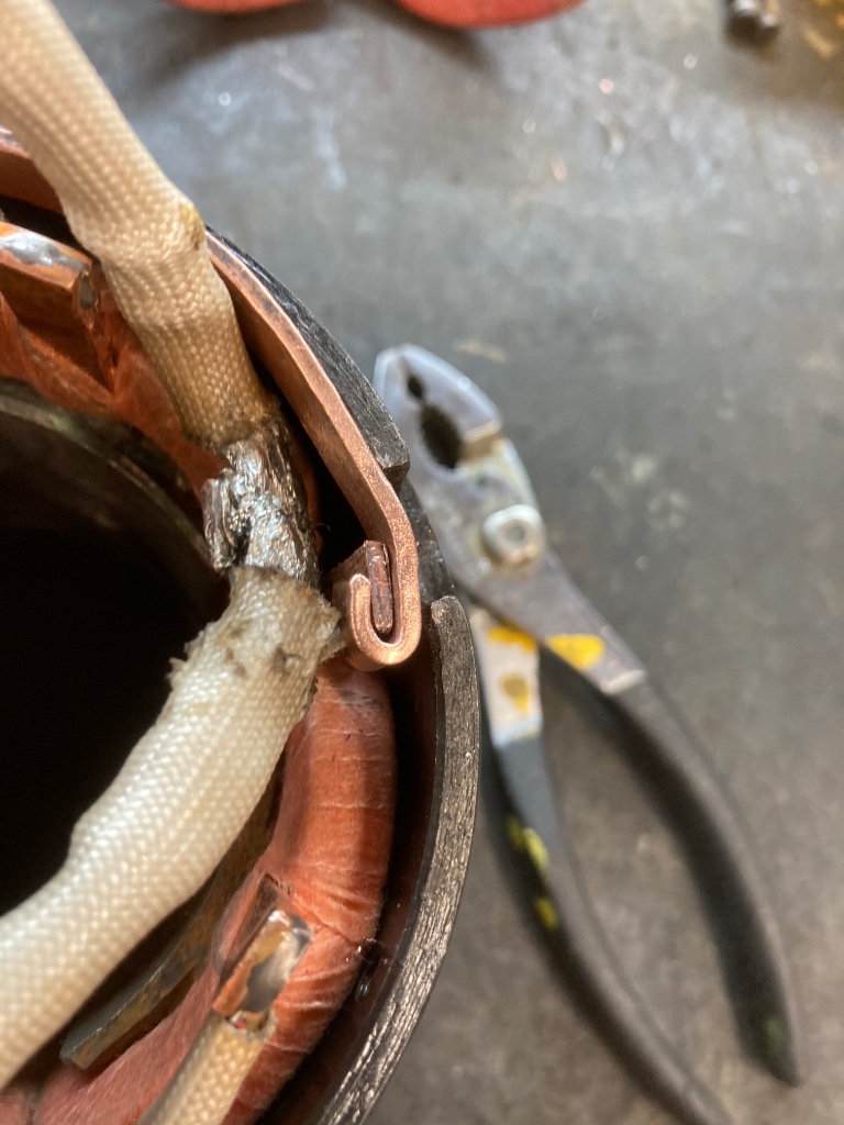

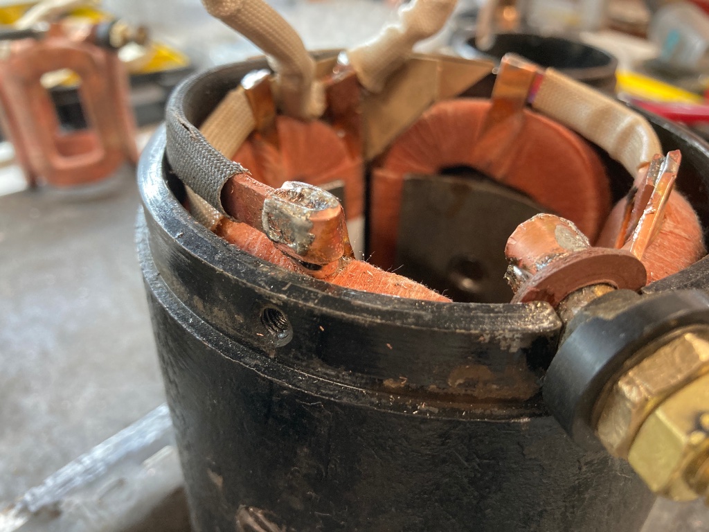

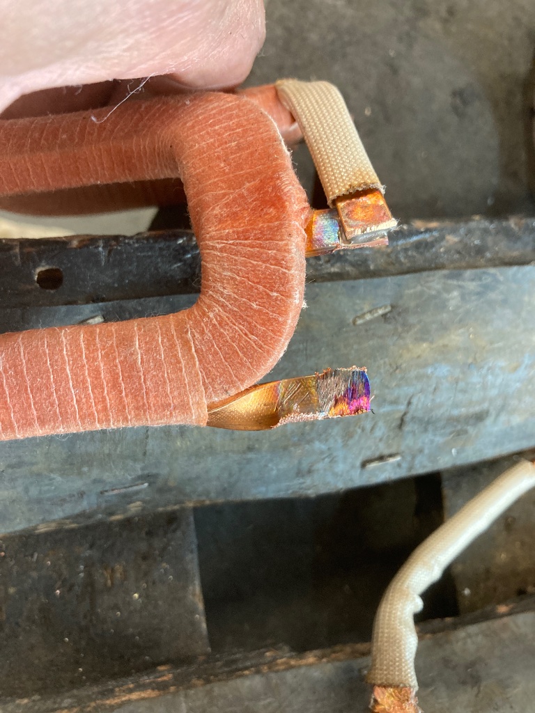

Updated 12v conversion process.
I recently got a tip from Another forum member on 12v starter conversions. Instead of large gauge wire making the jumper between coils, he used the copper from a old starter coil. I've done several conversions using this technique and can report it is by far the best method I've used, bar none.
A couple of tricks make this a solid solution. I ALWAYS use new field coils when rebuilding starters. It's about the harshest environment you can imagine and old field coils just don't cut it as I offer a 1 year warranty on my starters and I don't like fixing broke. Use old field coils at your own risk.
Separate the new field coils at the middle. Carefully remove the field wires from one of the coil halves. This is not easy and takes some finesse. I use 2 good quality needle nose vice grips and harsh language. The harsher the language, the better the results.
It matters which one keeps the wires... look closely.
Unwrap and clean enough copper from an old coil. 6-8" is good. It needs to be completely straightened, and then polished clean.

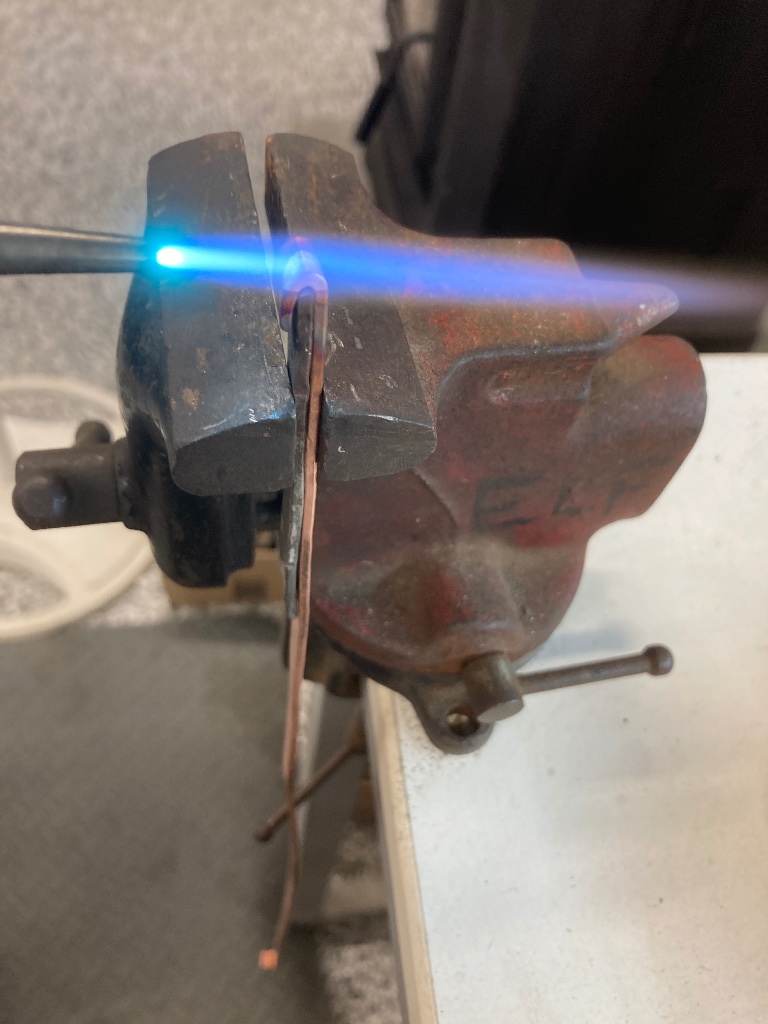

Bend one of the ends using heat and another piece of copper as a template gauge.
Bend the copper into the general circle form. I use a generator end housing.
Fit the piece to the starter coils.
That's the hardest part, and takes the most time. It's tedious, and you have to be patient when fitting the copper.

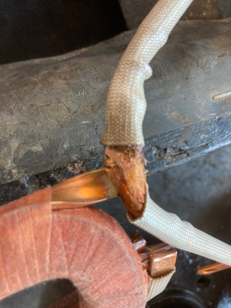

Next, I use some fiberglass wire heat shield and cover the exposed copper with it.
Then I silver solder both ends in place.
The final piece is to use fiberglass impregnated gasket material to insulate the conductors so the6 don't short out. You could probably get away with wrapping it with fiberglass cloth tape as well. NOT electrical tape. Starters see oil. Electrical tape disintegrates when exposed to oil.
And that's it! Countless hours went into perfecting this process, but I feel that if folks want to attempt it on their own, have at it... we have to pass on the knowledge. This adds several hours to an already tedious starter rebuild process, but done correctly, it should last as long as rebuilt 6v starters.
