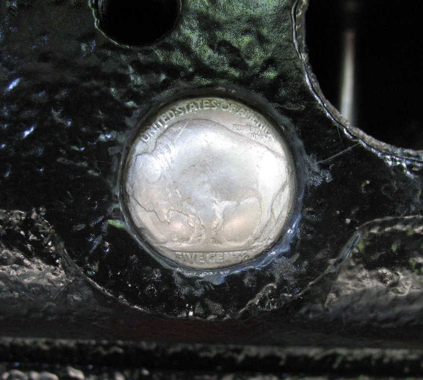

Norm's latest adventure in What have you done... reminded me of driving down the street in a town two states from home and a couple of guys in the car next to me yelling that water was pouring out of my car. Fortunately the plug was leaking but not lost, and fixing the leak was easy. But if it had fallen out on the street it would have been a real problem. So I've added casting/freeze plugs to my list of spares to carry.
By the way, I've found that old time Permatex #2 is not the sealant to use with those. Ultra Black has survived much better.

I agree that some spare freeze plugs along is a good idea. If you don't have one when you need it, you can take a socket wrench, a ball peen hammer, and a nickle and curve the coin to fit. Then use it for a plug. I personally use the brass ones. They seem to last longer than the steel ones. Not sure what kind I have in the car. They were painted when the engine was painted.
Anyway, what I think happened is that they had been seeping for a long time, but before every tour, I check the coolant and look for leaks. The usual places for leaks are the radiator, the hoses and if you have a water pump, the pump. Since the seeping has been slow, it is not noticed because they are behind the manifolds or need to bend down to look toward them. And when parked there are oil drips and maybe a few drops gas from carburetor, in that area, the water drops are not noticed. So on this tour which was about 150 miles up and down mountains, and stop for lunch. I should have checked the coolant at least after stopping for lunch, but I didn't and when it started getting hot, I was almost home so I thought I could make it home. The pressure of steam got so high it blew the weakest point in the head gasket. Naturally, that was the only place I noticed, because it is very close to the rear freeze plug, but after placing the new gasket, I checked that area and saw the leak. The front one had been seeping earlier, and I smeared some ultra black on the outside of it. Anyway, today I have the day off, need to take Dolores to the doctor. Just a checkup, not any problem unless they find one today.

I don't know if it was due to years of antifreeze or hot water, but old #2 definitely failed in that application for me.
Choosing among plugs is pretty easy. Steel will rust out, of course, while brass will not. But I think the nickel Norm suggested will last even better than brass. It's also cheaper, if that matters. It's what I use.
