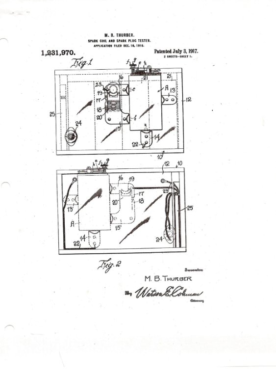

I have attached a patent design of a 1917 spark coil and spark(ing) plug tester, per a google patent search. Patent number 1231970. There is a wiring design with the patent papers. enjoy.
Last edited by Been Here Before on Sun Dec 19, 2021 1:21 pm, edited 1 time in total.

(part 2) - I have attached a patent design of a 1917 spark coil and spark(ing) plug tester, per a google patent search. Patent number 1231970. There is a wiring design with the patent papers. enjoy.

I don't see a meter in there. (Kind of tough to see actually). So isn't this just a fancy buzz box?

This design uses two meters: the infinitely variable Mk1 eyeball light detector and the aural sensor meters (eyes and ears) to see and 'judge' that the spark being made is fat and happy.
Even with a meter showing the amps, adjustment in the old buzz box approach still needs these meters to be used as well.

Been Here Before
Posts: 654
First Name: George John
Last Name: Drobnock
Re: Adjusting buzzer coils
Post by Been Here Before » Fri Dec 24, 2021 2:43 pm
"Seem to recall that you had a HCCT in your collection."Mark Gregush » Fri Dec 24, 2021 1:52 pm
Yes I do. And it is an interesting conversation piece on the shelf.
When it was given to me many years ago, acquired from a garage that had its roots in an early Ford dealership garage, I was told by the gentlemen trained as a Ford Mechanic (early Fords) it was always a conversation piece.

I am in the process of building a coil tester. It will not tell you if you have a double spark or some of the things an Ecct tester will but you can find out if you have a usable coil and will not empty your billfold.
Several years ago in Tinkering Tips one was pictured using a 6 volt battery. Ted Aschman said it would work better using a good electric train transformer as they put out AC current. Mine uses a small wooden box to hold the coil with original brass contacts, bolts and ceramic insulators. I made a grounded metal spark gap unit and had a model t amp meter wired in.
The first 2 coils I tested did nothing. The third one buzzed and put out a weak spark and the amp meter moved slightly. This set up should tell me if the capacitors are good or if the coils only need an adjustment.
Since then a 0 to 30 AC voltmeter and a 0 to 5 AC amp meter have been purchased. Right now I have about $12 involved as everything else were things that were in my parts and now I want to redo it on a different board and mount the new meters. I would like to redesign it so the unit will be in a wood box to keep it from dust and damage.
I liked the picture of the unit with a metal broom holder ho
Ding the spark plug.
