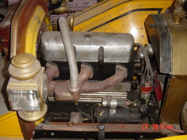

Yes, the manifold was originally threaded and used a stock T exhaust manifold and nut. Here is how one type looked:
Someone made a flange connection with the exhaust pipe at some time.

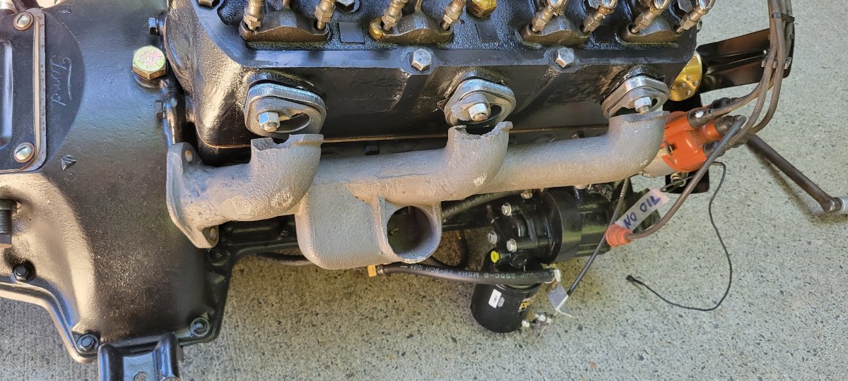

The opening is for a carburetor pre-heater pipe:
I have never seen another with this feature. I would be happy with either.

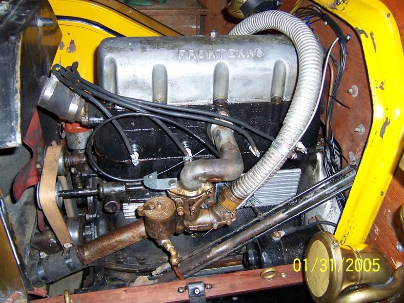

Here is the carburetor end, fitted to a Stromberg OE-1:
I have a Zenith O-4 that I will probably use on it:
