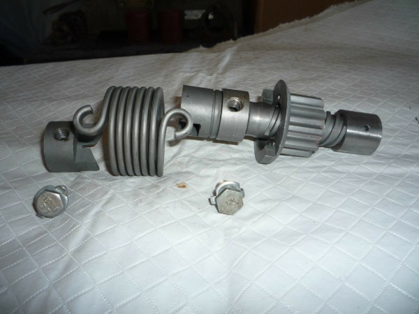

Pictures are better than words. Without them everything rests on assumptions. Bent Bendix????

Process of elimination. Ring gear perfect.(every inch looked @ & not mounted backwards.) Starter shaft straight.
Bendix unknown. Pix would help. Have you looked @ the bendix? Is it a true model T bendix or a kinda fits replacement? The front collar is about 1" long & polished smooth.
Is it a 1 piece gear & counter weight? Thats repop & not to be trusted.
Theres a good pix. I dont think its possible to have a bent unit. They are very hard & tough. I have had over a hundred pass thru my hands & never seen a bent one.

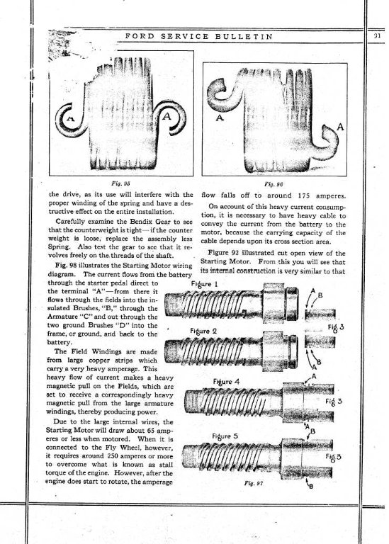

Post by TRDxB2 » Thu Jul 21, 2022 5:28 pm
Some info to look at
Starter Bendix Repair.pdf
(751.54 KiB) Downloaded 128 times

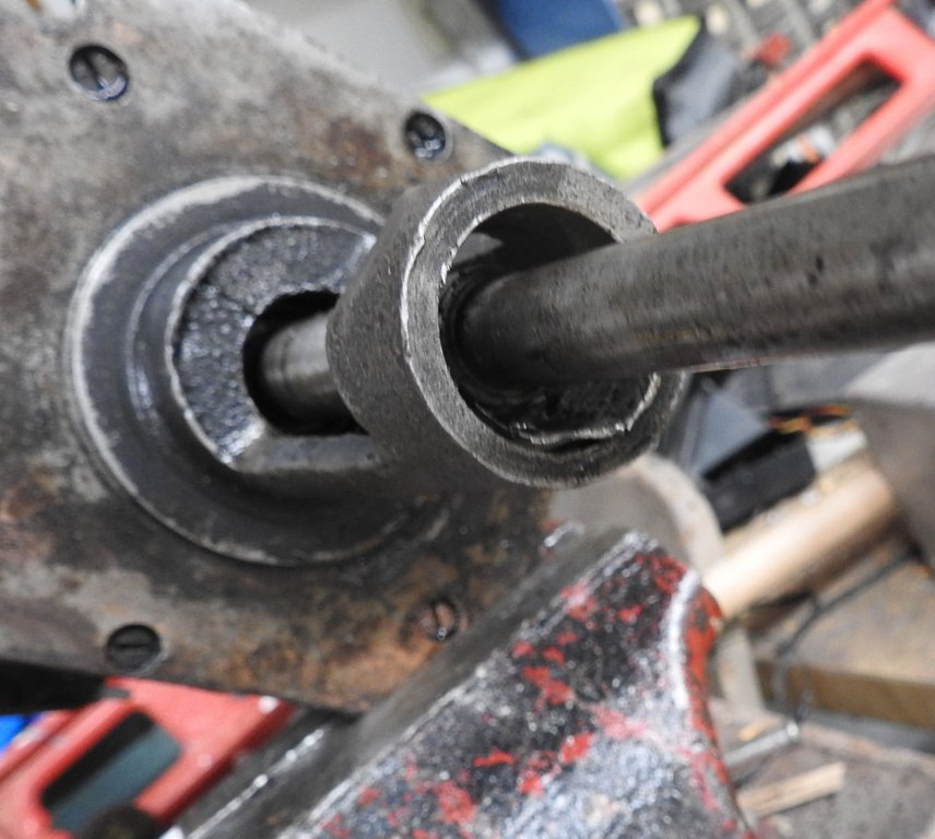

Post by fishndale » Fri Aug 12, 2022 4:40 pm
Have the same issue. What was interesting in my case is that loosening the starter and jogging the truck didn't help (model TT). I beat on the starter too. After removing the Bendix spring and heads, the gear and starter were still both stuck. Starter backed out about 1/4 inch but no further. Had to beat on the starter shaft from the Bendix side to push out the starter enough to free the gear.
I suspect the Bendix gear was stuck in the starter nose. Attached is a photo of some galling in the nose.
Unfortunately I managed to burn out the starter after several tries (act like a short). Looking for a rebuilt. ;)
Posts: 6801
Re: 1926 T - Replaced 6V starter and Bendix still Sticking
Post by Scott_Conger » Fri Aug 12, 2022 4:55 pm
Dale
you're also now looking for a magneto coil ring, because that removal method all but certainly destroyed it
shine a light into the bendix-cover hole and you'll see the carnage :(
You'll do yourself a huge favor by buying the "T-2" Ford shop manual from any supplier, and study up on any repair you intend to do to avoid future regrets. The starter removal is just about the biggest time-bomb job that can be done on a Model T if done wrong.
fishndale
Posts: 10
Joined: Wed Jun 23, 2021 8:35 pm
First Name: dale
Last Name: dorando
* REQUIRED* Type and Year of Model Ts owned: 1922 Model TT stakebed
Location: El Dorado Hills,CA
Post by fishndale » Fri Aug 12, 2022 5:11 pm
The magneto is fine. The gear was stuck on the flywheel so it didn't move toward the magneto, just the starter shaft.
Looking at the magneto voltage with an oscilloscope, I don't see any missing cycles when cranking by hand. Engine speeds up on magneto.
From the great rebuild videos on YouTube, looks like there should be a bearing in the nose. Its totally unsupported.
Post by Norman Kling » Fri Aug 12, 2022 5:26 pm
The front is not supported. The gear should spin toward the flywheel to start and it should turn the gear on the flywheel until the engine either starts or the battery goes dead. As soon as the engine starts the flywheel spins faster than the starter is turning which spins the gear back toward the starter. So if it is sticking to the gear, something is either out of alignment or the teeth are bad. If the starter engages the flywheel gears and causes the flywheel to turn, the starter is ok. However if it hits the flywheel gear and does not turn the flywheel, the teeth are either worn out or the gear on the flywheel is backward. The teeth on both gears are beveled on the edge so the teeth will slide right in.
A couple other things. Will the engine turn with the hand crank? Is the parking brake lever all the way back when you try to start? If the lever is forward, the car is in high gear and the starter does not have enough power to move the car in gear so it sticks.
Posts: 6801
Post by Scott_Conger » Fri Aug 12, 2022 5:27 pm
the nose would have a babbit bearing (there are some babbit remains showing in your photo). Rebuilds (good ones) have a bronze bushing installed and then line-reamed to the housing.

To answer a couple questions, the hand crank won't turn. The hand brake was in neutral (brake on).
I'm now thinking that since the babbit bearing is gone or destroyed, the bendix may have slid into the starter where the bearing belongs and jammed. A bearing, plus oil seal, should keep the Bendix from going into the starter nose. Correct?
Luckily the magneto coils look fine. If the bendix went into the starter, it could have hit the magneto. Yup, there would be carnage.
Just posted this because it could be related to other folks having stuck starters.

I wonder whether or not you have the correct Bendix. The Model A and early V8's also had starter bendixes, but they are not interchangeable with the Model T. I know that the A spring can be installed on a T, however it is wound in the opposite direction and will tend to unwind after being used on a T.
Posts: 4473
Post by Jerry VanOoteghem » Fri Aug 19, 2022 4:24 pm
Norman Kling wrote:
Fri Aug 19, 2022 4:18 pm
I don't believe that would cause the Bendix gear to jam.
