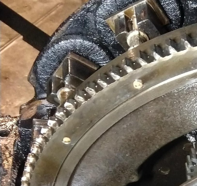

Thank you for the replies. What would be the danger of not doing anything at all? The coil is right next to the starter shaft notch and it is only uncovered about half or less (see photo). All other coils are intact. Thanks.

This is what I think has happened to your winding. Someone at some time has tried to remove the starter without first removing the bendix. when they pulled the starter, the bendix bumped the coil and damaged the insulation. You don't say whether or not the magneto worked before you discovered this damage. If your fix doesn't work, you will have to pull the entire engine and transmission and separate the transmission from the engine to replace it. So do it right the first time.

I have mag rings with some insulation missing and they work fine. There is insulation between the ribbon in the spool, insulation wrapped over the spool, and insulation between the spool and the iron ring. Depends on what insulation is missing. A little off the wrapping may not be a problem, not a problem worth pulling the engine for. Applying anything to the coil now after decades of immersion in hot oil will probably not stick. If your car runs fine on mag don't worry about it and address it later when you need to pull the engine to refreshen or rebuild.

I'd leave it alone. If several turns of that coil are shorted to each other, the magneto will still work at 90+ % output, assuming the magnets are good and the gap is close to spec. If the coil is shorted to ground, the magneto will be very weak or dead. If the coil is open, the magneto will not work at all. I agree with the others that it's unlikely that anything daubed on the coil will remain there, and I'd add that poking at it may cause problems. I'd be very careful that nothing touches the coil when installing the starter, and hope for the best.

Since the insulation is missing in that spot and the winding isn’t damaged I would leave it alone and drive it like it is.
Assuming that your car runs well enough on battery and mag also, install a transmission filter screen and don’t worry about it. There are T’s out there that the original mag ring is still in cars and working.
If something gets loose in the engine such as a piece of babbitt and etc you would know it soon enough whether you have a rebuilt mag ring or not!
Just use a rebuilt coil ring the next time you need to pull the engine for something.
And if your car quits on mag, switch to battery and get home to check out what caused it.
It will probably last longer than you think if nothing gets loose to tare up the mag ring.
As others have said I don’t think the winding is flaking off by it self yet. It probably was nicked when the starter was removed in the past.

Look at the flywheel ring gear! In my opinion the missing insulation is the nat sitting on the trunk of the elephant in the room. The much bigger problem, are the teeth worn so much on the flywheel. And what all that metal in the oil has done to the babbitt. ???
