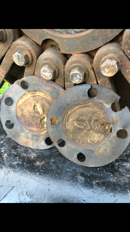

I also found one of these spacers in a motor I took apart.

Re: Crank - transmission spacer?
Never heard of or seen one. I suppose someone could have made it. If the magneto ring was attached without shims & still too close to the magnets, that shim plate/washer could have been the answer to get the proper clearance. I cant think of another reason for it.
With out the spacer, the magnets hit the field coils. Never figured why this happened.
- Posts: 5151
Very interesting. Factory patch/fix makes sense. How thick is this spacer?

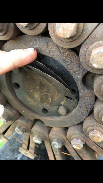

This transmission I bought at Chickasha in 2019 had 2 spacers. It’s small drum but after they omitted the locking wire for the magnet cap screws.
- Posts: 4631
I’ll bet those are Ford factory spacers you have pictured. But that’s a guess! Always something new to learn about Model T’s for sure. It would make since to use shims there also.

- Posts: 4046
Would be just a home mechanic type fix. Took a motor apart with similar spacer, but was made of thick piece of roofing felt. Trimmed in circle with holes to fit.
- Posts: 5482
I agree with Dan - shade tree fix - I've removed both steel & paper !
John:
i have encountered spacers of this type ... were probably between .030" and .035" thick ... i believe these were die stamped and were precise in fit and appearance ... i don't know if they were from Ford or an aftermarket "fix" , but they were not amateur ... always an optimist ...Gene French

- Posts: 4631
I agree too that the idea of a spacer for getting the right spacing for the transmission / mag ring is not a bad idea if it’s necessary. It’s not a ‘farm fix’ in my mind. In fact the same idea is used on modern engines today. A look at Summit Racings website on crankshaft, flex plates, clutch set ups on stock as well on racing engines shims of all sizes and thicknesses are available for use. There is some that have bolt holes in locations around the shim plate to fit most any crankshafts.
Using them in a slightly worn T engine to help in the spacing distance besides using the Ford factory 1 piece shim would only make for closer spacing. I think that if Ford didn’t use them in their dealerships they should have. And I’ll bet some did and didn’t say a lot about it for whatever reason. The independent auto shops would have.
