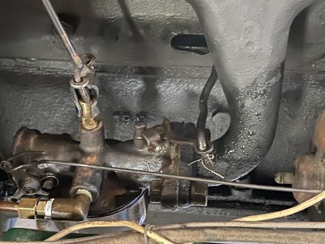

I’m presently bringing back a 1924 Model T pickup that my grandfather put together from parts around 1980. Presently I’m perplexed by two things. After running and everything being up to temp, I have condensation around the connection between the carb and the intake manifold. I recently rebuilt the carb and replaced the intake/exhaust manifold gaskets and painted both manifolds with high temp paint. Is this normal or does this point to some issue? Also, I can’t seem to understand why whether warmed up or cold, sometimes it’s very hard to restart. Even jacking up one tire and putting it in high gear won’t help. Otherwise it runs like a top. Starts on compression at times as well. Any advice is welcome. Thanks
Mike

Typical when running without the factory hot air pipe. I only run my hot air pipe in the winter, the rest of the year I run a home-made air filter.

That is why FORD supplied a hot air pipe on the car. High humidity even with warm weather, and many of these cars will do this. When they do, the fuel will not remain atomized to the proper extent and you often have to run richer as though the vehicle is actually running in very cold weather. When I lived in FL, this was a problem particularly with my '13 and an aluminum intake...I had to run rich enough to keep running, but would tend to foul #1 plug. Adding a hot air pipe solved the problem and I found I could run the carb another 1/2 turn leaner...plugs remained clean, car ran fine, and restarting was not a problem. If you're interested in the technical reason, look up Bernoulli's Principle. It will explain that as the flow of air accelerates through the throat of the venturi, pressure decreases and among other things, because volatile fuel is involved, it drops the temperature, enough to condense moisture. That's what you're seeing, but it is the chill of the intake which plays havoc with the vaporization of the fuel...and that's what you're experiencing.
That said, prepare to be told that you are not seeing what you're seeing...there are plenty of guys in dry climates who have never seen this phenomenon and will be all to happy to tell you that you're doing something wrong. You're not. Just find yourself a hot air pipe and this problem will be in the rear-view mirror very quickly.

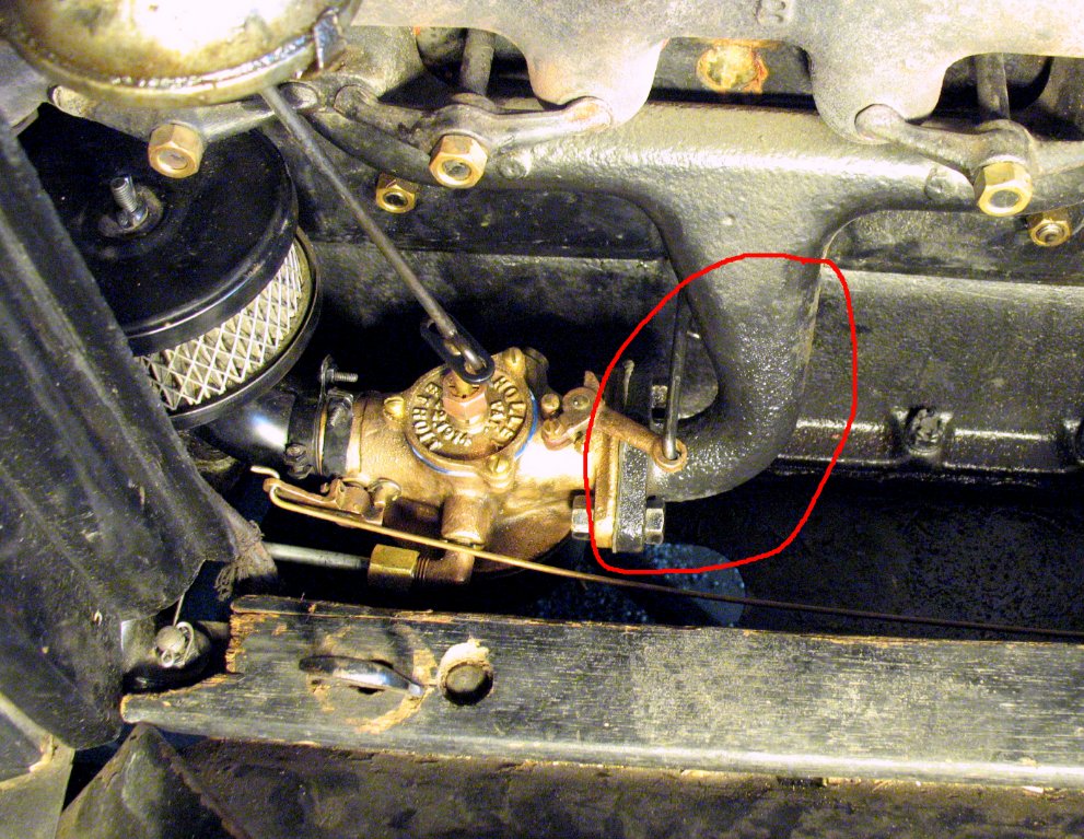

I have never, ever experienced this phenomenon until I installed my "new" Holley G. After running a few minutes at low idle I did notice condensation on the lower end of the intake manifold. So far, "it don't hurt the runnin' of it none". As I drive on country roads a lot, I run an air filter instead of a hot air pipe. I won't change that unless the intake ices up and becomes a problem.

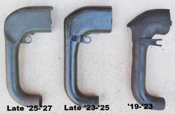

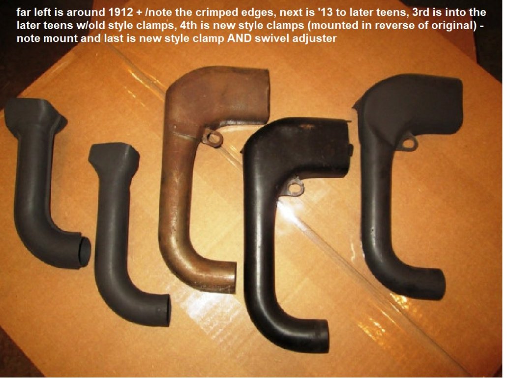

There are several versions of he hot air pipe - I am in the process of adding them to the classifieds

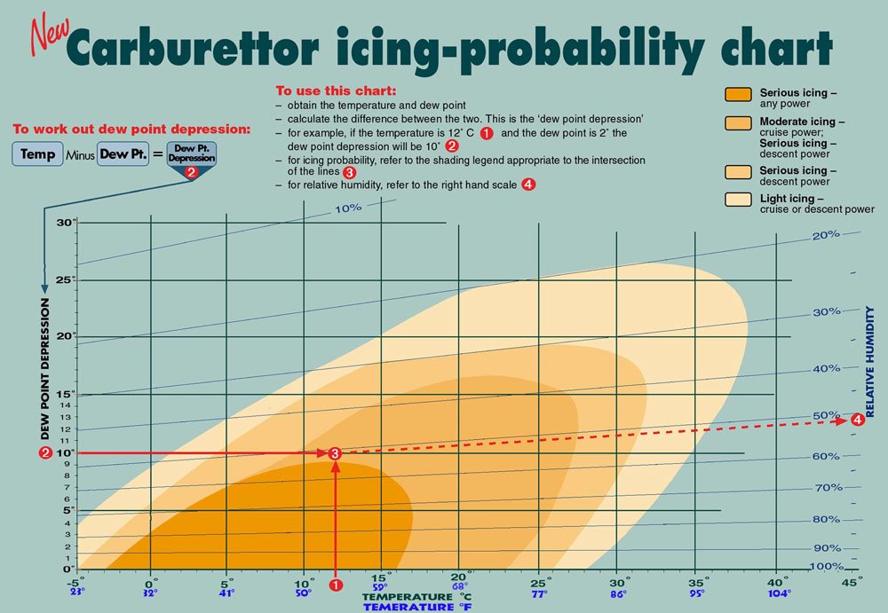

Probability of icing chart

Back when I was learning to fly, we were taught that carburetor ice can form at any temperature below 70 degrees Fahrenheit. Strangely, at extremely low temperatures, ice is rarely an issue as the air doesn't contain enough moisture for ice to form.

I noticed Arizona never occurs on that chart. One of the best performance mods I have done was take the hot air pipe off my other T. Made the comparison on a tour that was mostly model A's & speedsters. I had the most stock & heaviest car on the tour and struggled to keep up. When I took off the pipe I was almost able to keep up. I have no idea why I put it on in the first place? Back in the 1970's we took the heat riser tube off new cars so they would run better. That was part of the emissions mods the MFG's came up with. I'm sure it worked in most of the country, but didn't do anything for a car running in 100+ degree temps. with 10% humidity.

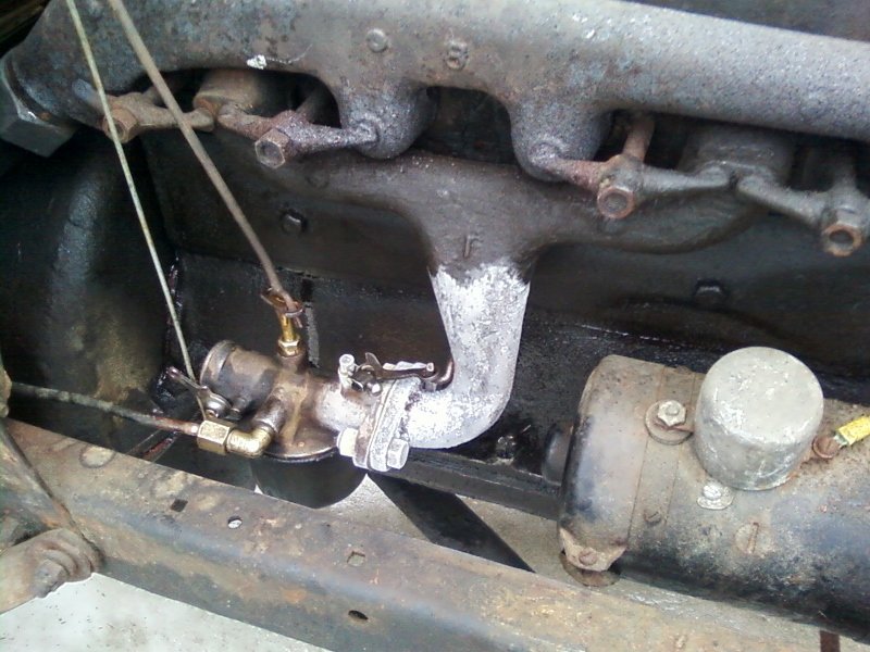

More photographic proof of icing on the manifold and carburettor when the hot air pipe is absent. The engine was running poorly (like crap) and the hot air pipe "fixed" it.
And as others have stated, in some parts of this country it never occurs.

For those chosing to run an air filter, be absolutely sure it can not collect fuel (from over-choking). In my 61 years of playing with Model A's and T's , I've known 3 to have been totally destroyed by fire originating in the add-on air filter. One was a '29 A that I had just restored and the new owner insisted (against my advice) that it needed an air cleaner. He was able to save one stainless tail light.
