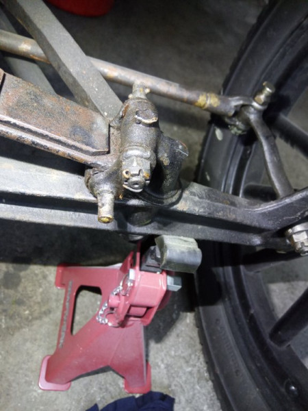

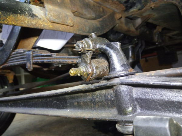

Hi
I'm in the process of making my Touring 1926 made in Canada drivable again.

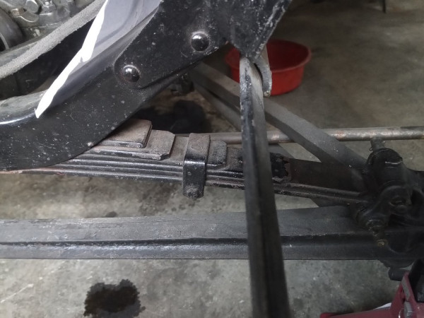

Looking at the front spring and the shackle made me skeptical. Do these shackles belong to this car? Furthermore, there are no holes drilled for an oiler on the 7-blade spring. The corners of the top two sheets are not broken.
What was original on the Ford back then?
The shackles on the rear axle are also fitted with grease nipples, but the spring ones are designed for oilers.
thank you for your help

That looks like a "figure eight" shackle that was used from the 1913 model year through about the end of the 1917 model year (U.S. Fords).
Instead of an Alemite pin type grease fitting, depending on the model year of the car there should be a brass twist oiler or steel snap oiler (which is what I have on my 1917 roadster).

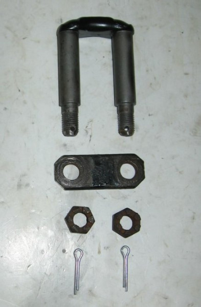

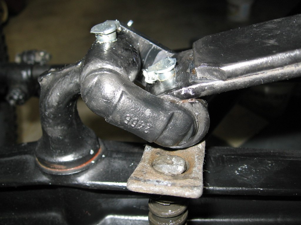

Here is the OEM Ford shackle design for your 1926. The rear shackles have longer shafts than the fronts. The shackle body and end plates are marked with the Ford script. The springs and perches should have holes for flip-top oilers. The shackles should be inserted so that the plates and nuts face towards the rear of the car.

My original '27 has the same front shackles as Mark's photo.
All four shackles have oil cups.

Yes, you can get oilers for the springs and perches from the vendors. Read the notes regarding the number used. Can't hurt to order a few extra in case one gets damaged driving it in.
https://www.modeltford.com/item/3846.aspx
There are probably old threads regarding installing oilers without damaging them, do a Google search on "oiler installation mtfca".
Space is indeed tight. Make sure the oiler is in a position where you can open the lid before you drive it in. Once the oilers are installed, you can jack up the spring end to rotate the shackle and get more room to flip the oiler lid, like the picture.
The oilers are meant to be periodically (like often) be filled with oil. I choose to use a grease needle with a rubber tip to pump grease into my oilers until I see grease seeping out both ends of the shackle. Lasts longer, doesn't drip onto the ground, and seems to work fine.
