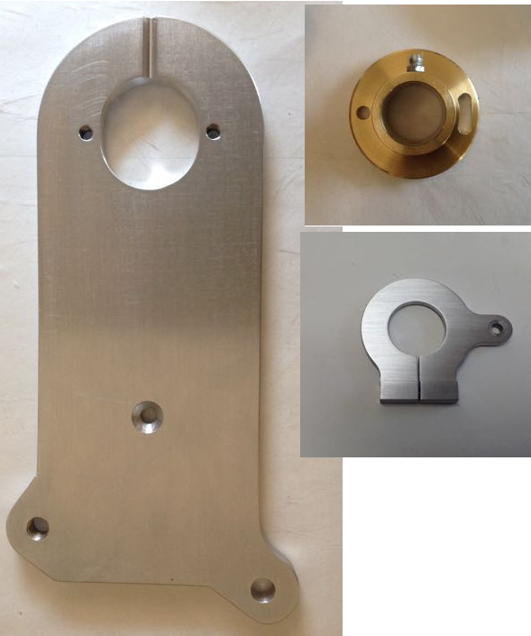

yes i have the bracket and a badly worn vega dist. made by jess blker. i bought a new dist.
but i would like to see how jess did the bearing

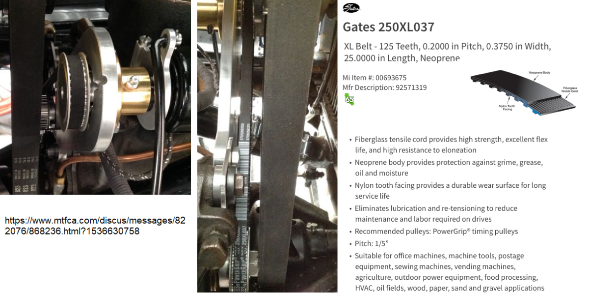

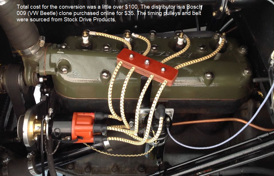

This is a 009 VW version (By Bob Doris, AZ on Wednesday, May 23, 2018) of the Jess Blaker distributor https://www.mtfca.com/discus/messages/8 ... 1536630758

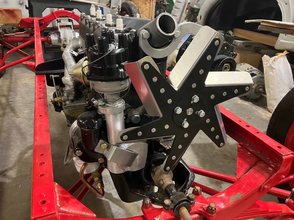

Here is my version of using the Vega distributor.
Gear driven.
Philip
Posts: 239
Joined: Sun Jan 06, 2019 12:09 pm
First Name: Philip
Last Name: Thompson
* REQUIRED* Type and Year of Model Ts owned: 1924 touring
Location: Graham NC
Re: Need blker. Distributor
Post by Philip » Wed Jul 19, 2023 6:19 am
Did you cast the body?
Les Schubert
Posts: 1364
First Name: Les
Last Name: Schubert
Location: Calgary
Post by Les Schubert » Wed Jul 19, 2023 9:41 am
I machined it from two pieces of aluminum and then welded
Les Schubert
Posts: 1364
First Name: Les
Last Name: Schubert
Location: Calgary
Post by Les Schubert » Wed Jul 19, 2023 9:44 am
For the shaft and bearings I bought what is referred to as a “water pump shaft “
Les Schubert
Posts: 1364
First Name: Les
Last Name: Schubert
Location: Calgary
Post by Les Schubert » Wed Jul 19, 2023 5:08 pm
The “traditional” approach to timing a automatic advance distributor is teeing a vacuum gauge into the system and adjusting the timing for maximum vacuum at idle
