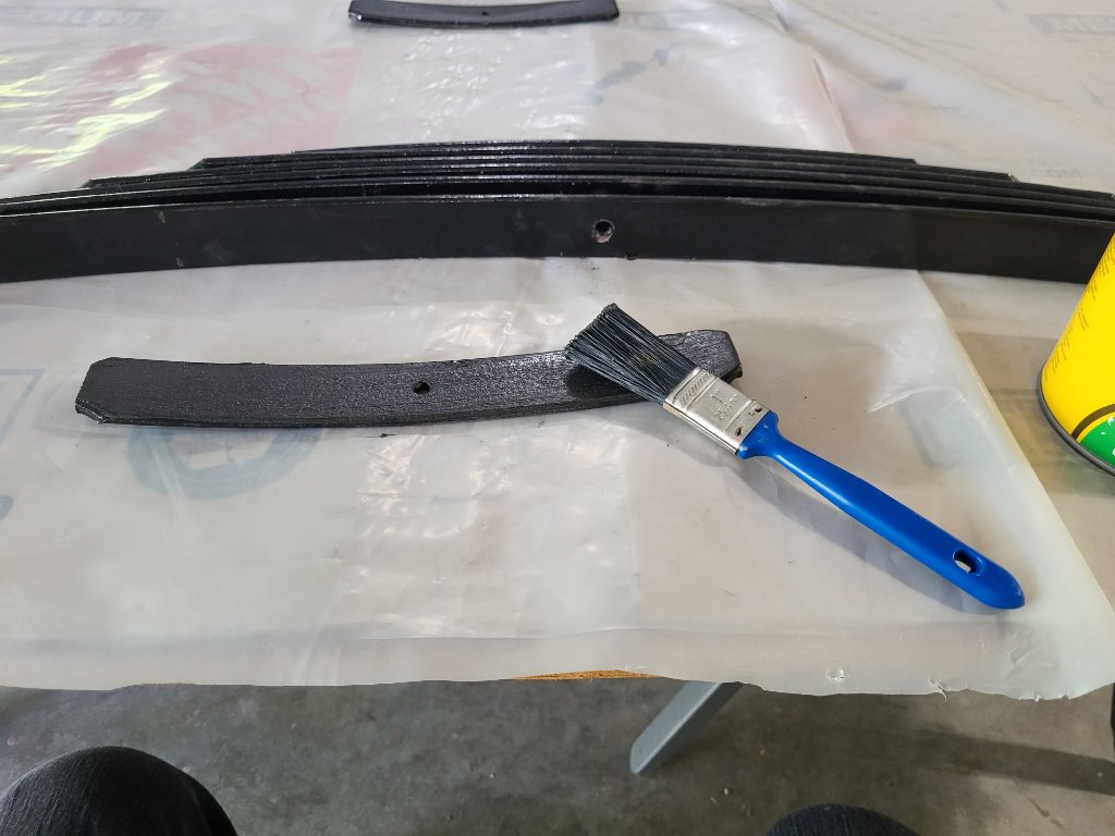

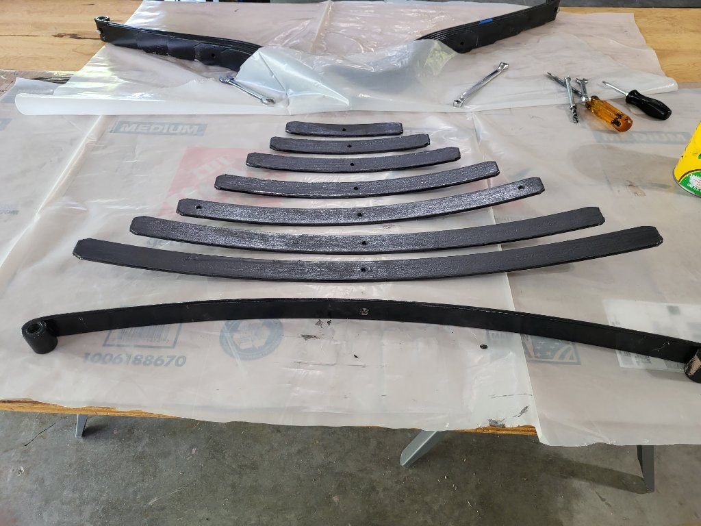

I primed and final coated the springs for my 1927 coupe. Today, I applied Slip-Plate to the entire bottom of each leaf (except the bottom leaf) of the front spring. I have not decided whether or not to coat the top of each leaf.
I reviewed earlier posts about lubricating springs and found that some say to coat just the bottom and others say coat both sides. I thought I would just raise this question again before making a decision.
Comments?
Comments?

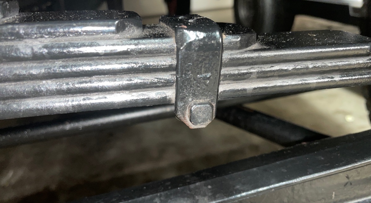

Did my new front springs with Slip Plate on both contact surfaces, then painted over the assembled stack. If a show car I would mask off to 1/4” of each leaf, otherwise that hard graphite paint will fold over the edges and it has to be scraped off, really sticks. As it is slippery, even sandpaper get clogged fast.
My T is a tour car, here is view after about 1000 miles on the new painted front spring. One can see traces on the edges of the shiny graphite. Sure rides better!
