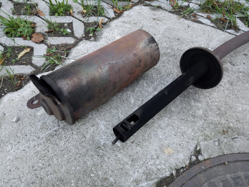

Can anybody help me further? I dismantled the muffler on my Touring 1926, which I want to get running again (original made in Canada). I discovered that the inner tube is not there. I have to make a new one. Does anyone know the dimensions of the pipe and especially the number and dimensions of the through holes?
How can you seal the outer pipe better?
thanks to all
thanks to all

WOW, you have an original Ford OEM muffler-exhaust pipe assembly! That is very rare, particularly in the great condition yours is in. Regarding the dimensions of the middle pipe, I cant help you there, but as to the sealing of the outer pipe to the ends, that is just the way they are, even the repops. Be careful with that one, you will never see another like it.
- Posts: 5332
Re: 1926 muffler not complete
Yes indeed - original mandrel bent pipe ! If you bolt it back together, you should be able to determine the length of the center baffle by measuring the distance between the two center end rings - same with outside diameter - should get you in the ball park.

As has been said, you are very lucky to have a original Ford exhaust pipe and outer muffler shell. You should be able to buy a repo muffler for your 26 T and take the inner shell out of the repo. If the repo inner shell is a little to short or to long to fit tightly it would be easy to extend or shorten the repo as it won’t show when the muffler is put together. If you make your own inner shell make sure to assemble it with the holes toward the engine so that expanding exhaust gas goes back towards engine as it expands into the inner shell then expands again going to outer shell and out the back. I don’t know the hole size or spacing but a few holes around the middle pipe the size of the inner holes should work ok. Maybe someone can post a copy of the Ford muffler drawing showing size and spacing of the holes.

Oh, I'm almost embarrassed by this feedback. I wasn't even aware of this rarity. I'm fairly new to the Model T scene.
I had to do some tweaking on the screw. I hope this will be closed.
The outer tube was rebuilt and is not very professional. I think I'll leave it with the weld seam facing up.
I am amazed by the double-layered muffler ends.....
Creating a suitable inner tube is not a problem. But I have no idea about the drilling.
greetings from Switzerland

If you calculate the area of the "window" openings in the exhaust pipe and double it for the total area of the holes in the inner tube, you should be close enough and the muffler should sound close to original. I don't know if the holes ought to be drilled in a regular pattern or clustered toward one end or the other of the inner baffle.

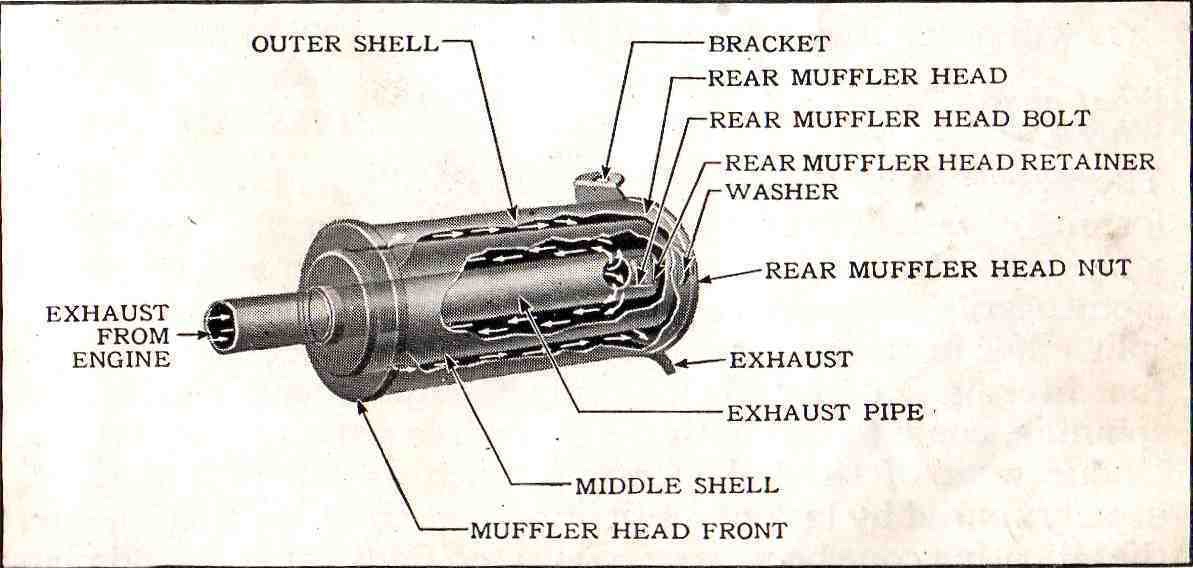

Picture from the Ford US Price List of Parts. 4028 is the muffler shell-middle.

The inner baffle needs to be 1" longer than the outer shell. When assembling the whole thing, you may find it necessary to grind a bit more off the inner, to allow the outer to seat correctly. If the inner is too short, it will rattle. I use a 1 1/4" holes saw to make two holes in the end of the inner shell. It really is not that critical.
At the front end of the muffler, is there a large split pin through the pipe, up to which the front cover is pushed? This is how the Canadians ruled out having to roll the upset ring around the pipe used on US production cars.

Thanks for the information.
No, there is no cotter pin at the front. Tube has a compression ring.

Martin Vowel’s drawings of mufflers show differences over the years and break away/assembly views. Part numbers match the vender catalogues but no dimensions.
https://mtfca.com/phpBB3/app.php/gallery/album/39

Have only one original pipe with the front plate, but it was missing the rear plate, and the shells. Guess I thought too these had a middle shell, just not the tail pipe and outer shell.
Here is a pic from Ford manual, this shows the 'missing' middle shell.
And this drawing made by Martyn

Larry
Trying to fit a new set of repro. muffler shells to your pipe.
The inner shell is 3” x 13” like Les pictured. But the thick fold seam keeps it just bit too big in O.D.
Same with the outer shell, just too big in dia. for a nice fit to the original end plates. May have to revert to fab up new outer or beat some more on the shell rim edges
- Posts: 3949
Success
After some more shaping with the ball pein both ends snugged together with the middle tube in place like original.
Now to find that bolt and locking plate to fit muffler to Larry’s repro tail pipe.
