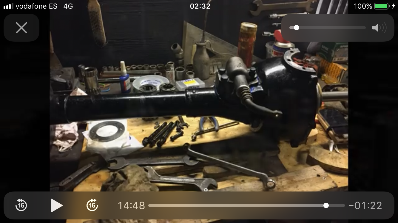

I take my ruckstell apart, pitty that you can not see the ring I meant before.
https://youtu.be/IbOIl8dHq4k
But also another advise, I don't know if you already have but install always Rocky Mountain brakes in combination with a Ruckstell, its a safety must
Regards
Bert

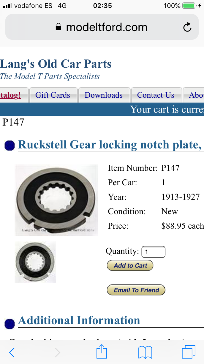

The way I understand the Ruckstell works, the plate P147 is used when in Ruckstell low gear. The high gear locks the internal gear together to get the direct drive. You mention that the high works when in reverse and there is a gear noise when using high moving forward. This could indicate the gear being very worn and slipping then moving forward and operating correctly when moving backwards.
It’s probably the end teeth on the sliding gear and to get there is a 100% pull down. It’s not too difficult, I’ve done about 45 over the years and only had one failure when a pinion gear drive into the Ruckstell bell housing and cut it in half. The cause, no pin in the UJ because it had a modern pinion gear with a collar that slipped. Now I weld them.

Excellent video, truly appreciated, thanks!infotfordnl wrote: ↑Thu Apr 18, 2019 9:18 pmI take my ruckstell apart, pitty that you can not see the ring I meant before.
Regards
Bert
