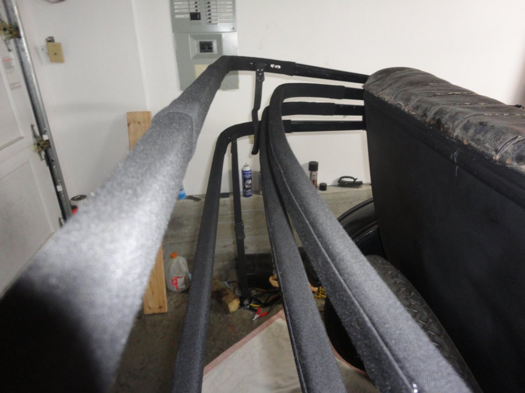

Post by SteveBoothroyd » Wed Apr 20, 2022 10:33 pm
Make sure that the bowdrill is wrapped so that the final seam is on the top of the bow and any tacks are placed on top as well so it will not show when the top cover is installed.
I used some heavy thread and needle to fix a few places where the bowdrill needed some tightening.
When you wrap the bowdrill fabric (on a bias) and have tacked it in place, use a spray bottle of water and dampen the bowdrill, then use a hair drier and dry off the bowdrill completely.
This will shrink the bowdrill and (usually) leave a nice wrinkle free covering showing on the underside of the bows, unless your original wrap is not tight enough.
The attachment DSC01517.JPG is no longer available
The attachment DSC01549.JPG is no longer available
The attachment DSC01523.JPG is no longer available
The attachment DSC01525.JPG is no longer available
