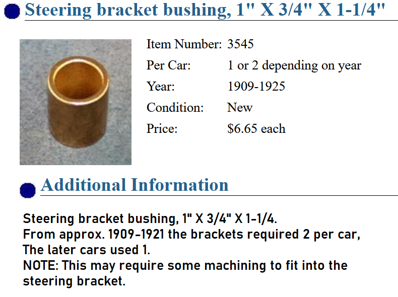

Lang's sell the following Steering Bracket Bushings

It's been a long time since I changed a bushing there but I seem to remember that on my '10 there was one long bushing that I replaced with two bushings. Am I just misremembering or was there yet another variation?
Posts: 6710
Re: T932B Lower steering bracket variations
Post by Scott_Conger » Sat Sep 03, 2022 10:40 am
You remember right, Val

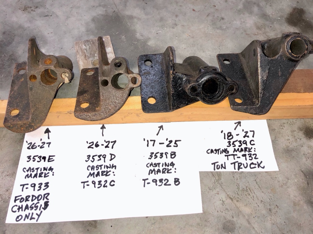

Various styles of steering frame brackets with part number and factory number that is the numerals marked on the castings.

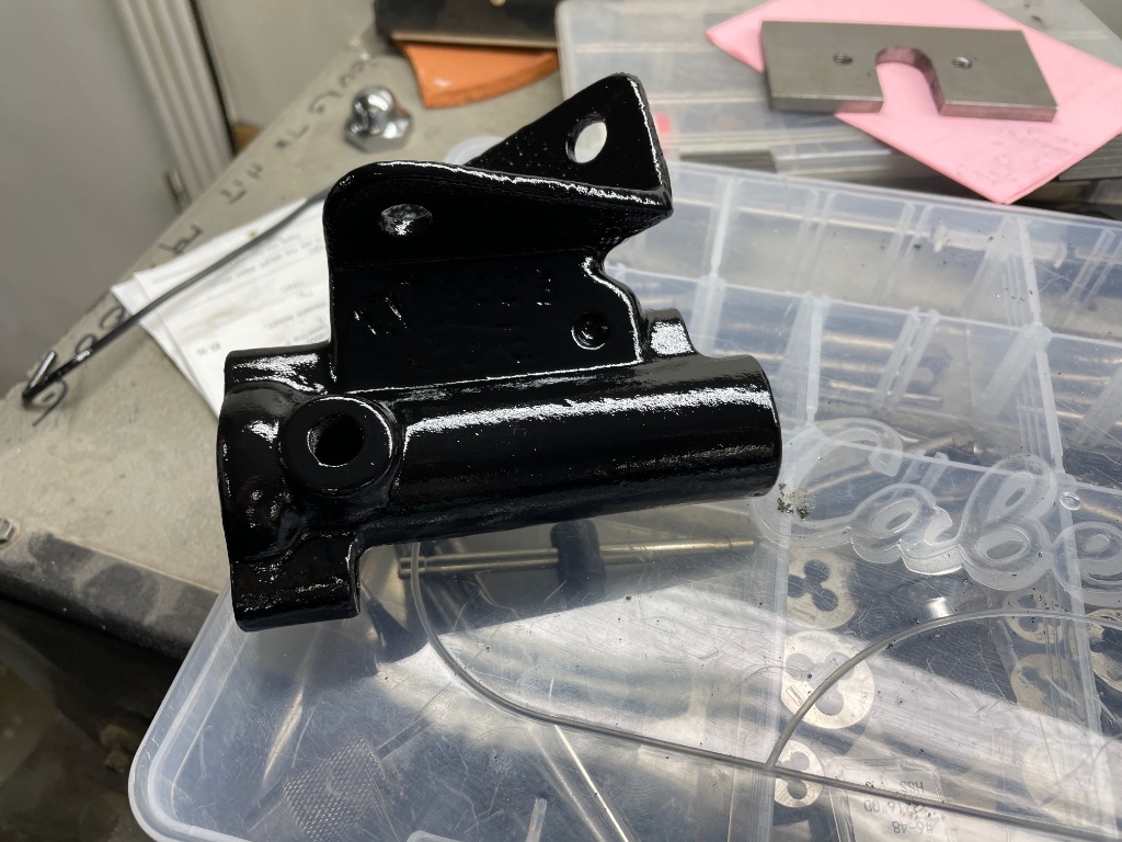

Bushing installed and reamed, bracket painted and ready to install once the paint dries a bit. I am soaking the wood mounting block in molten paraffin before it goes back in. Preserves the wood and keeps it from soaking up water.

The T-932-B Steering Gear Bracket is only used on 1911 though 1925 cars (and 1926-27 bare chassis). It’s predecessor, T-932, is used on 1909 and 1910 cars only. The principle difference between the two steering gear brackets is the angle of the Steering Gear Shaft bore. The ‘09-10 bracket angle is 42 degrees 56 minutes while the 1911 and later brackets have a slightly shallower angle of 41 degrees 26 minutes. Consequently the two brackets are not interchangeable (without modification).
In addition to the slightly steeper angle of the T-932 bracket it can also be identified by the absence of the boss for the grease cup. This is clearly shown in the picture above. The boss was added in June 1910 and the T-932-B was introduced about 6 weeks later. So almost all steering gear brackets for 1909-1910 cars lack the grease cup boss.

Thanks for your details on the brackets. My photo just depicts the common types found, and I left the ‘17-‘25 dates on that bracket as the earlier ones have more unique markings as some are raised embossed in the castings, making ‘11-‘16 just exceptions for real authenticity, as you noted they all have that later angle.
