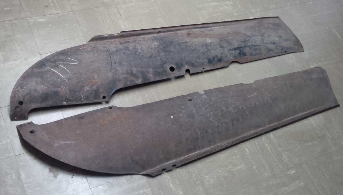

Here's a pic from 2017, which partially shows what they look like.

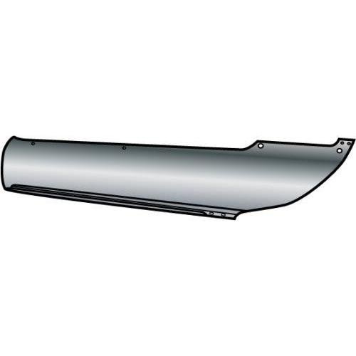

Here's the drawing from Snyder's catalog.

Re: Center door splash apron
Terry,
If you have this style on your Centerdoor, then there IS a difference between Touring/Roadster and Centerdoor running board shields
