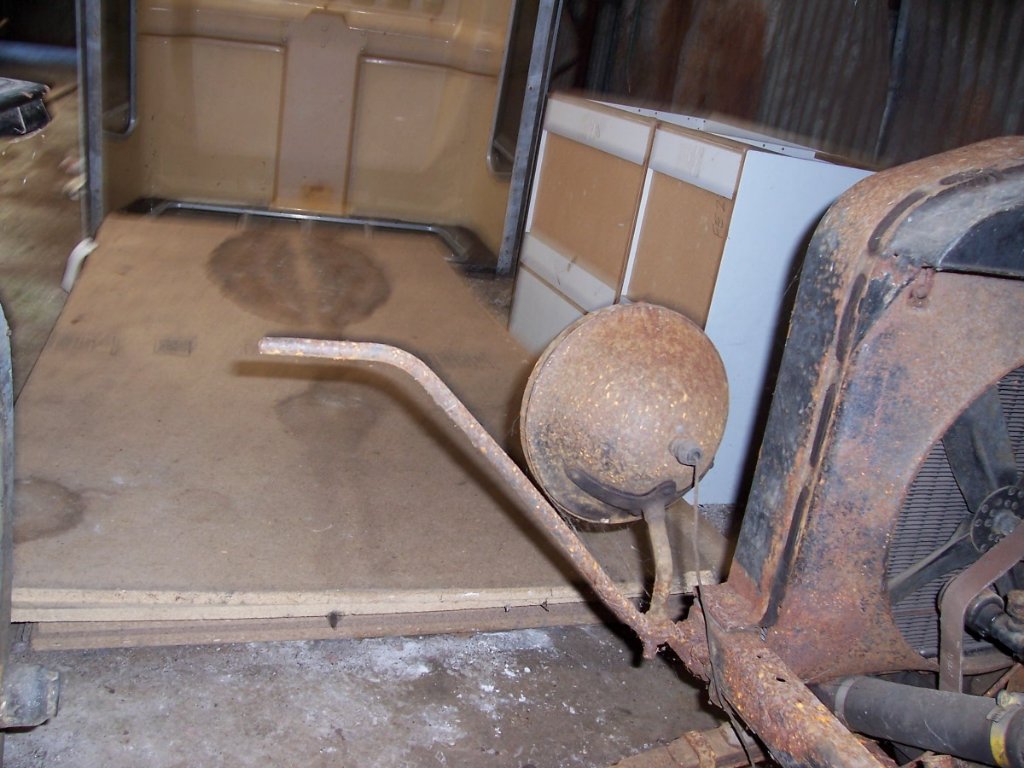

Here's an all original 1917 shroud - quite rare !

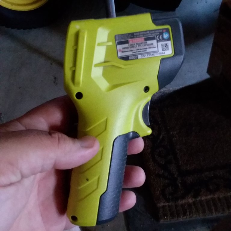

HEAT
I use an infrared thermometer to look at the radiator.
It shows 130's at the bottom, and 170's to 180's at the top after shutting down from a ride. Cold water settles to the bottom of the radiator.

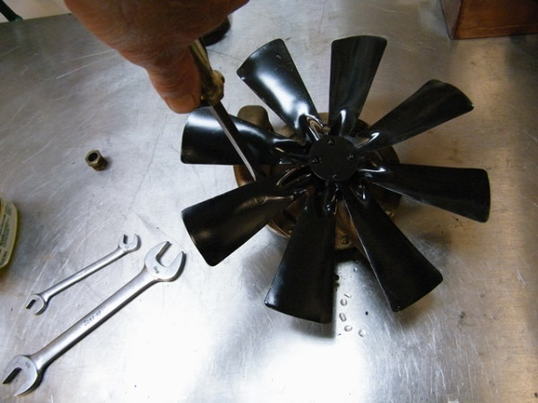

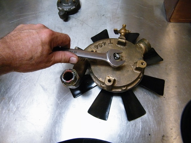

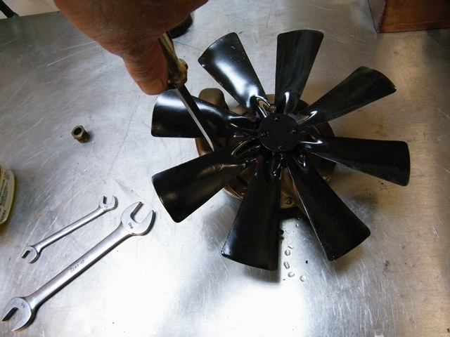

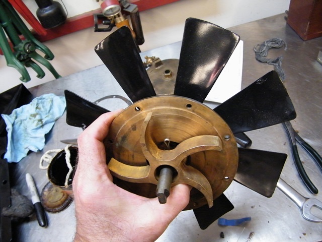

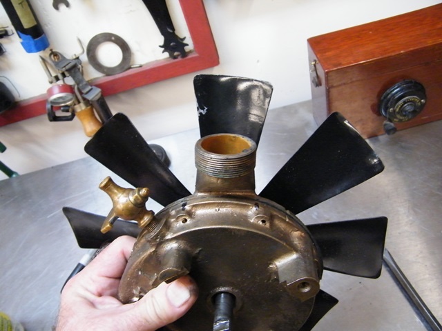

I read in Bruce McCalley’s Model T Encyclopedia that in 1909, water pumps were applied at the factory to the first 2,500 cars, so it is possible that having a water pump on your year T might be deemed authentic for a privately owned car of that vintage since it is possible that an early owner might have recalled this and determined it was a good idea for him, his circumstances and his car and that 1913 is recent enough to 1909 that Ford dealers may have still carried the water pumps in stock, so *you might want to try and find an early original style water pump. In the early years, the radiators were much smaller than in later years, so naturally, the early ones were not as efficient at cooling the water using the term-siphon system, which was not fully developed in 1913.
*Having found pictures of an original 1909 water pump, it may or may not be possible to utilize one on a post 1909 T, but it is interesting to look at.
Pat’s great suggestion to remove the license plate from the front of the radiator reminded me that, back in the day, there was an accessory that was guaranteed to to cause your T to boil over though it was meant to help. Look at how much radiator area it covers that prevents the flow of air. If you have one, remove it and display it on your garage wall instead of on your T.
Jim Patrick

Water pumps...
If you consider where the impellers of Model T water pump are, you might realize that they cannot move coolant where the fluid level is lower than the impeller. They are nothing like a modern water pump in a pressurized system. All they can do is push coolant that is delivered to them via thermosiphoning action.
Theses have a purpose to assist in airflow around the engine and thorough the louvers of the hood by creating a negative pressure zone.
Water pumps...
