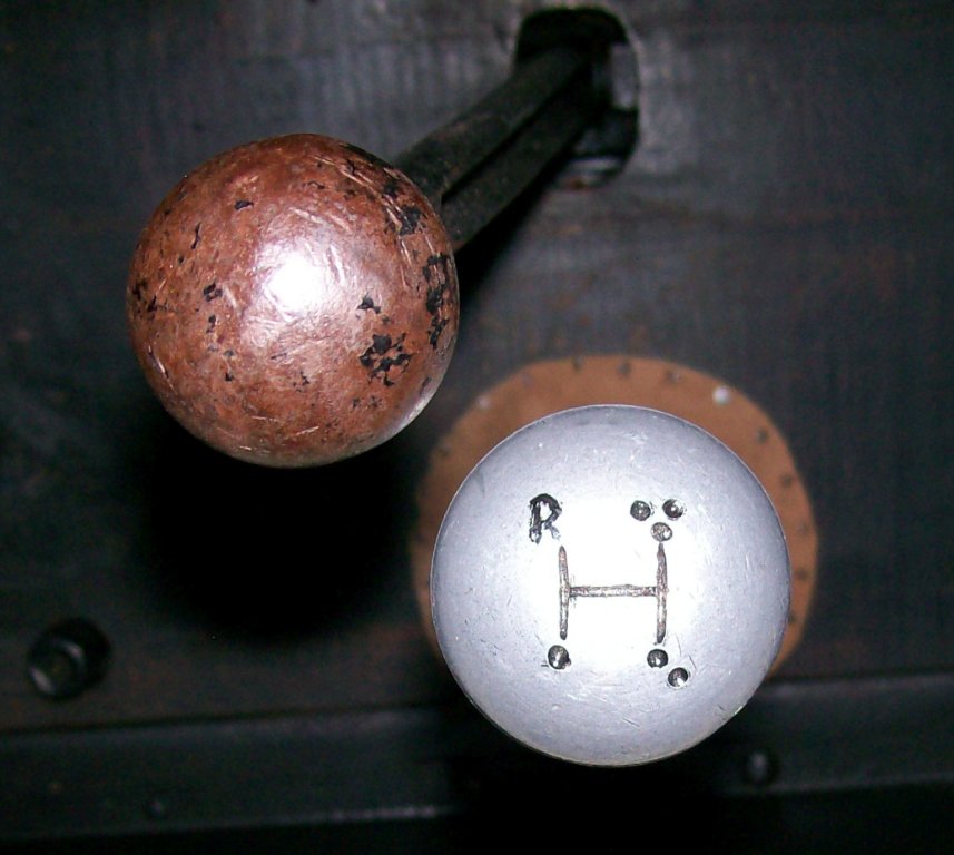

This is from my files and notes on my Muncie gearbox / transmission which is a 3 speed (low, direct, overdrive) with reverse. Here is the information gathered up and in one place. One of the pictures is of the gear shift knob I cut the shift pattern with a Dremel tool. Instead of numbers I drilled one hole for first, two holes for second, and three holes for third, that way I can feel the shift knob and know where the gears are without looking. Sort of reverse brail.

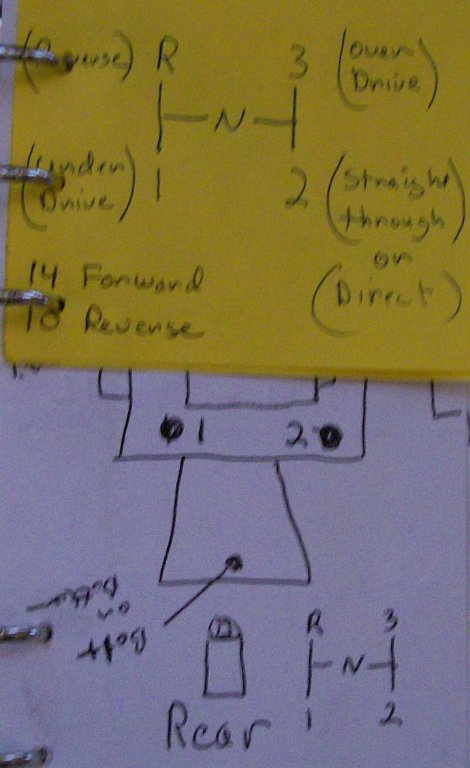

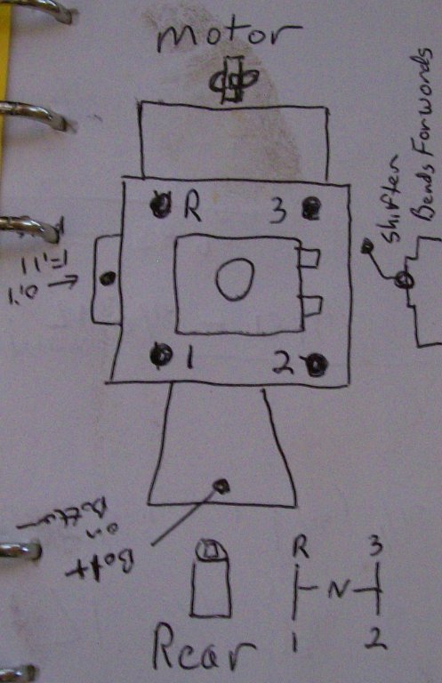

Sorry for the bad drawings, just from my notebook.
Also on the gear shift pattern the number of forward gears and reverse gears is because I also have a Ruckstell 2 speed rearend.
One of the pictures is of the gear shift knob I cut the gear shift pattern with a Dremel tool. Instead of numbers I drilled one hole for first, two holes for second, and three holes for third, that way I can feel the shift knob and know where the gears are without looking. Sort of reverse brail.
