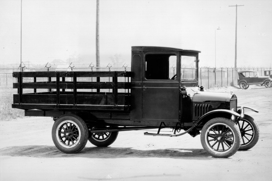

The photo shows the truck in what looks to be great condition. If you find loose spokes or bent frame, you can use either/both to adjust the asking price.

I appreciate the great information so far, unfortunately though the attached photo is just a factory publicity photo for reference. But it looks very similar to the truck in question, which has no metal stakes.

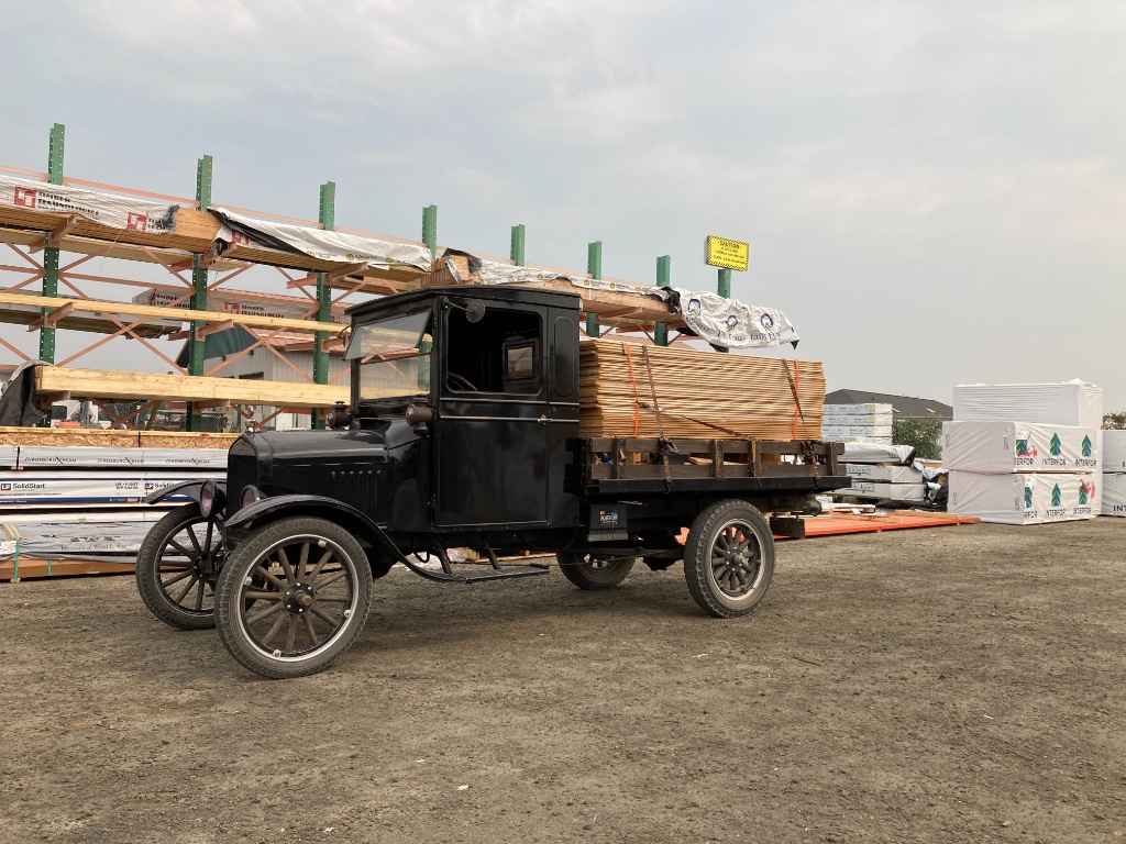

My 26 sounds similar to the truck in question. With work and diligence,
I have made it a reliable brute that sees regular use as my work truck throughout
the good weather months. It will cruise all day at 35, and tops out at 50.
Last week, hauling a unit of 3/4" T&G plywood back from Idaho, where I
was able to buy the material for $10 a sheet cheaper than I could locally.
My modern could not possibly haul this much weight.
