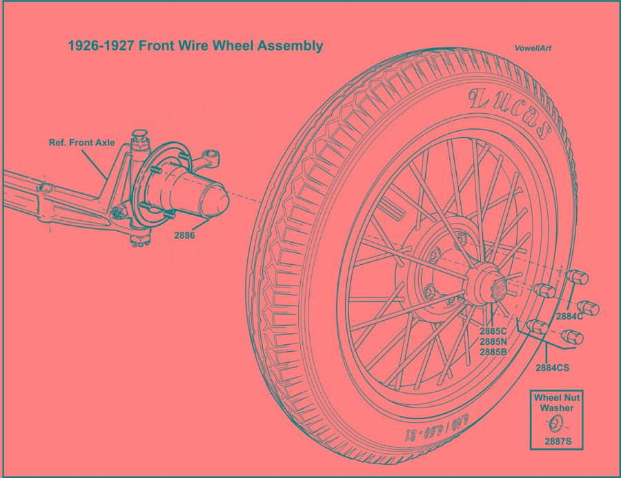

I looked online and it said to torque modern lug nuts at 80 to 100 lbs. That is how much a pneumatic lug wrench would tighten them. This said, I would tighten them “good n tight” like suggested before, but not necessarily THAT tight. The below drawing shows that there should be a cone shaped washer (#2887S) with each lug nut to prevent damage to the powder coat. A little grease under each lug nut washer might prevent them from damaging the powder coating. Jim Patrick
