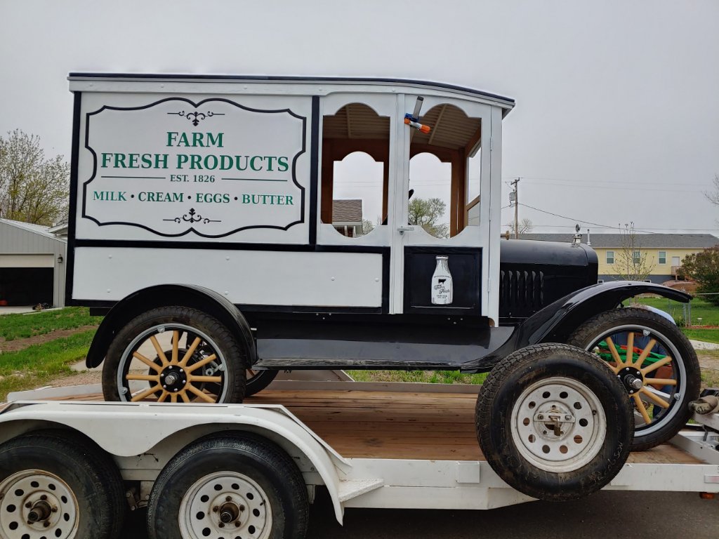

The Colorado DMV required a VIN inspection on our Milk Truck. Appointments are required and are filled for a minimum of 6-8 weeks in advance. Yesterday I took our '27 Milk Truck Delivery for inspection yesterday. I was denied/failed inspection based on ONE thing: WOOD BODY. The Colorado State Patrol does not believe a wood bodied vehicle is safe to drive on the road. Thus, a wood bodied vehicle is NOT Road Worthy. This is a Currier Horseless Carriage body approximately 3 years old.
I was offered a "Rebuilder's approval". This allows a person to obtain a title but NOT any type of license plate. The vehicle would have to be hauled to any/every event and could NOT be driven on the road, even in a parade. In order to obtain a full VIN/Road Worthy inspection, we will have to find an Automotive Engineer who will certify the vehicle for Road Worthiness. I'm sure ALL of us here, have a direct line to an Automotive Engineer for such a certification. All of this to get a Collector Series plate that limits driving on road to 4500 miles per year.
I am unsure if the windshield is safety glass or not. This will be addressed by a competent Glass company and replaced if necessary, All the lights work. The tires are good, and the truck is in very good to excellent condition and has Rocky Mountain Brakes to boot. The body is properly assembled, mounted, and tight.
Anyone know of an Automotive Engineer in the Denver, Colorado area?
Looks like NO license until at least next year.
Is this how the government is going to push us OFF the roads?

Understandablemtntee20 wrote: ↑Sun Sep 11, 2022 9:07 amThis may well be the shape of things to come.
You have - essentially - a 3 year old vehicle that has
a body made of wood.
It doesn’t meet current safety requirements
to be traveling on shared public roadways.
FJ

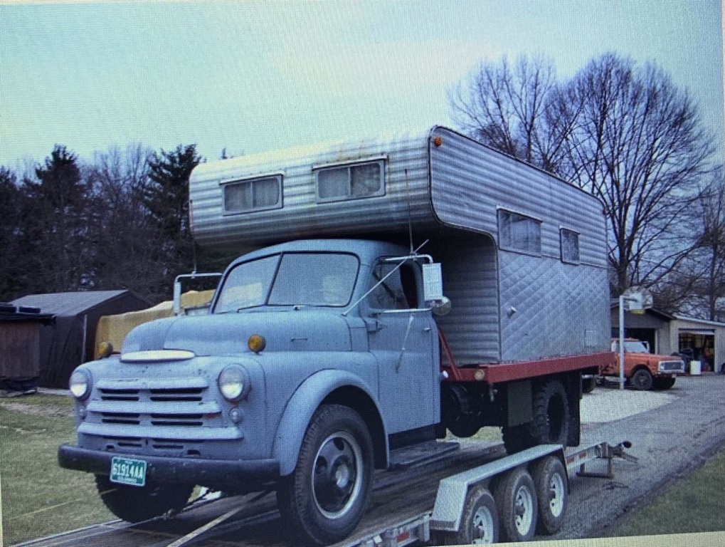

The bodies of most straight Trucks are Aluminum sheeting over a wooden structure. The last time that I checked, the driver of the straight truck rides in the same vehicle with the wooden body. I presume that these vehicles are also prohibited in Colorado. Talk about stupid!

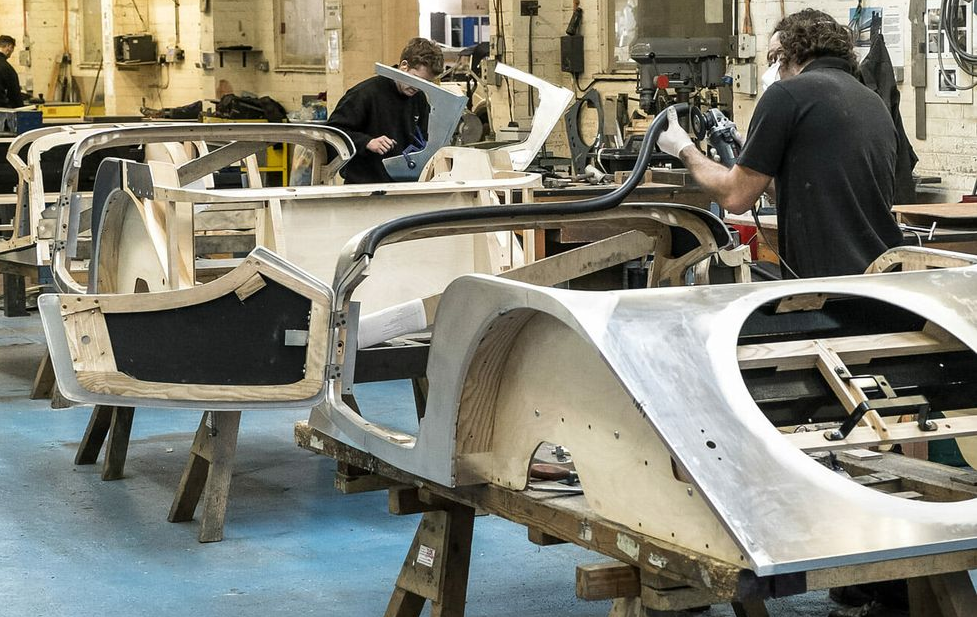

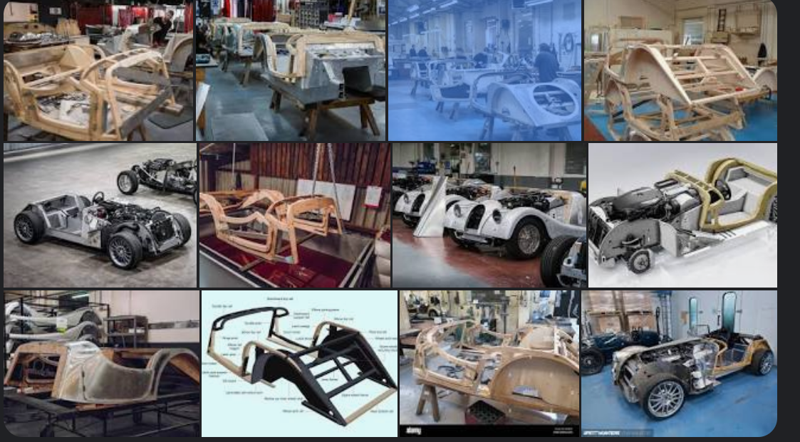

Ask the DMV why they have Titled any MORGAN Motor Car's, they were and still are wood framed and aluminum skinned
Video of a Morgan Build https://www.autoweek.com/car-life/class ... from-wood/
There are several Morgan Dealers in Colorado hers one in Denver https://fblod.com/showroom/current-range/morgan/
Imagine if the Morgan Dealer's in Colorado found out that you were going to take the issue to court, I'm sure they would help you get a variance

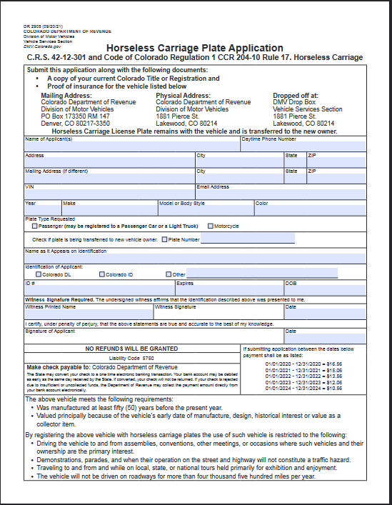

You may have a legal right to register the car. It appears that there is a provision for a Horseless Carriage Registration in Colorado. So that is the "law" then there must be a way to Title it
The fact that the Colorado State Patrol does not believe a wood bodied vehicle is safe to drive on the road is a feeling not the law.
Now you do have a problem in that the body is not a true Ford so you'll need to get some old photographs to meet the requirements...
The above vehicle meets the following requirements:
● Was manufactured at least fifty (50) years before the present year.
● Valued principally because of the vehicle’s early date of manufacture, design, historical interest or value as a
collector item Not sure what yourIn the end you may need a lawyer
https://dmv.colorado.gov/sites/dmv/file ... 5_2021.pdf
