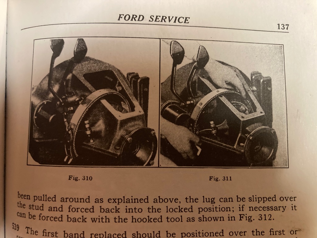

I’ve changed a few sets of bands by removing the hogs head. I want to try to do a set through the hole. I have detachable ears. I will try on my ‘24 or ‘22 and they do not have newer larger brake drum. The one car just needs brake band the other needs all 3. I’ve been told it’s too hard, it will distort the bands, I need to feed them in front of reverse and then pull them in place, feed them behind brake drum and then move forward, you can feed in cotton bands, but can’t do Kevlar. All maybe true, but looking for words of advise from someone that has done it a few times. The service manual said it should only take 40 min.

Can any one do it like Joe Snow? This was in 1924 with the removable band ears. You can do it in 30 mins or less!
