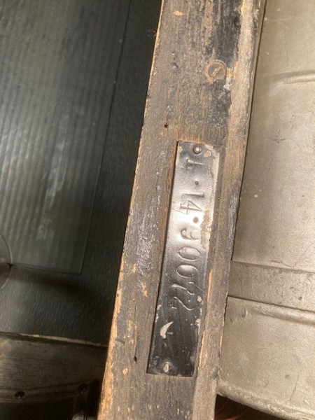

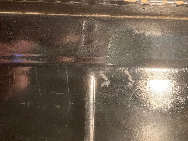

So here is where we get to the questions. We really went over every inch of the machine this weekend.
Our registration says, and, fenders, body details, radiator attachment hardware, pedals, etc, all lead me to believe this is a 1914 Model T Serial Number 500xxx, made in April of 1914.

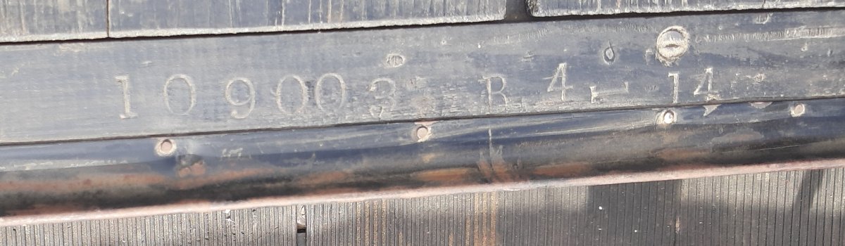

But, under the seat we can see the following, 109003 B4-14.

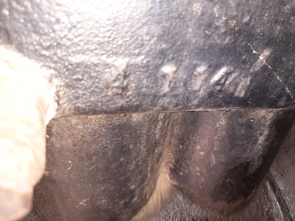

Now, here's a number on the rear of the head

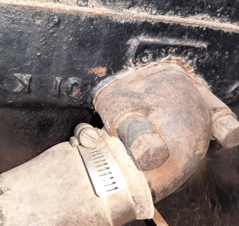

And here is the area above the cooling elbow
All I could really make out is, well, looks like at one time there were a bunch of zeroes there above the fitting.

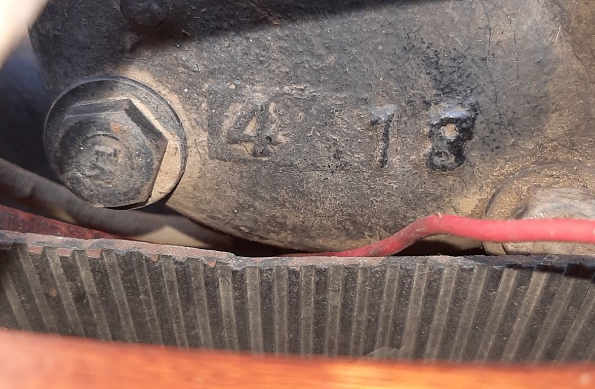

To the right of the cooling elbow is the only other number
There it looks like 4 7 14.

The number under the seat is most likely a BODY number put in by the body manufacturer. Since a majority of bodies were purchased by Ford for the Ts, the manufacturers needed a way to keep track of them, so they stamped in their own numbers. These numbers have significance IF you can ID the manufacturer AND find that manufacturers appropriate number list/information.
The casting date on your BLOCK appears to indicate April 7, 1914. Too bad you are unable to read the number above the coolant inlet elbow. THAT is the VIN for the vehicle. Much later, I think about '23 or so, Ford did stamp that VIN number into the frame as well as on the block.
You may or may not be able to gently sand off the paint, rust, and crud enough to be able to discern the numbers after removing the inlet elbow. Maybe not. But, it's worth a try to get the exact number and thus the exact build date.
In today's world, VIN numbers are LONG. IF you are unable to read the number off of the inlet pad, you might consider using the BODY number as the VIN. While it's NOT proper, the DMV nuts will love it.

Model Ts are dated by the serial number stamped on the block, just above the water inlet.
The embossed date to the right of the block is the date the block was cast.
I have always believed that the numbers embossed on the head are month and day the head was cast.
Body numbers were stamped by the respective body manufacturer. They do not match the motor serial number. Depending on the manufacturer, they typically include the month, day and year. I believe the "4 -14" on your body stands for April 1914.
You have nothing to worry about.

My "w.a. guess" is it's a Beuadette body, '14 casting date, with a later head. Not uncommon. Like Terry said, too bad the "serial number" above the inlet pipe is so hard to read. That's the number for your title. And as I also recall, body numbers began to be stamped on frames either very late '25, or in '26 models til end of production.

Just maybe you could read the vin number over the water outlet on the block if you removed the outlet fitting and slightly sanded the area to pull out the original numbers since they are on the papers you have. As far as changed parts the modern water hose clamp is new to this T by about 40+ years.

The body manufacturers serial numbers seem to be pretty much useless for dating or tracking body dates. The date codes are probably the best you can get, and they only provide a timeframe.
