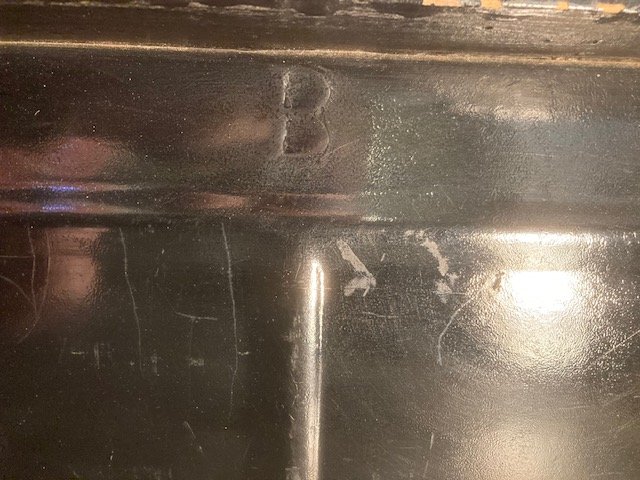

But, under the seat we can see the following, 109003 B4-14.

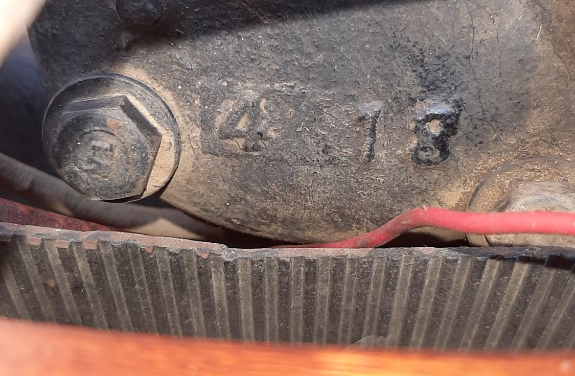

Now, here's a number on the rear of the head

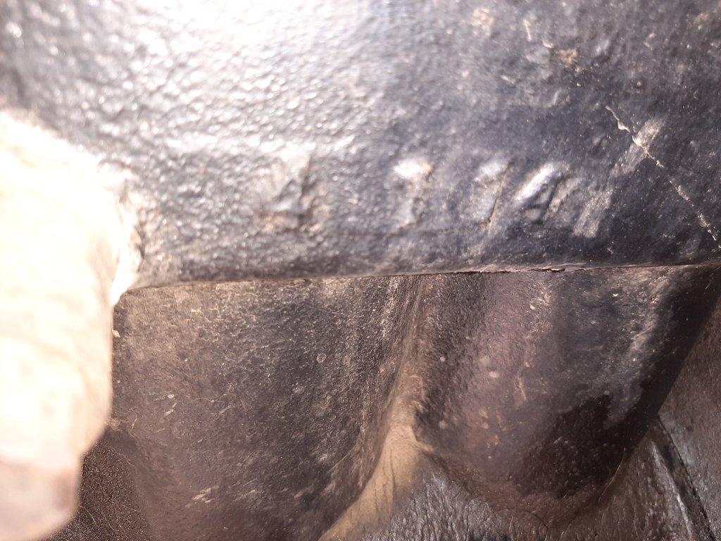

And here is the area above the cooling elbow
All I could really make out is, well, looks like at one time there were a bunch of zeroes there above the fitting.
To the right of the cooling elbow is the only other number
There it looks like 4 7 14.

The number under the seat is most likely a BODY number put in by the body manufacturer. Since a majority of bodies were purchased by Ford for the Ts, the manufacturers needed a way to keep track of them, so they stamped in their own numbers. These numbers have significance IF you can ID the manufacturer AND find that manufacturers appropriate number list/information.
The casting date on your BLOCK appears to indicate April 7, 1914. Too bad you are unable to read the number above the coolant inlet elbow. THAT is the VIN for the vehicle. Much later, I think about '23 or so, Ford did stamp that VIN number into the frame as well as on the block.
You may or may not be able to gently sand off the paint, rust, and crud enough to be able to discern the numbers after removing the inlet elbow. Maybe not. But, it's worth a try to get the exact number and thus the exact build date.

Model Ts are dated by the serial number stamped on the block, just above the water inlet.
The embossed date to the right of the block is the date the block was cast.
I have always believed that the numbers embossed on the head are month and day the head was cast.
Body numbers were stamped by the respective body manufacturer. They do not match the motor serial number. Depending on the manufacturer, they typically include the month, day and year. I believe the "4 -14" on your body stands for April 1914.

My "w.a. guess" is it's a Beuadette body, '14 casting date, with a later head. Not uncommon. Like Terry said, too bad the "serial number" above the inlet pipe is so hard to read. That's the number for your title. And as I also recall, body numbers began to be stamped on frames either very late '25, or in '26 models til end of production.

Just maybe you could read the vin number over the water outlet on the block if you removed the outlet fitting and slightly sanded the area to pull out the original numbers since they are on the papers you have. As far as changed parts the modern water hose clamp is new to this T by about 40+ years.

Ford at that time was moving very quickly from casting to machining to assembly. An April first or seventh block or April 18 cast head could easily have been on a late April assembled car. Blocks have been confirmed that made it from casting to assembly in a week, and heads could be done even more quickly because much less machining and QC was required for them.
The body manufacturers serial numbers seem to be pretty much useless for dating or tracking body dates. The date codes are probably the best you can get, and they only provide a timeframe.
Those date coded serial numbers were originally used for billing and quality control issues. Apparently, nobody kept or tracked the numbers much beyond the car being sold new. We tried a few years ago to collect a data base of date codes and serial numbers for the various manufacturers. Along with additional known information about the cars the bodies were on, we hoped to get a good timeline for the serial numbers. But not nearly enough people responded with useful information, and the effort ended.
Your body might be usable for a DMV serial number if necessary. However, it would not be proper. And you would run the risk (statistically small) of that number being duplicated by some other car somewhere in the country, Ford or otherwise. Read the current thread on troubles with a serial number in Tennessee. It actually happens fairly often. I know someone with a 1917 White touring car with a serial number duplicated on an unrelated car in another state. Consider the simple fact that later model A Fords duplicated model T numbers up to about five million, along with all the Buicks and Chevrolets and a dozen other companies all over the country that used simple numeric serial numbers. Duplication has to happen.
If you have a proper family transferable title for the car? If you can avoid (in your state?) having the number verified? Best to avoid it. If necessary, CAREFULLY clean the pad on the block to see if the original number can be read. It MIGHT help to carefully file the surface to remove surface damage and help reveal the original number. This can often work, HOWEVER it can also cause serious problems if the DMV wants to suspect you of trying to alter or hide something!!!! Sometimes they look for something over which to cause trouble!
