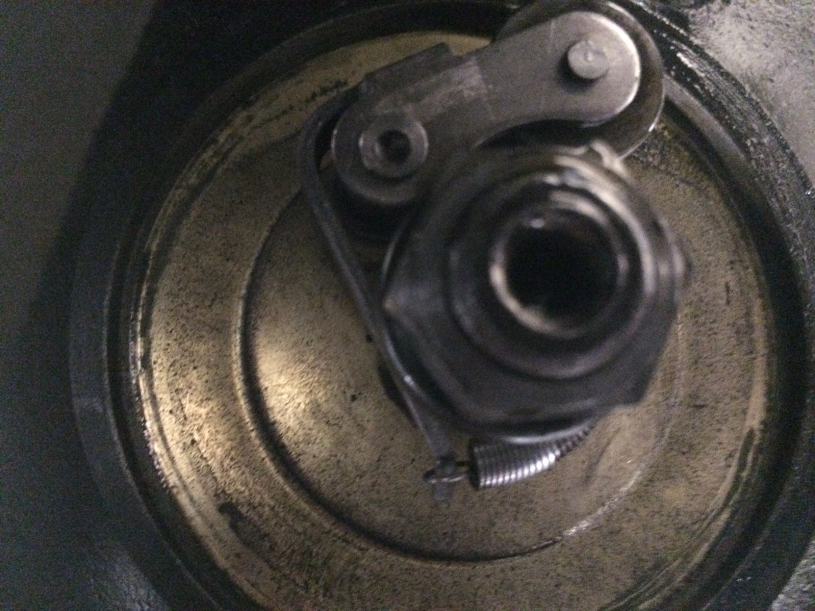

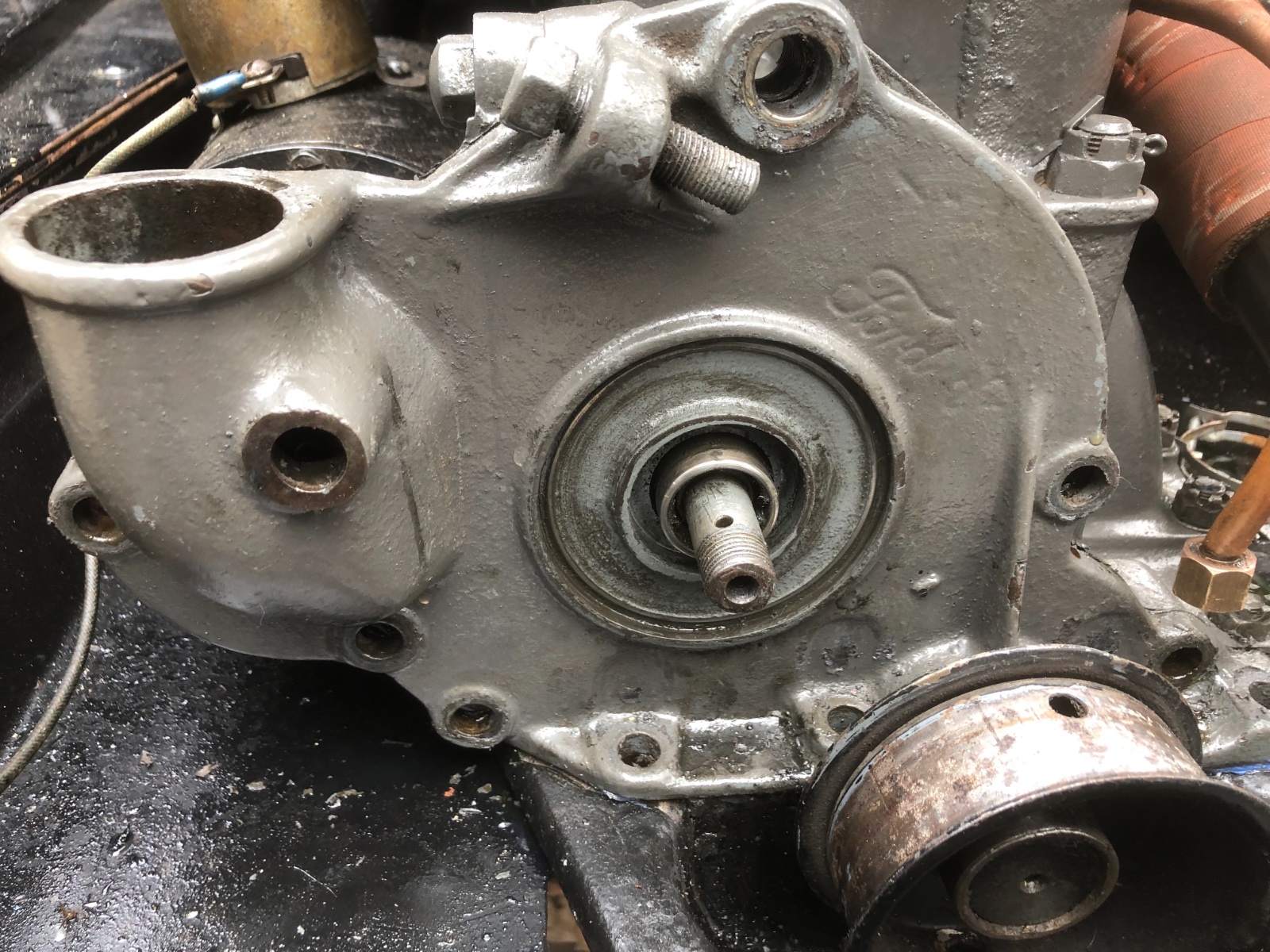

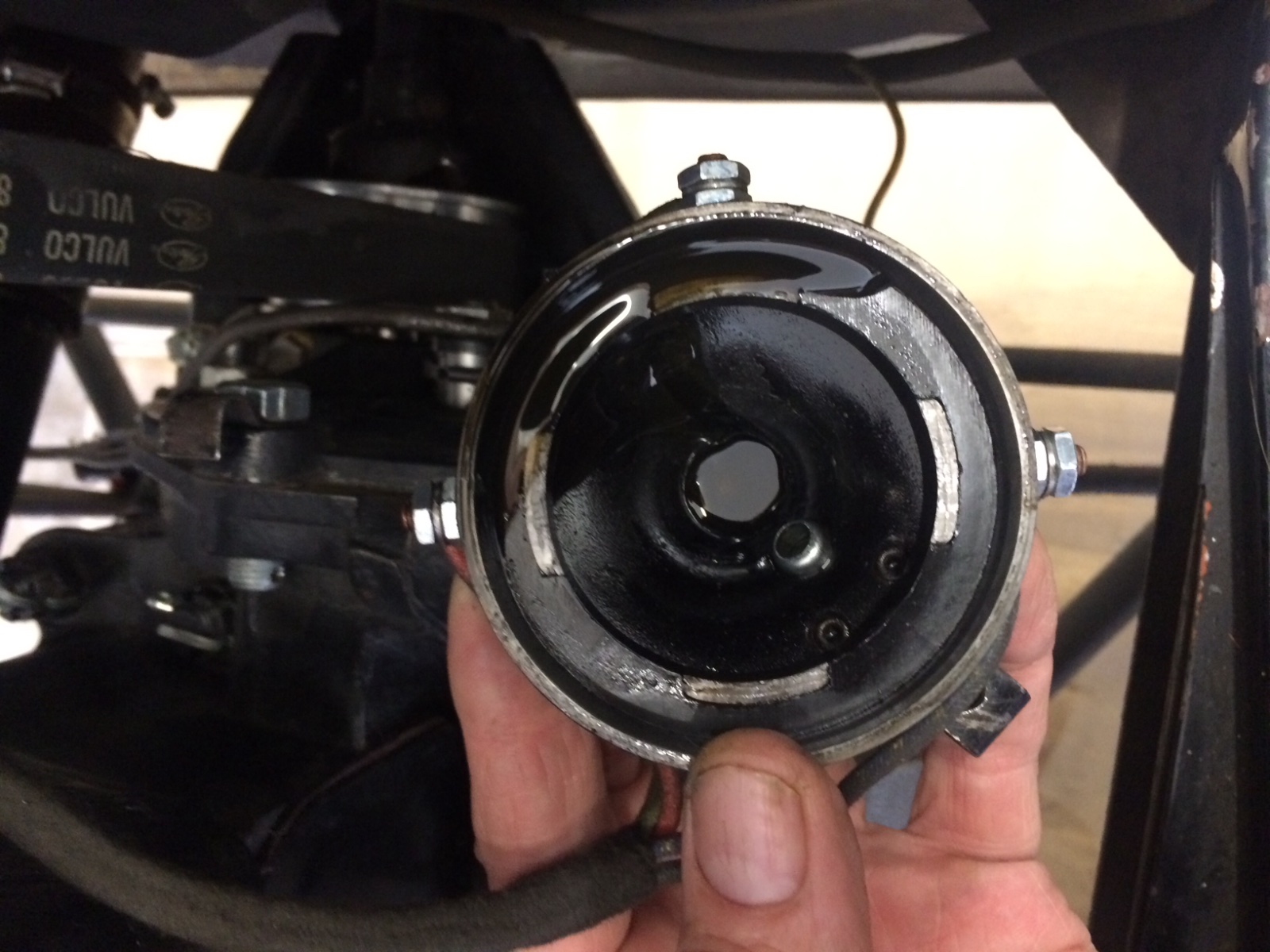

Thanks Scott, I’m not sure which one it is,I’ll have to post a picture tomorrow

Well, you have an original style timer that is getting oil weeping from the engine if that is old oil I see in there. If you want, you can give a couple shots of clean oil in the oil cup that I think I see on the timer cover.
Once a year open it up, wipe it down, give another shot of oil on moving parts and close it up and then every few hundred miles, give a shot of clean oil. Since it's open now, start the wipe/lube regimine today.

Steve that was clean oil I squirted in the oil cup, it seems to run well for about 30 miles, then starts running rough. I’ll clean it and try adding STP with the oil, thanks guys

It is nice to see the original metal seal shield in place. Behind it is the felt seal that keeps most engine oil out of the timer. When you think you need to, all you need to do is remove the roller assembly, lift out the brass shield and replace the felt...reassemble. Don't lose that shield. The repros are mysteriously the wrong dimension and cause no end of trouble.
I find it hard to believe that your timer will work for 30 miles and go south, only to get better with fiddling. I would more likely look for a loose "flag" connection on the 4 wires attached to the timer that needs resoldering, or that you are shorting out on a bolt coming up out of the crankcase/pan. The bolts should all come UP through the pan with a castle nut on top of each one EXCEPT for the bolt directly below the timer...that bolt should face DOWN with the nut on the bottom. This keeps things clear from shorting out. Another suggestion is to ensure all 4 coils are rebuilt properly and set to run as a set of 4.
Finally, if you are convinced or true evidence points to a bad timer (loose/worn roller which makes timeing quite variable or a rough surface on the bakelite/contact track which creates hopping of the roller), my preference is an Anderson or ANCO timer. It is a reproduction of a Period accessory timer which I have put many many miles on. With ANY timer change you may have to reset your timing slightly by bending the timer rod. You can GOOGLE that by "MTFCA timing adjust".

Thanks again Scott, it’s a brand new wiring harness, it’s not grounding out at the bottom. Brand new coils and wood box as well. The number one cylinder seems to not be firing right after a short time. I move the coils and it is still number one. Engine is a new rebuild, checked compression all equal and good. It’s a new timer and cover, I may try the timers you mentioned. Thanks again
