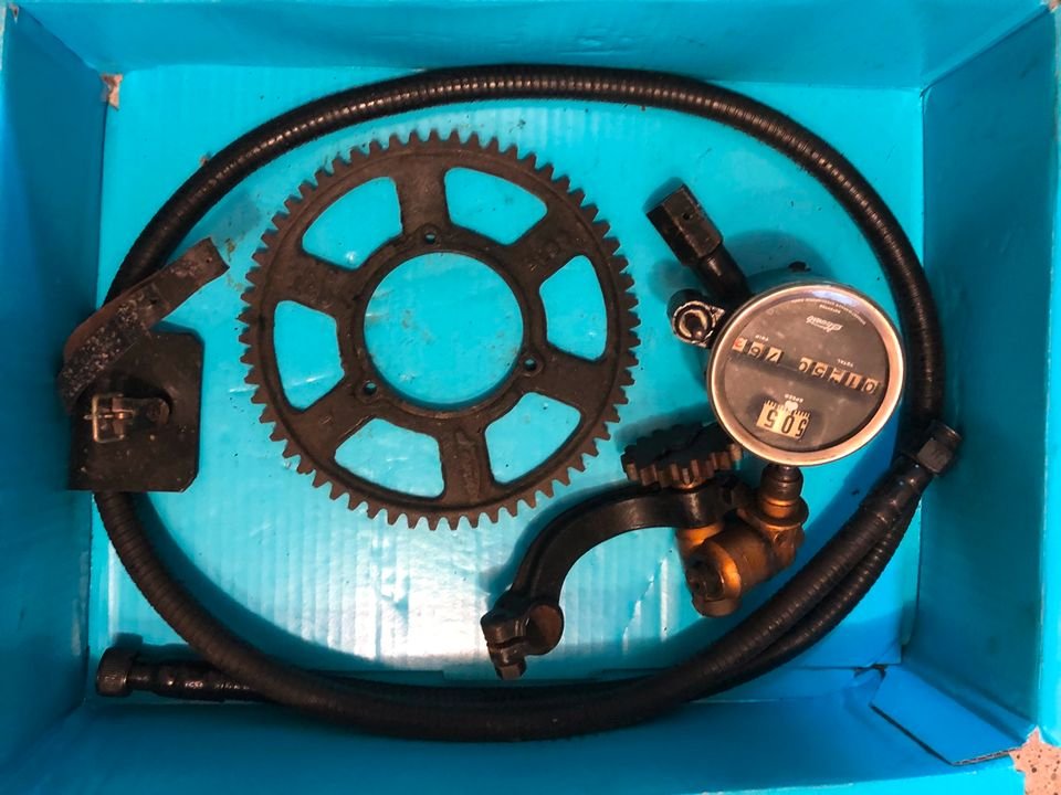

Hi
Can anybody help me further? I would have the opportunity to buy a complete set with Steward speedometer and drive.
Question 1:
Would this set be timed correctly for my 1926 Touring made in canada?
Question 2:
The speedometer shows miles. I live in Switzerland and we know the Km/h specification. Is there a way to convert the speedometer to get the information in km? Did that exist back then?

Beat,
From the photo of the box of parts you purchased, the road gear (#8586) is not going to give a correct reading since is it for a 30X3 1/2" tire and it is for use with the Model T machined hub. You need gear # 30333 or 31376. Stewart did make a KPH Model 160 speedometer (I have one) and the odometer gearing is quite different from the MPH speedometer. The cable you need for your car needs to be 66" long and the speedometer dash mount must be the 1926 style, setting the speedometer away from the gas tank. The speedometer in the box does not have this bracket. Also, the swivel must be a Model 1913 to work the setup properly. I hope all of this makes sense, and if you need any further assistance, you can contact me at 1stnow@msn.com. Russ Furstnow

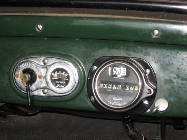

Here is a picture I found online in a 2010 MTFCA posting by Jim Wilson of Amory, MS showing his Stewart 160 installed in the dash of his 1926 roadster. Notice the angled adapter that positions a good deal of the speedometer out from the dash so it will clear the cowl fuel tank behind the dash. If you were able to see it from the side you would see that the adapter is about 3/4” or so thicker at the bottom than at the top, which serves to angle the back of the speedometer downward and tilts the front up. These adapters are not easy to come by. Jim Patrick
