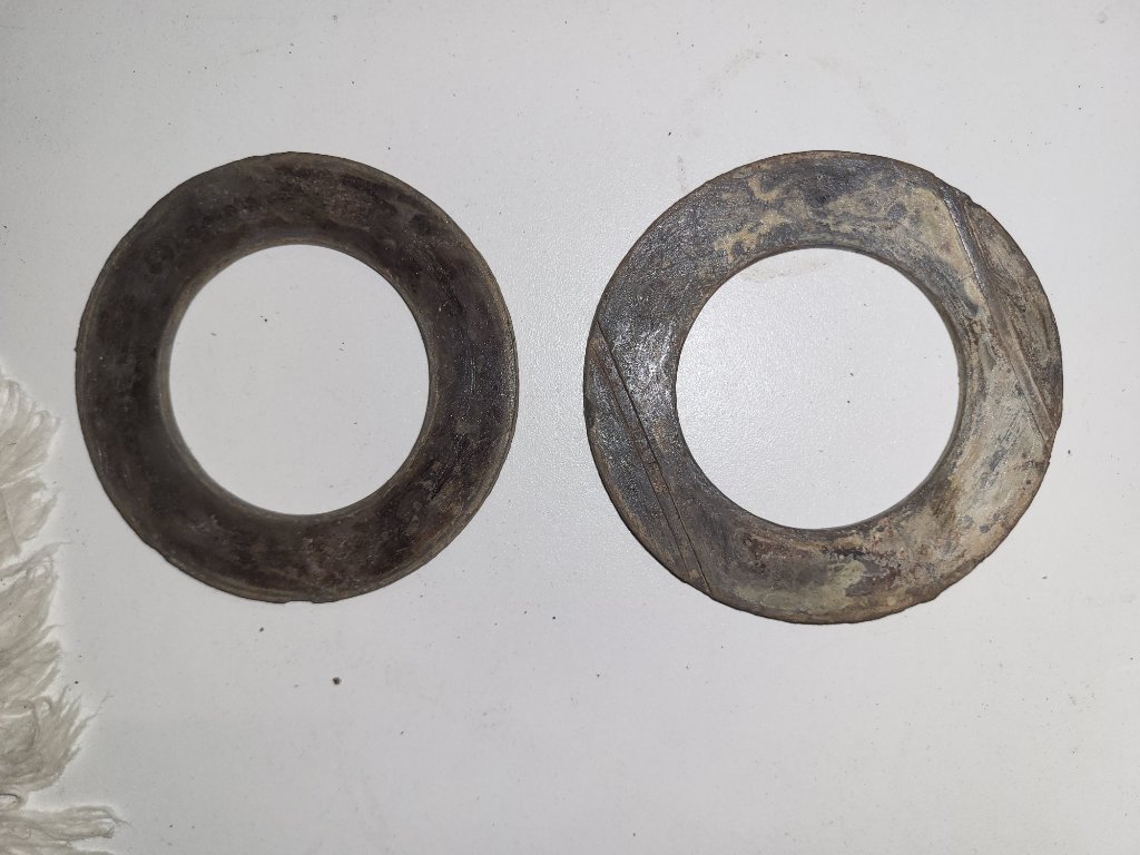

Babbitt Thrust Washer Photo
I thought I would share a photo of the babbitt thrust washers we found when rebuilding the rear axle. I was fortunate they were in so good condition.
- Posts: 4694
Re: Babbitt Thrust Washer Photo
Don't re-use them. The y tend to crumble and then you have problems. Replace with bronze. You might want to keep them for "show and tell".
They have been replaced. I will keep them for "show and tell".

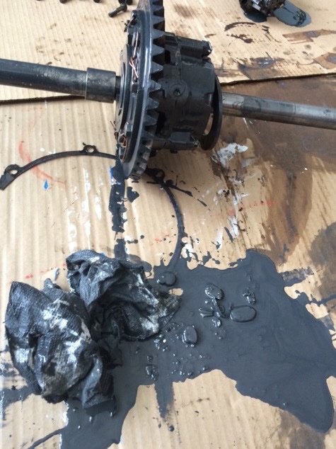

Here's what it looks like when the "babbitt" washers finally fail. The "grey death"
If they really had been babbitt, they probably wouldn't be a problem. They are some odd lead/zinc/antimony/bismuth/heaven knows what alloy injection molded. Like much die-cast "pot metal" items from yesteryear, has an unpredictable "shelf life" and seems to spontaneously disintegrate in time.

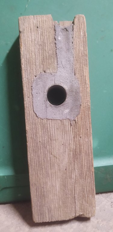

The pic. A friend gave this to me a bunch of years ago, found on his homestead.
11" tall, 2 nail holes on one edge, sprue on top with marks from another 2X4. Must weigh five pounds and hard Babbitt.
