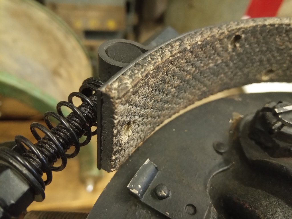

Yesterday I received a set of used Rocky Mountains Bremen for my 1926 Touring. Unfortunately, not everything is complete.
Can someone tell me how long the two operating rods have to be? Can I take the fork heads off the original brake?
Also missing are the two springs that go over the mounting flange and pull the lining away from the drum. What are the dimensions and wire thickness of the spring?
The covering, which is still unused, also unsettles me. What kind of material is this? Does it make sense to use the brakes like this?
I see the new topping at Lang's. This looks completely different than my Rocky's.
thank you for your help

You should be able to contact Bud Williams (the manufacturer)in Temecula, Ca for parts. I think they still advertise in the Vintage Ford.
The clevis's Are 3/8, I believe. Normal/common hardware store clevis's. Check the holes in the arms & equalizer for the pin size. The original parking brake clevis's are 5/16.
No reason to mess with them any way until you start the adjustment puzzle. (your'e in for a treat)
When you have the shoes & equalizer installed, the length of the rods will be obvious.
The linings are of the woven type, Much better than the solid grey stuff that comes on them new today IMO.
I'm sure there are others with better access to a set to give you the spring dimensions. Good luck.

What I see in the pictures, the model A clevises could be sold as a set. Would these be strong enough to drill out the holes to 3/8" to fit the Rocky's?
