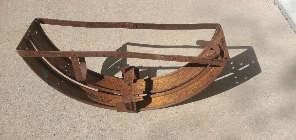

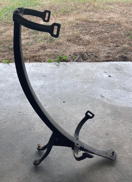

Brought this double spare tire carrier yesterday for $40 for my 1914 touring. Assuming that it is correct because it has a narrower spot for the 3" and wider for 3.5" spare. Are there any brackets I'm missing? On my survivor car, you can see where one used to be attached to the top side of the drivers false door. I'm sure it was a different brand from this one.

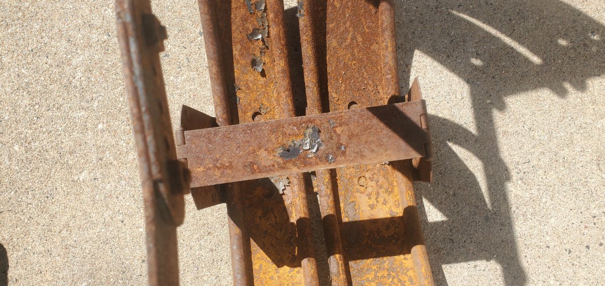

Another shot of the double carrier.

Last shot of the 14 carrier
Re: 1914 spare tire carrier
WOW! Great find. I would think it would have brackets front and rear to support it. There are some holes for them.

All of those were after-market items during those years! So there is a lot of variation in brands, styles, and quality, as well as where and how they were to be mounted.
That looks like a really good one!
A lot of that type had a simple metal belt loop that mounted near the top of the fake door for a leather belt to loop through and around the outside of the tires. Something simple and easily made of of a scrap of strap steel. Others simply used gravity or a belt or metal bracket over the inside of the tire to hold the tires down inside the cradle.

Steve K, your particular spare tire bracket was probably intended to be mounted on the running board. Although bolting the sides directly through the rear body might have also been done. Many rear mount spare tire brackets had metal to extend under the rear tub as part of the bracket mount.
You might be able to mount yours far enough forward between the running board and front fender and not need to move the carbide/acetylene generator. Give it a trial fit and see?

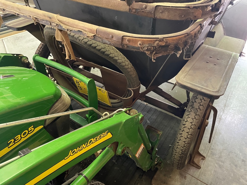

Here is my 14. I actually have the prestolite tank to deal with rather than the generator to make room for the tire carrier. It is a problem too.

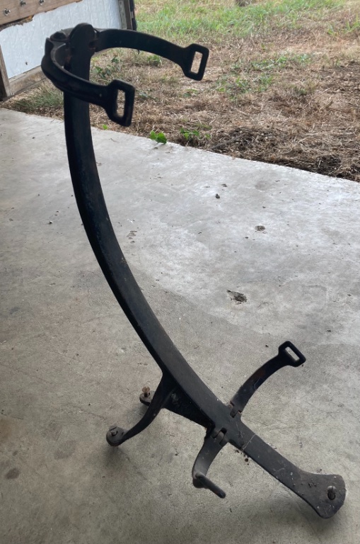

Heres my 1914 runabout cast iron spare tire carrier. Will strap in both sizes. Don’t know if I want to mount it or sell it
