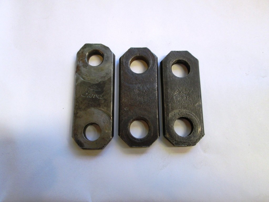

I am not a TT kind of guy, so got a question. How do you tell difference between T3814, front shackles tie bar and TT 1067 brake expander link. Be told look very close to each other. Thanks Dan
Note: 3814 fits car

The expander links I have are 1/2-3/4" LONGER than the shackle plates. They are cut the same and appear to be the same thickness.
Terry

Here's a side by side comparison Dan - TT brake link on left - later T rear in center & later T front on right.
Took me a bit to locate - I have too much stuff !

Thanks looks like I got a pile of nos front shackle links.
