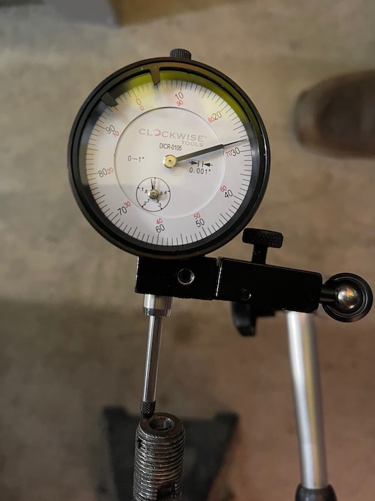

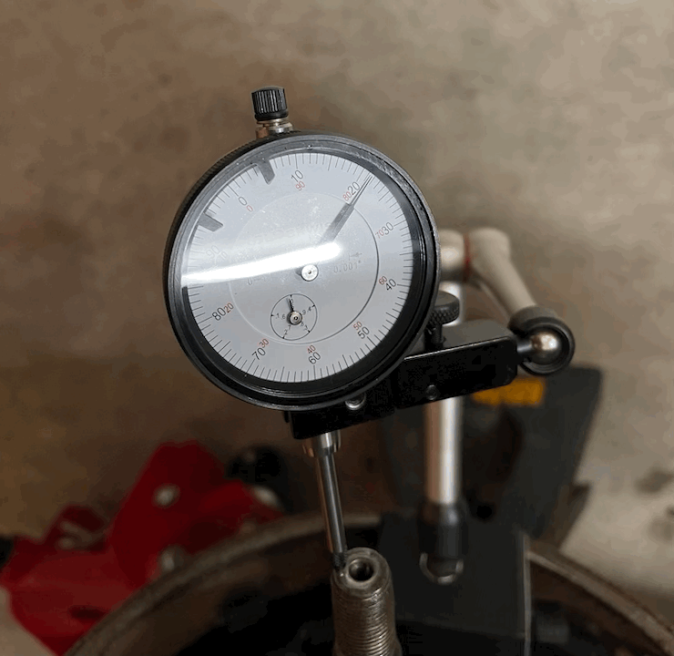

As I was making sure that my rear hubs were not contacting the cap on the axel tube I grabbed the axel and gave it a pull. It moved! But the question was by how much?
I put my dial indicator on and this is what I got
Driver's side was 21 Passenger side was 28

That's not much movement. Probably a combination of axle movement inside the differential and side to side movement of the differential inside the rear end housings. You don't want close fits inside a T rear end. I'd leave well enough alone.
If you're concerned that the rear end was not gone thru, then by all means have at it. You may find a number of issues to be addressed, but the amount of lateral movement you have wouldn't, in itself, bother me.

I agree with Richard..007 in is acceptable

The dimensions of movement given @ .021 & .027 are way off, but not necessarily an indication of something serious. Exactly where the wear is from is a combination of the carrier & between the 2 axles.
What we can conclude, is that the left thrust washer is in tact. If it werent, there would be 3/16 + movement. This is the critical thrust. Without it the ring & pinion mesh is way out & these expensive gears get torn up.
We cant surmise the condition of the right thrust washer since its excess movement is curtailed by the pinion gear. Its possible to go in thru the filler hole with a bore scope to view the right thrust washer.
Does the rear end need a rebuild? Yes. Can you still drive it for a while? Yes. For how long??
Be cognizant of any change in rear axle noise, especially gear noise & park it.
