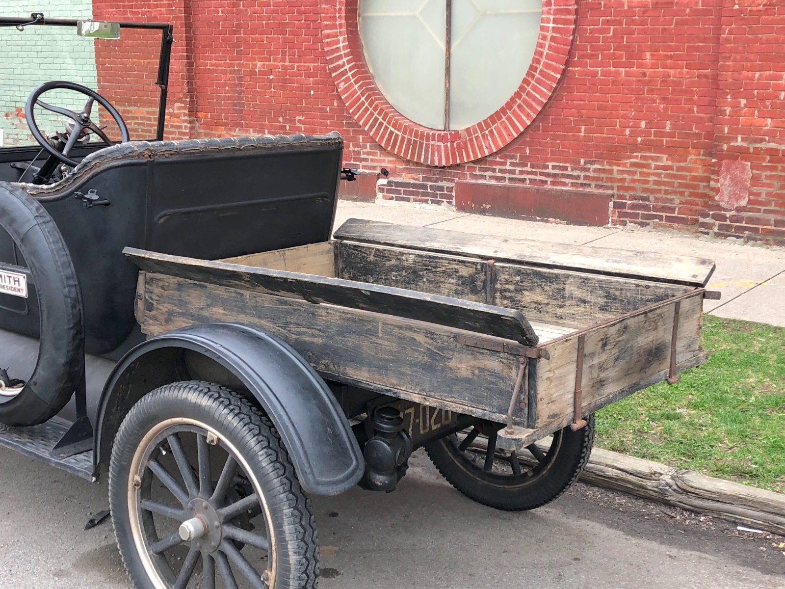

The vintage pickup box I just installed on the ‘23 runabout has some original paint but also lots of bare wood. Am thinking of maintaining it with boiled linseed oil. Wondering if anyone else has used this for sealing original exposed wood on commercial bodies in similar condition.

Looking at the box again, I am thinking that putting a linseed oil (or any material short of a full restoration, which I think is not warranted or desireable on this car) would be a mistake that cannot be undone. It will forever darken the wood, losing the "as-it-sat" look. Additionally, unless many many coats are applied, it will not protect against water (it is not a top finish)...I am certain that lots of people will argue this point, but if some research is done, it will be shown to be an accurate statement.
I vote "no" to an unasked question.
- Posts: 7306
Re: Boiled linseed oil for pickup box
Scott, that's another reason I suggest Penetrol as the treatment. I wish I could access my trailer to show how it has worked for me, but I cannot access it in its storage place. It is a timber pre-treatment before painting,acts as a key to finishes and helps thin finishes being applied to make application easier. It brushes on just like paint, so no rags to self combust. and no extended drying time. What is there not to like?

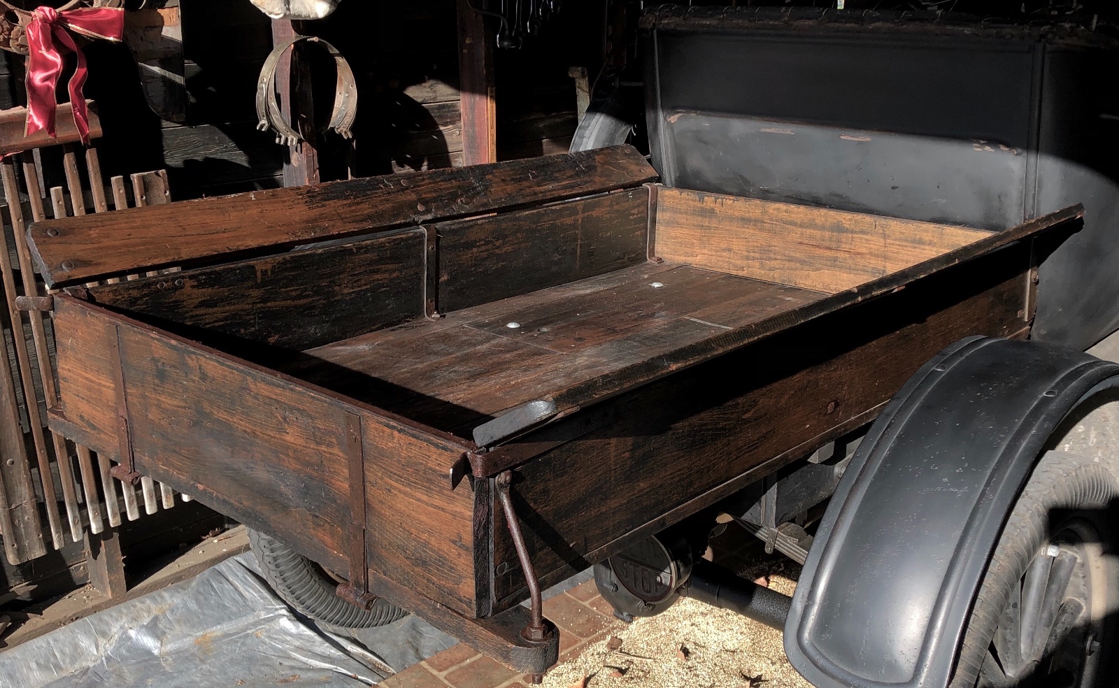

Here is the box after one application of linseed oil / turps / japan drier. I have to take the box off again to shim where the mounting bolts pass so that they don’t pull so hard on the boards. I’ll coat the underside at that time .. though those areas still have most of the original paint.

It's perfect..........you have the right method. Congrats!

That looks good'r hell! Job well done!

I got it! Been waiting. I can actually smell that oil. I like it.
Looks nice Mark.
