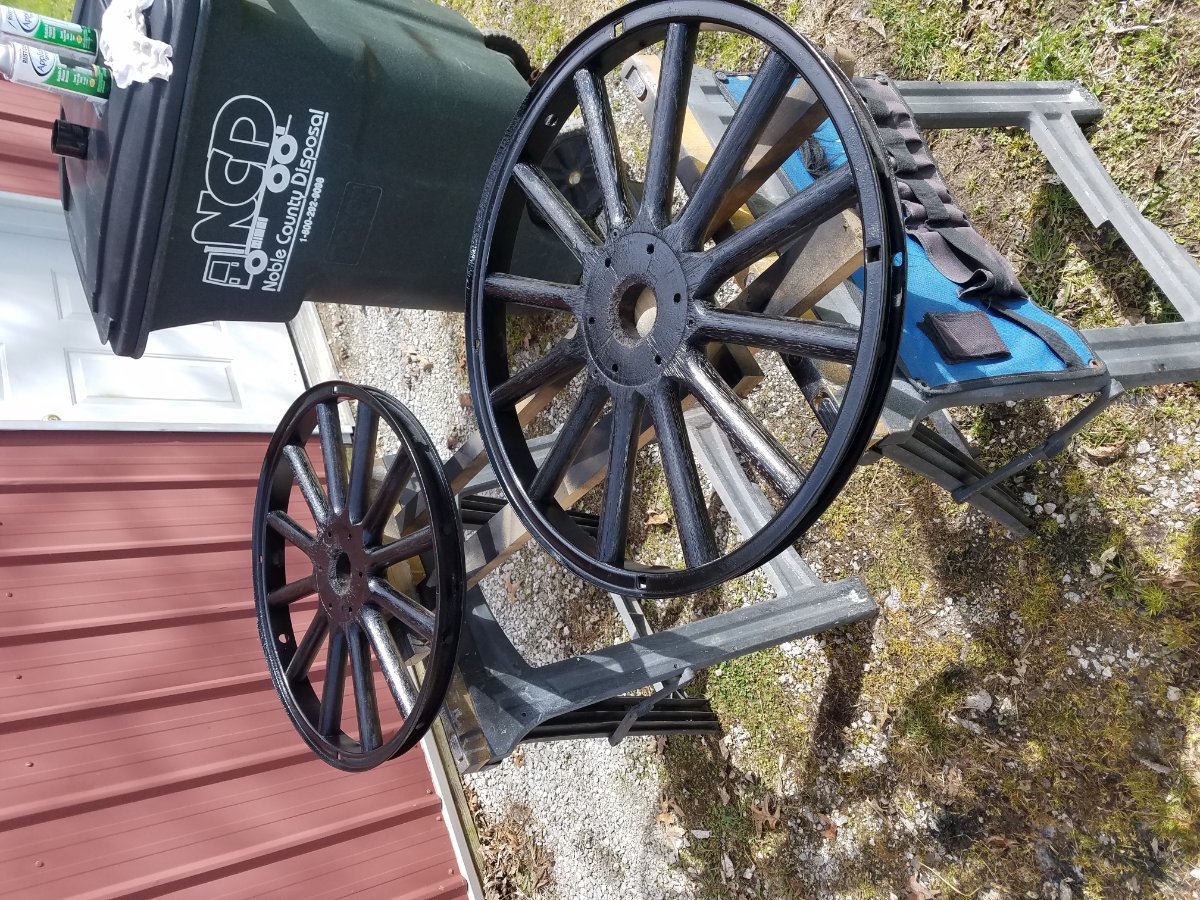

I spent some quality time with my kelsey wheels tonight.
1st with a broken pickle jar for a scraper. Then soda blasted the spokes. After that the sand paper. The one on the left has the spokes sanded. The one on the right is soda blasted.
Broken plate glass works better for scraping but the wife said we needed all the windows in the house. Dont forget the leather gloves if you try this at home!

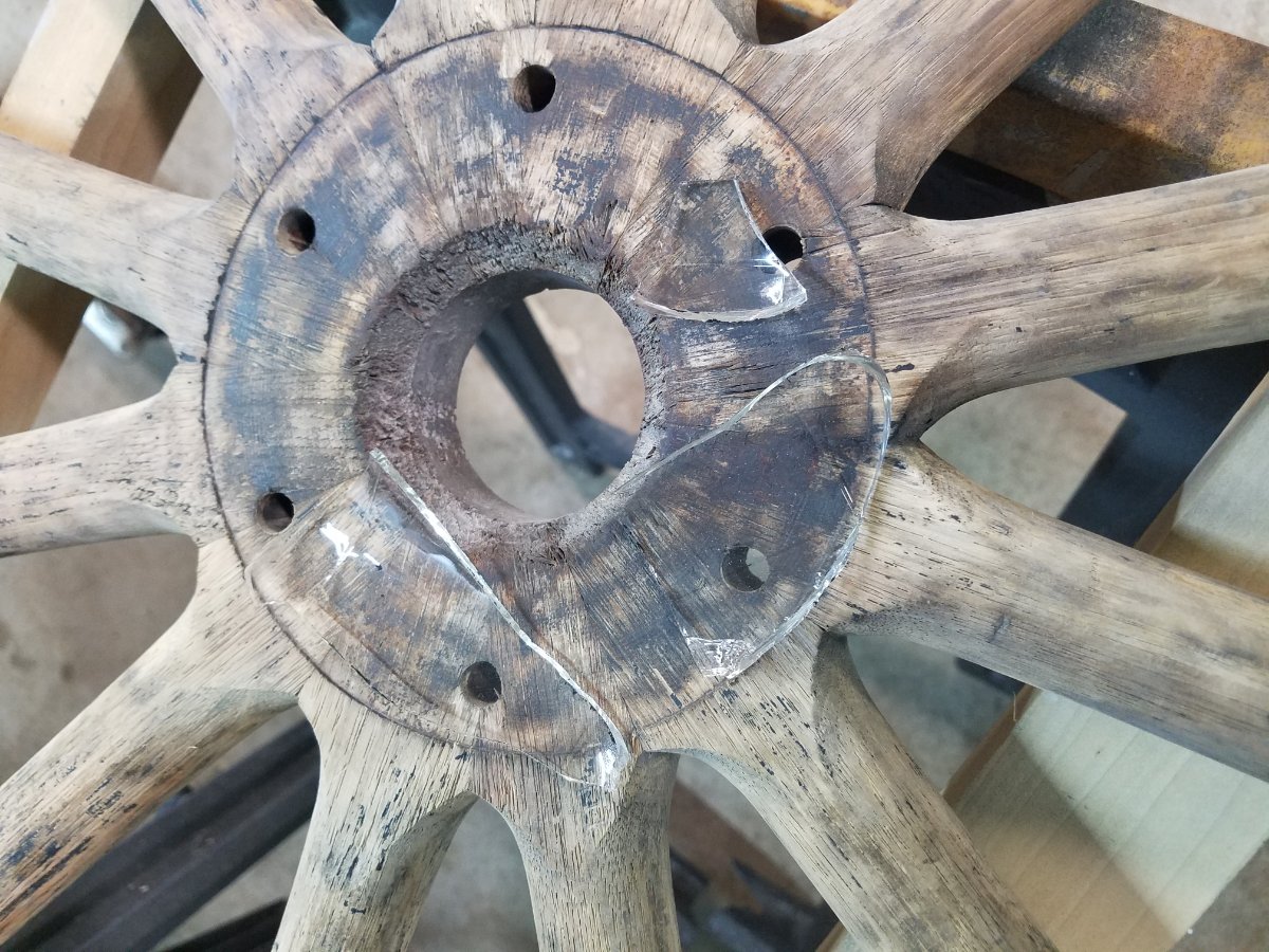

Almost forgot to show what they looked like before

1st coat of paint on.
Hubs are primed and ready for paint. New race and bearings are here. Back ordered one dust seal. :(
