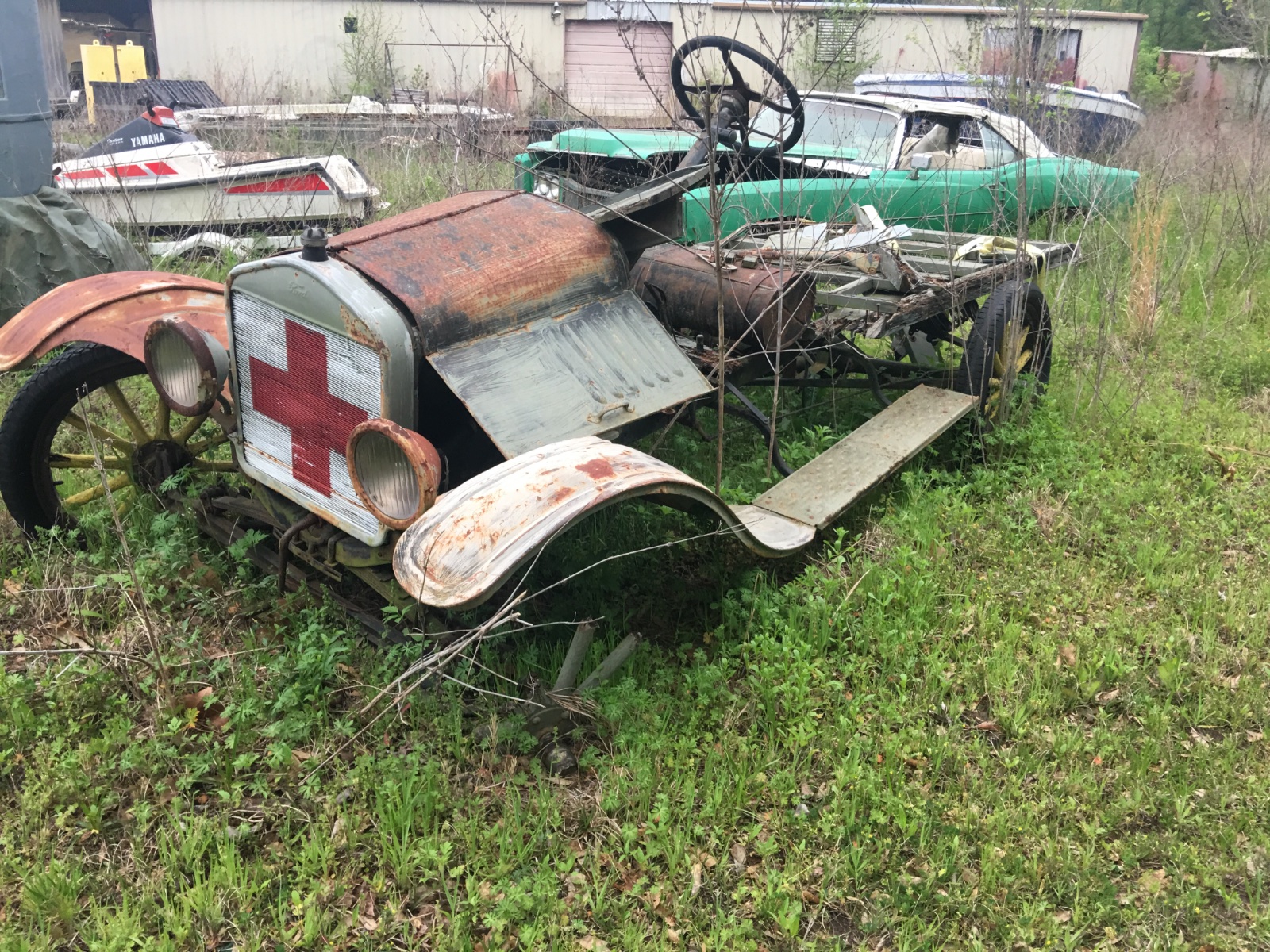

Let me preface this by saying that this is my first bone stock model T. I’m used to hot rods and customs.
I’m going to be replacing one of the front wheels on my 21 T very soon so I can get it on a trailer and get it home. The current wheel is broken and what’s left if sittijgnin the dirt. I need to go by and take a look at it to see what tools I’ll need but I figured I’d ask here and maybe save myself a trip.
I don’t have any Model T specific tools but have about every other tool known to man. Lol. What tools would you guys suggest taking to make swapping the broken wood wheel out to get my t rolling.

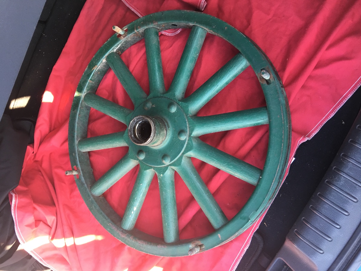

Here is the wheel in question and the replacement wheel. As you can see it won’t roll! Haha

The wheels currently on your "new" T are 23" - the replacement wheel you've posted the photo of appears to be a 21" demountable & looking at the hub, might not be Model T - perhaps Chevrolet ?
And, demountable rim nuts on a car are 5/8" - same as head bolts.

Chevrolet also had 4 lug rims as they will bolt onto a 21" T wheel BUT the tube stem hole is not in the correct place.
