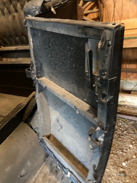

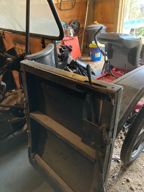

The car pictured has 14 style latches and handles on the rear doors.

I stored this 13 at my cabin in Minnesota. I will be out there today working on deer stands, see if I can get some detail photos of the rear door latches.

These are the door pictures mentioned in the earlier post. A June 18, 1913 car. Both back doors are 13 doors with 14 latches, the front door has the normal handle. In one of the pics you can also see the sill reinforcement. Its my understanding that the 13s were leaving the factory with the reinforcements during the later body builds.
