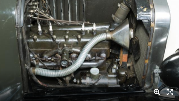

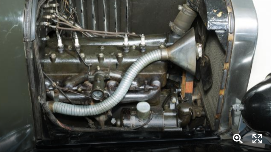

This is a picture of the engine in Henry Ford's personnel car see this link
https://www.thehenryford.org/collection ... =gs-559395

Yes, thank you all for your input. I had viewed the suggested thread many times and studied the drawings, as well as other past threads posted on this website. Once again I ask, should there be a gasket on the plate? I don't see such a gasket on the drawing, but there were remains of one in our carb. Maybe there is one (or two?) in the rebuild/gasket kit? If only one gasket, on which side of the plate does it go?
Because the pictured carb system was not a Holley Vaporizer, but a Simmons, I wasn't sure if the intake on the Holley should be green or black. I have seen photos both ways. True, this car we're working on is no Rosenthal Trophy contender, but we'd like to at least get the colors right.
