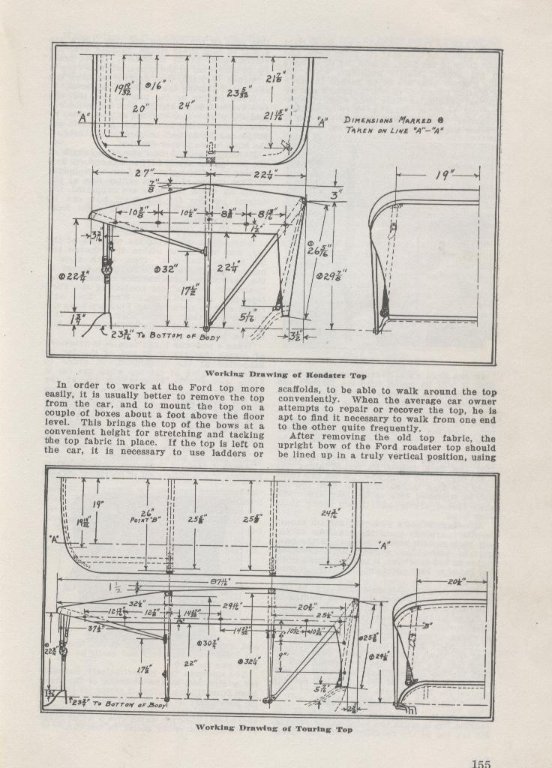

I cannot find a drawing for a 26-27, but this drawing of an earlier model T gives an example of a rear curtain rake. Picture is from a prior posting by unknown party.
- Posts: 8422
Re: 26-7 roadster top rear offset
The '26-27 top frame and cover is not the same as the one shown above. To OP's original question, 3 1/2" close to what my car measures. NOTE: FIRST POSTING!!!!!!!!!!!!!!!!!!

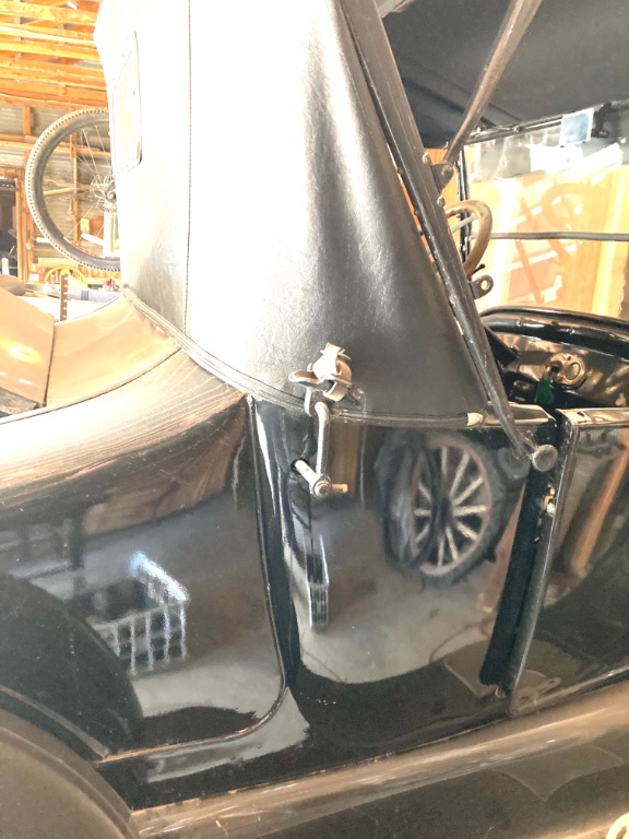

While we’re on the subject of the ‘26-‘27 roadster top, heres another consideration: ... while most of us leave the ‘New and Improved’ top up, some will lower it to the leather covered top saddles. But when this is done your turtledeck access is greatly limited. To solve this I attached the pictured circular metal onto the top saddle bracket with a set screw after welding a 1/2” OD extension onto which the top saddle fastens. This allows for top down + full turtledeck access.
