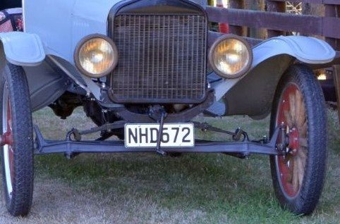

Bracket in use:

The motor mount is different on a correct 16 than Steve shows. Shown is the later motor mount 2 nuts attaching. The 16 has 2 u bolts holding the motor mount & springs.

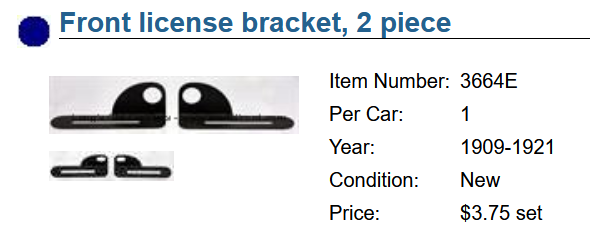

This is what you need. Its designed to use the front spring clip ubolts on each side of the crank. The picture has them resting face down

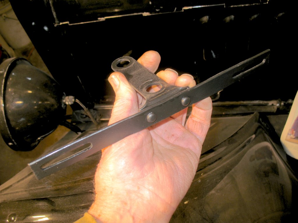

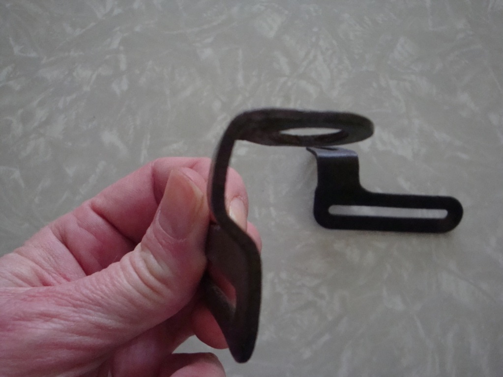

I don't know who originally posted this picture of brackets to mount a license plate. Note: the brackets curve back at the bottom so the crank will clear the plate.

The brackets dont come bent back. As you imply, it might be necessary to do some bending to clear the crank.John Heaman wrote: ↑Tue Oct 18, 2022 6:45 pmI don't know who originally posted this picture of brackets to mount a license plate. Note: the brackets curve back at the bottom so the crank will clear the plate.

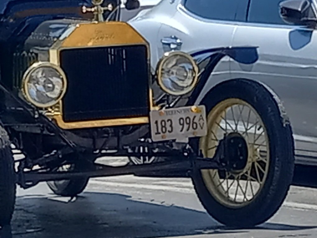

To achieve this look, I used this type of bracket:
I enlarged the first mounting hole and attached the license bracket to the bottom end of the headlight bracket, as so:

The reproduction ones that TRDxB2 (Frank B) shows are too lightweight. I wouldn't trust them. I have seen a few originals and the steel was nearly twice as thick.
