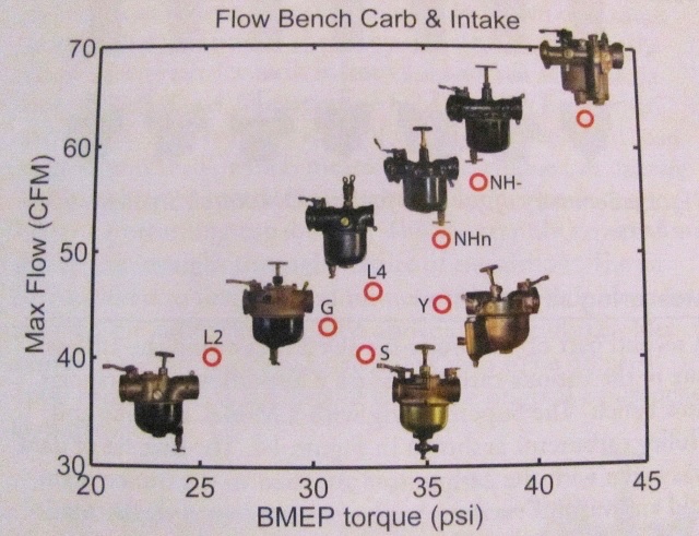

You can stay will any T carb, like the later Holley NH, easy to put into tip top shape. Or go for the Holley NH early one, '19-'20 with the 'straight thru' design. Note the chart with that one, flows best.
And....all these T carbs can be made to 'a fix mixture set'.......just tighten down completely on the lock screw, no way the needle valve can migrate!

Dan; If you look close, the top carb on your CFM chart is a Stromberg OF. It's also the only one on the chart that is truly a "set and forget" as every Holley or Kingston T carb is a kinda poor compromise for fine tuning for all speed and load conditions with just one setting. There are others that would be "period correct" and flow even better than the OF and they are the Stromberg RF, the Rayfield UF, the Wheeler Schebler FAX8 and best of all the U&J . I have nothing against running a stock factory carb, but if one wants efficiency (a much better air/fuel mix for all conditions) a smoother running motor, less carbon build-up, and better fuel mileage with more power, any of the mentioned carbs will fit the bill. The late Stan Howe posted tons of information/comments on these carbs and he truly knew what he was talking about. Funny, but I must have talked to two dozen T guys at Hershey about carbs and all but one was very content with their NH and most had never even heard of the carbs I mentioned.

A NH is capable of 55 + on a full body, stock T. See Montana 500 race specs. They AVERAGE 55-58 in a run. (Thats average over 500 miles, including start stop speeds & city speed limits.) Flat & down hill 60-70+.Mark Gregush wrote: ↑Fri Oct 21, 2022 2:46 pm"all but one was very content with their NH" There are a lot of people that have never gone past the carb on their cars, so are content with what is on it now, not knowing any difference when all they are doing is putting around the hood or going for ice cream.![]()
My observation here is many wouldnt think of going over 45 unless out of control down hill. They couldnt due to under par chassis, engines & ignition systems.
a NH is clearly a capable carb. for more than ice cream runs.
I dont have the experience, first hand with Strombergs to make claims of their adequacy @ higher speeds, but, I do know people that are very happy with the performance characteristics thru the speed range to 55-60.
