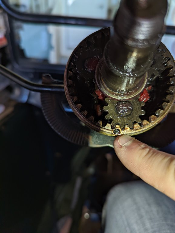

Steering gear box
Post by JBog » Sat Oct 22, 2022 7:27 pm
What is this hole for? It has a pin in it for some reason.

Post by Scott_Conger » Sat Oct 22, 2022 7:29 pm
that's where the little screw that is always missing from the cover, fits into to keep the cover from unscrewing

Re: Steering gear box
Post by Moxie26 » Sat Oct 22, 2022 7:32 pm
Top center of that steering box , is there a drilled hole? Normally that drilled hole would be threaded to accompany the steering box cover set screw to anchor the cover after tightening. Could be with yours, that the steering box was installed 180°off center...., And your set screw was broken off in the housing.
Post by JBog » Sat Oct 22, 2022 7:50 pm
Interesting! It does have a set screw at the top that hold the cap on.
Post by RajoRacer » Sat Oct 22, 2022 8:36 pm
Usual repair to tighten up slop in top cover.
