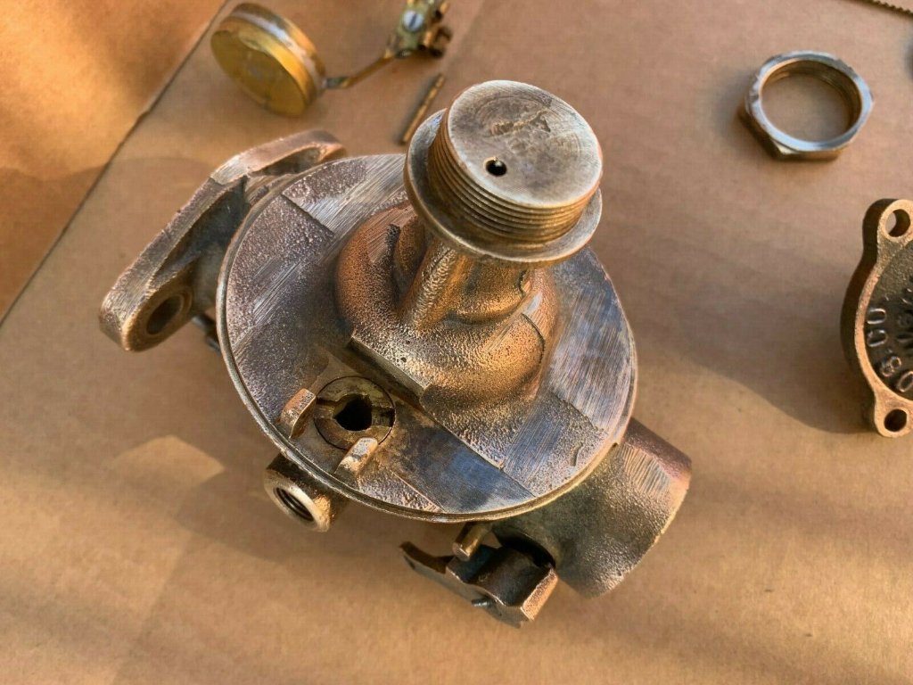

When complete and fully installed, what would cause gas to leak from the hole at the bottom of the stem?
- Posts: 6554
Re: Holley G leaking
for starters, that float is the wrong one...buoyancy and leverage are all wrong
the cause of the "leak" is the fact that due to insufficient lift the float valve has failed to fully seat and you are not leaking, you are overflowing
Scott. Thanks for your input. I failed to mention that the float that I installed is new from Lang's. The picture shown is when I disassembled the G prior to rebuilding. I think I have the float lever setting incorrectly. I set it at 5/16" body flange to float top. Perhaps increasing to 3/8" might prevent the problem? Do you think 3/8" is good or a larger distance?

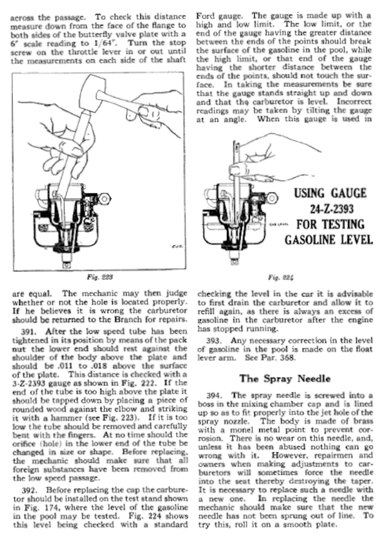

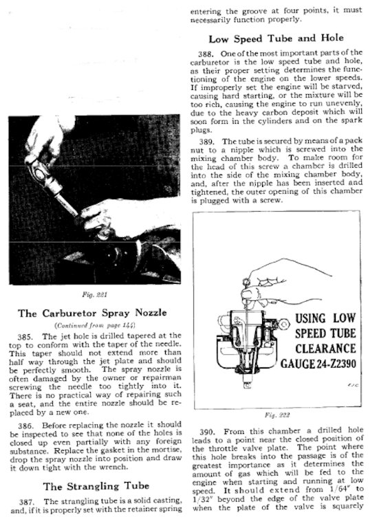

- Posts: 7310
A bit fuzzy but readable: Holley G how-to from a 1920 service bulletin.
