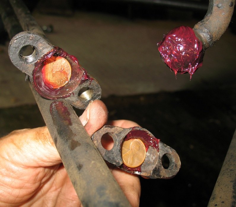

I would guess that the placement of the shims would be to protect the part that is the most to find a replacement for, cost too. Of course the APCO style spring loaded are not on the drag link . Prior discussion https://www.mtfca.com/discus/messages/5 ... 1447325806
Then this says it all

Today's pennies, like so much else, are debased. They aren't worth a red cent. They are not copper. They are some other metal, probably zinc, with a very thin copper plating. If you want an actual penny, you'll have to find an old one. WARNING! DO NOT EAT PENNIES!

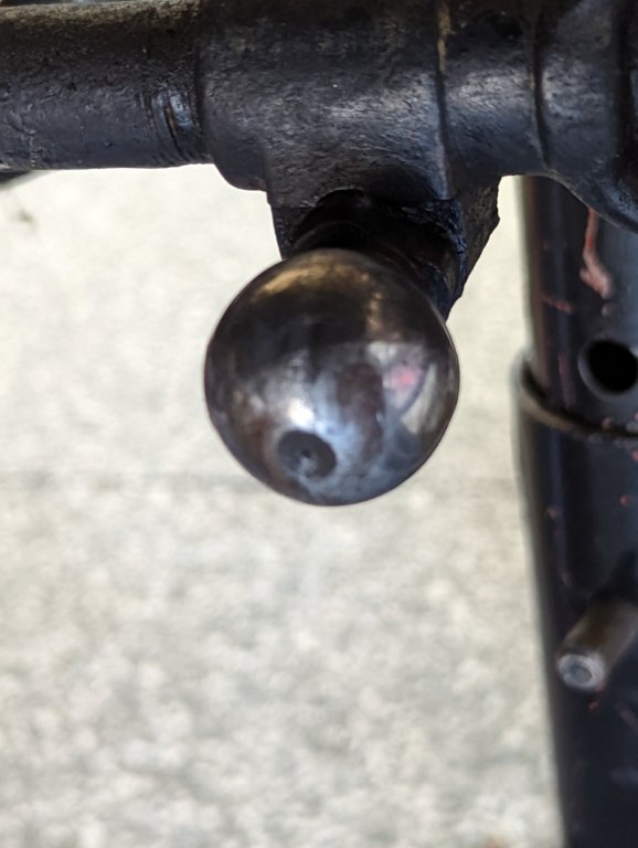

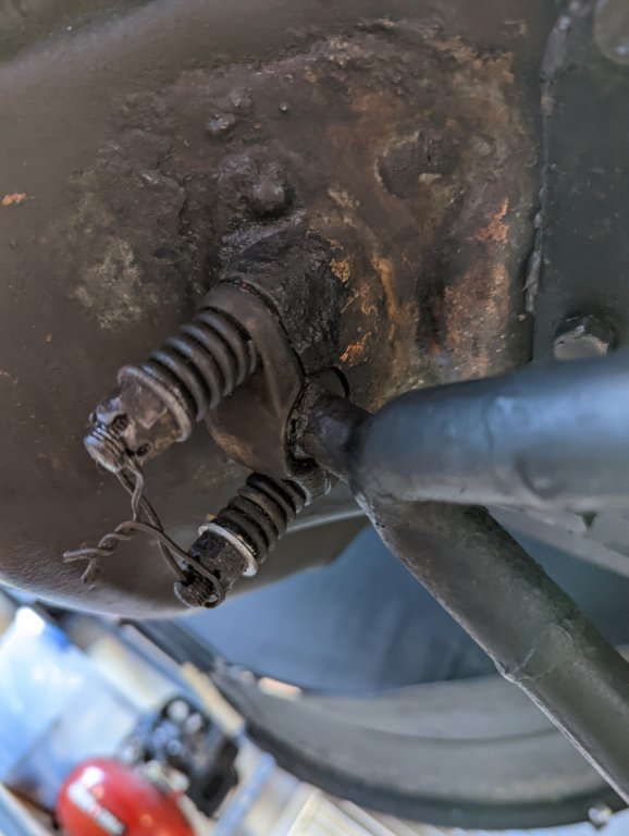

JBog
Topic author - Posts: 298
- First Name: Jason
- Last Name: Bogstie
- Location: Cheyenne, WY
Re: Front wishbone and drag link shims
Most of my slop is in there.

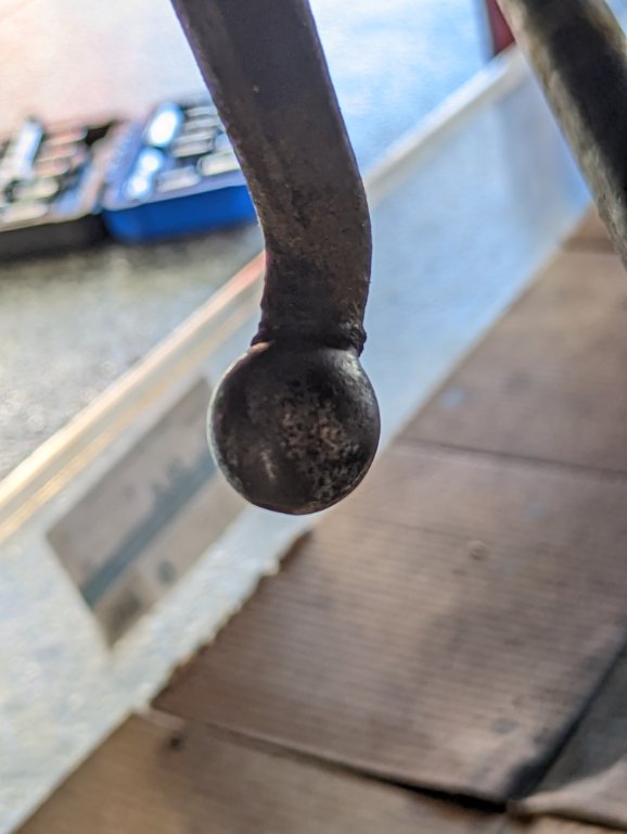

JBog
- First Name: Jason
These are the balls.
- Posts: 5087
No. no pennies, leather, thin steel, fairy dust, or mommy spit. No shims.JBog wrote: ↑Fri Oct 21, 2022 12:45 pmSo do you want all copper pennies?Steve Jelf wrote: ↑Fri Oct 21, 2022 12:21 pmPennies minted since 1982 are too soft (mostly zinc). So is gasket paper. I haven't tried leather. Replacement with a better part is best.
You claimed the balls were round, so a little cap filing is the prescribed fix. Easy, quick & permanent.
Your balls do not look PERFECTLY round in the pix. Optical dillusion?. The way to determine round, is to use a dial caliper all over multiple locations around each ball.
Question in advance for whats coming. Do you have the capability, or a friend to weld a worn ball up & regrind back round?

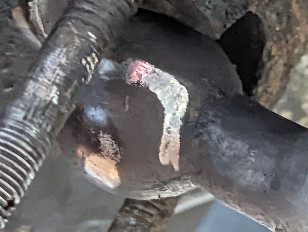

- Posts: 5087
- Posts: 5087
This cap looks to be well worn. If the ball is reasonably round, a new cap should be had.
Due to the minimal movement of the ball, I believe there is more leeway in the allowable out of roundness. Any high point tits would need to be smoothed down.

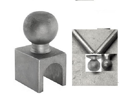

- Posts: 6534
I have weld on balls for saleSteve Jelf wrote: ↑Fri Oct 21, 2022 10:26 pmDo you have the capability, or a friend to weld a worn ball up & regrind back round?
I could weld up a ball easily enough, but how do you do the grinding part?
- Attachments
- wishbone ball.jpg (50.35 KiB) Viewed 3322 times
- Posts: 5087
A 90 degree air die grinder with 3" sanding disks & a dial caliper. Take down & smooth the high spots until round & to size all over.Steve Jelf wrote: ↑Fri Oct 21, 2022 10:26 pmDo you have the capability, or a friend to weld a worn ball up & regrind back round?
Start with a course disk(40 grit) finish with about 120.
The weld on ball looks like another good option.
