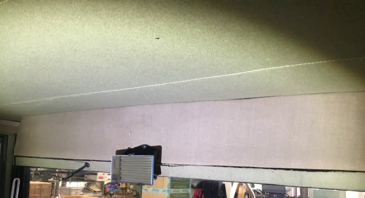

In addition to the measurements, I would like a photo to see if there is the round chord trim between the header the headliner like in the attached two photos.
I would also like a photo of the area above the top of the door, to see if there is a piece if windlace. In the second photo, you can see a black piece of windlace between the fabric and the metal.

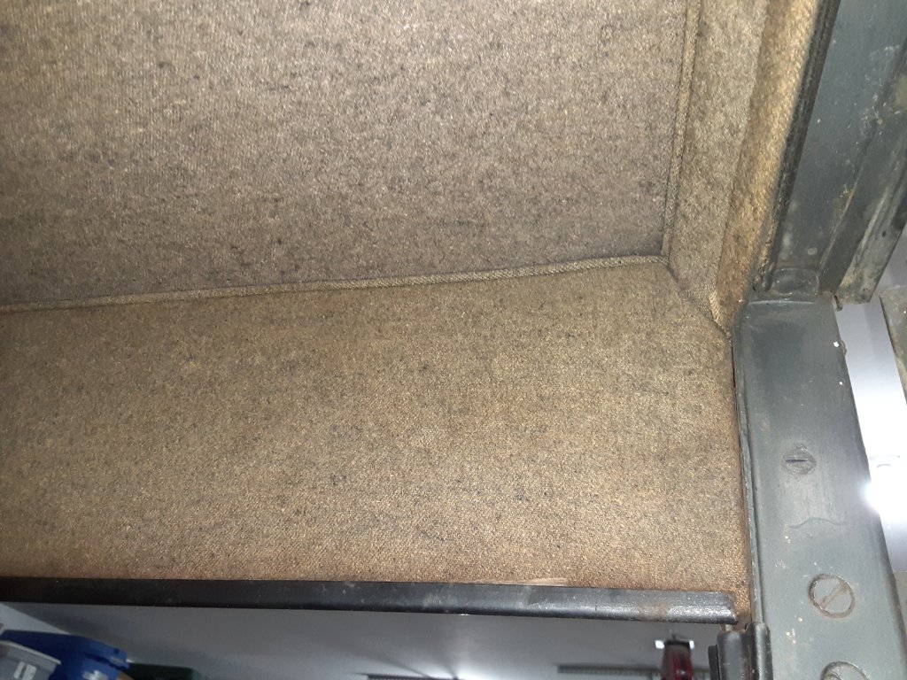

I measured my 1927 Coupe and took some pictures. Looks like about 5.75 inches from the top to the steel edge at the bottom on the side and about 6.1 inches from the top in the middle of the window. Hopefully this helps.

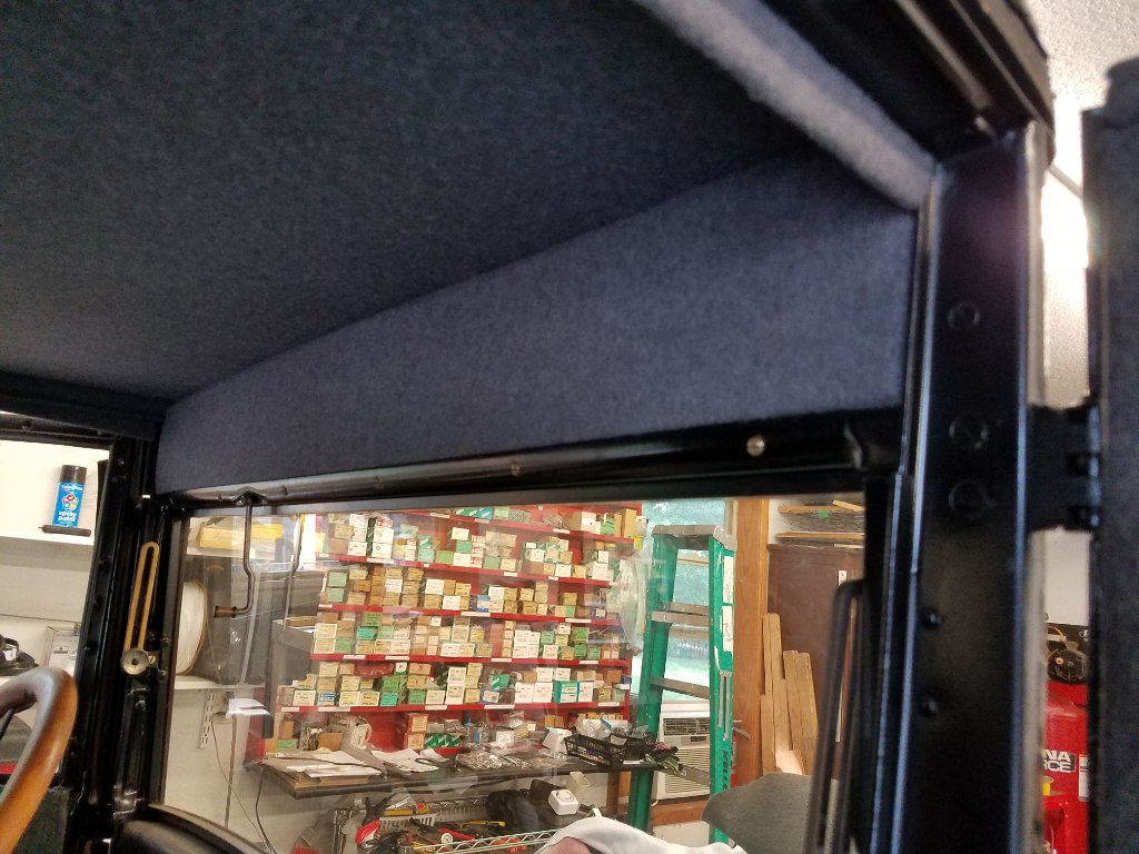

Hi. This can be a tricky part on restorations because it varies a bit on that car. The hight in the center can be between 5" to 6.5". Most are around 5 3/8". I leave extra material on my panels to accommodate for variances like this. I have come across 2 Coupes that had Tudor headers that were 1/2" larger at the bottom. The panel gets 5/8" narrower on the ends before the cut out on the top of the ends. The 2 lower mirror holes start 1/4" to 3/4" up from the bottom. The center hole is 3/4" higher than the other 2 holes. The piping that separates the upper panels from the headliner is only supposed to go on the sides and rear of the car. It does NOT go above the header on 26 and 27 Coupes. It is supposed to be out of the same wool broadcloth that the headliner and upper panels are made out. It is supposed to have a brown paper core. 26 & 27 Coupes had Black Model T Grain Leatherette windlace in the front and rear of the door. They were both different sizes.There are upper rail panels that go above the doors that have fabric on both sides. I have posted a picture for you. Also, the fabric in that car is supposed to be grey.

Here is a picture of 1 before I put in the upholstery. The measurement varies on those 26/27 Coupes though.

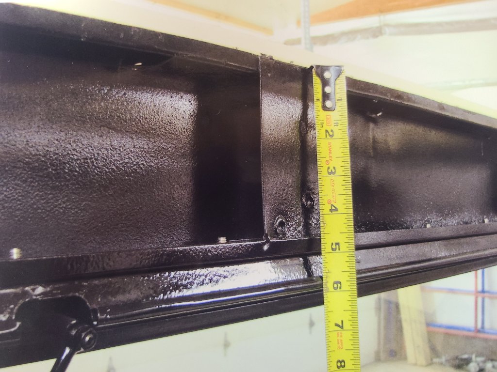

The measurement from the center of the bottom screw hole on the mirror to the bottom of the steel edge is 1.75 inches on my 1927 coupe.
