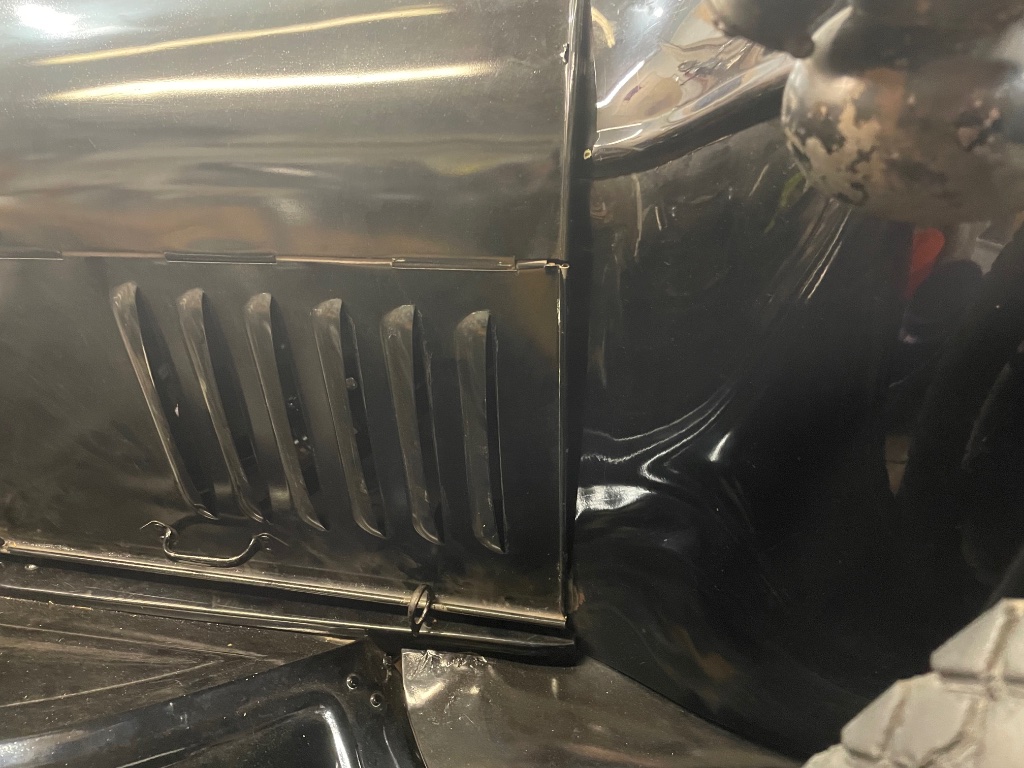

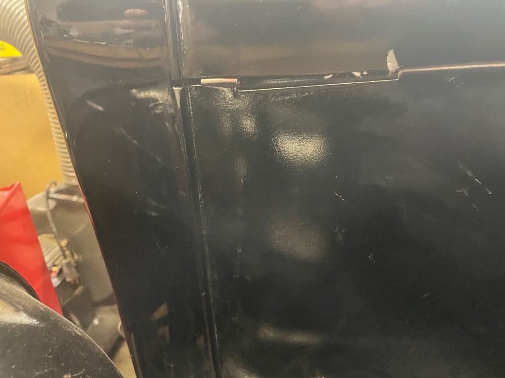

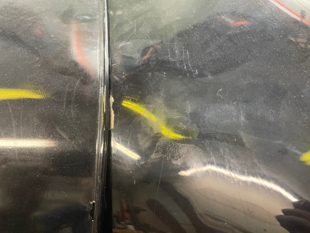

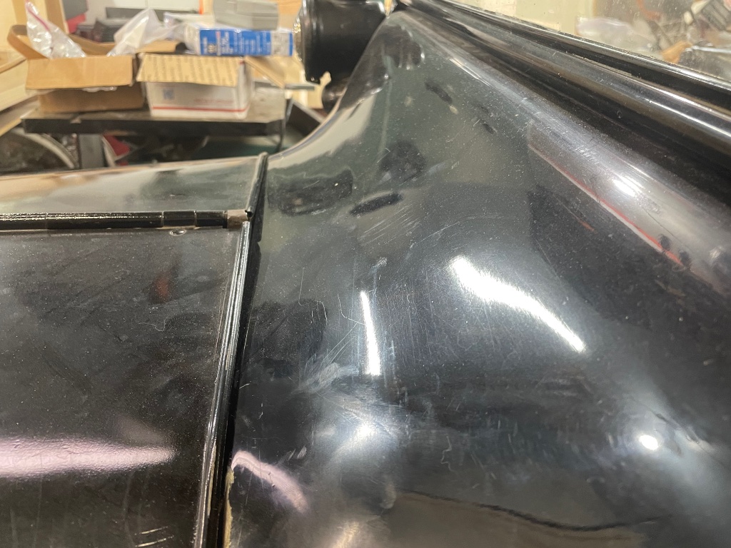

Re: A good(?) hood question (Pictures Added)

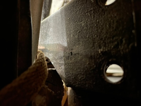

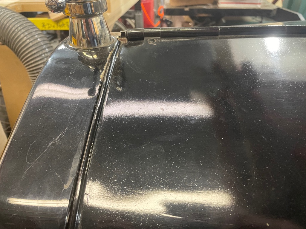

Here are some pictures of the hood gaps and the chipping.
- Posts: 8605
Is there any chance the hood is the wrong one? Short of that, either the body or the radiator, or both, must be out of place on the frame. ( ? Unless there are differences in frame mounting hole locations for body or radiator from year to year). A sagged frame would close the gaps at the top, but open them at the bottom. Yours look too tight, top and bottom.

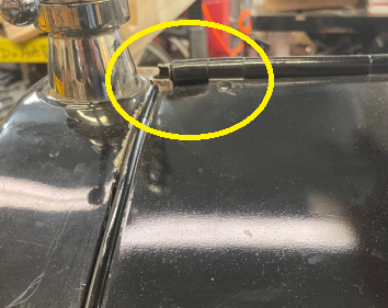

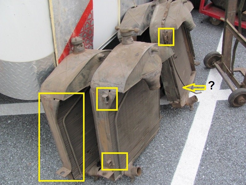

What's going on here?
- Attachments
- hoodbb.png (164.09 KiB) Viewed 4833 times

Anything is possible as far as the hood is concerned. I don’t know enough about the variations to know if there are differences in length. I do have a 26 hood off of a Canadian car in the shed that I can compare, but that is my only option.
The mounts for the radiator and frame look standard to me. The steering column firewall to lower bracket fit is correct, so I think the body position is at least approximately correct. The wood firewall has been replaced with a metal one, but that was common when the wood ones rotted out. And, to the best of my knowledge it it did not result in a change in the position of the steering column.
I would think that if the frame is sagged, it would be tight at the top.
I am not sure what is going on in the circled area.
- Posts: 7243
The circle reveals a little recognised problem with hood fitting. Original hoods have a downward bend adjacent to the centre hinge. Without that bend, as the hood is closed, the centre hinge is lifted out of the receiver on the shell, affecting the hood fit. The new replacement hoods from Rootlieb are of excellent quality, but you must make those bends when fitting the hood.

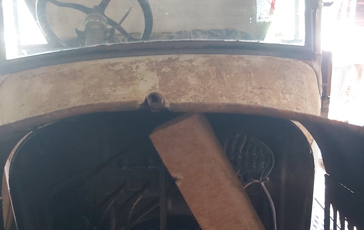

Looks like a metal firewall in the picture. Do the hood sides come down to meet the hood clasps, or is the hood short? Late 1922 's had a higher cowl and radiator, and a metal firewall instead of wood.
- Posts: 5536
That is a low type cowl and hood is correct for that application. The metal firewall was introduced in 1923 on the low radiator cars and used as a replacement after that for wood firewalls 1917 on.
The high cowls started in late 1924 with introduction of the 1924 models.

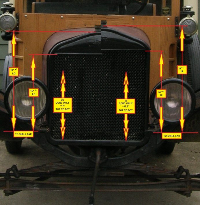

- Posts: 6573

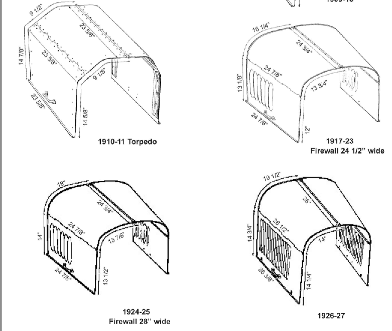

Past discussions about hood fitting mostly have issues with the vertical sides not aligning properly & caused by frame issues. Your pictures show a nice fit on the vertical sides of the hood. As noted one cause of the misfit of the hood rod in the receiver on the radiator might be resolved by a bend in the hood rod. I am also wondering if the radiator shell was moved up a bit would that also resolve the issue. The fitting of the shell around the filler neck looks a bit tight too. So since the car is a "bitsa" it would help to identify the parts with pictures and measurements
- Attachments
- 349379.jpg (66.89 KiB) Viewed 4493 times

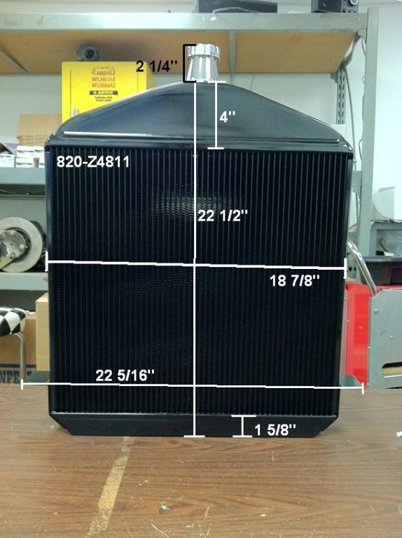

I probably should have mentioned earlier that the radiator is a new one. Not sure who made it, but it is possible that it is the heart of the issue. As I mentioned before, I plan to remove the radiator over the winter, so that should become clear.
The frame measurement method sounds good.

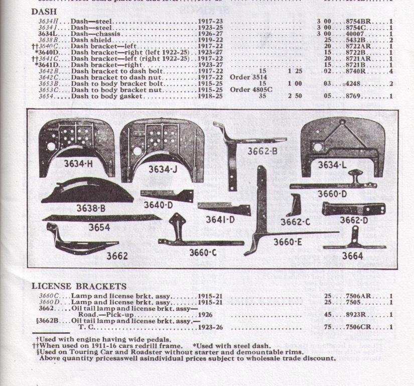

- Posts: 6573
The above are more shell measurements these are the radiator measurementsReno Speedster wrote: ↑Wed Oct 26, 2022 12:24 pmGood points folks. The car runs and drives fine. I agree that the radiator and body are too close together. I will check the hood measurements against the measurements sent.
1917-23

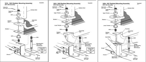

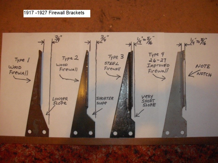

I did some checking and found that the bolts are missing from the firewall mounting brackets, but the holes between the frame and brackets are perfectly aligned. This would appear to indicate the body is properly located. Unless, there are different brackets for the wood and metal firewalls.
- Posts: 5570
Yes there is ! Wooden brackets have a considerable set-back compared to the steel dash counterparts.

Well, that’s interesting. I never would have thought of checking that if the bolts were in place.
Snyder’s lists two types, the 23-27 ones look like they would place the body back 1/4-3/8 of an inch, which would fix my issue. The other body mounts have slots that would allow the body to slide back that much. My only concern would be fitting the steering column to the firewall.
Snyder’s claims that the earlier brackets can be used on both wood and steel firewalls, which I think would be an issue.

So, are the brackets for the low steel firewall the same as the high radiator cars? I have a set of 26 ones on hand somewhere.
I am still concerned about how moving the body back a fraction of an inch will be possible without having an issue with the column mount.
I will measure the hood panels. Honestly, the length thing is of much more concern.
Last edited by Reno Speedster on Fri Oct 28, 2022 8:19 pm, edited 1 time in total.
- Posts: 7243
I can see no reason why the brackets for a low steel firewall should be different to the high firewall. The difference is required to compensate for the 3/4" thick low wooden firewall.. The vertical face on wood firewall brackets is set well forward, while the bolt holes in the frame are in the same place

Reno Speedster wrote: ↑Fri Oct 28, 2022 5:24 pmWell, that’s interesting. I never would have thought of checking that if the bolts were in place.

Great information. Thanks. Here is a shot of the lower part of one of my brackets from under the car. It looks like type 2 wood firewall bracket to me. You can see the holes in the bracket and frame line up pretty well. Don’t know why the bolts were not installed. For some reason the picture is sideways. I have posted a want to buy for a set of the correct ones in the classifieds.
Last edited by Reno Speedster on Fri Oct 28, 2022 8:43 pm, edited 1 time in total.
- Posts: 6573
What you should have and what you have are 2 different things. The firewall brackets depend on the firewall be wood or steel - & then year to be correct. It would hurt to take a picture of the firewall driver side. I wouldn't proceed to solve any issues until you bolt the brackets to the frame not have them could cause all kinds of unwanted movement while driving

Winter has come to Alaska so it’s not getting driven till spring. I am looking for the correct ones and I will get it sorted out. I am also rebuilding the wheels over the winter.
Last edited by Reno Speedster on Fri Oct 28, 2022 8:54 pm, edited 1 time in total.
- Posts: 6573
I see your already looking for type 3. type 4 will work an the earlier steel firewalls but 3 will not work on '26-27. the notch is needed to clear a support bead in the firewallReno Speedster wrote: ↑Fri Oct 28, 2022 8:45 pmWinter has come to Alaska so it’s not getting driven till spring. I am looking for the correct ones and I will get it sorted out.
Reno Speedster
Topic author - Posts: 638
- First Name: Morgan
- Last Name: Blanchard
- Location: Anchorage, Alaska
It’s a 1922 car with a replacement steel firewall so the Type 3 should be correct.
